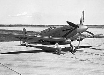

Notice the direction the propellors on these two aircraft are designed to turn. The left is British; the right is American:
View attachment 82085View attachment 82086
One must be be aware of that difference as it causes different flight characteristics, particularly during takeoff and descent.
My deceased father-in-law flew P51s and Spitfires interchangeably in 1944 and 1945. He remarked that he had to have a little talk with himself about which way the P-factor was going to pull the nose of the airplane prior to each take off...
The reason is probably like I mentioned, "it worked." The most common exception is in twin-engine aircraft in which one of the engines may be counter-rotated relative to the other. The American P-38 is one of the more famous/notorious examples of that.
