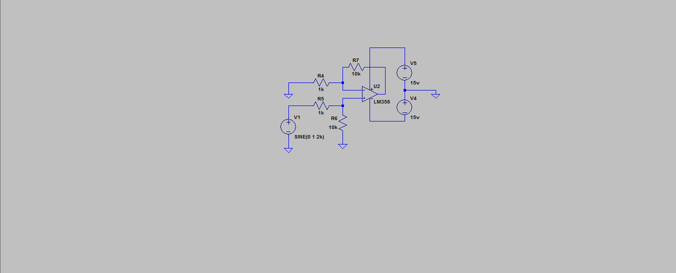

The latest schematic shows a low power LM358, not a 741 opamp. The latest frequency is shown as 2kHz which might not be possible with an LM358 since it has slew rate limiting when its output is trying to be 20Vp-p.
That output should be obtainable, but how do you know it is saturating? Maybe the current mirrors can not handle it?
When you have a problem like this you have to go through each stage one by one and find out what stage is causing it.
I totally agree with you the output should be obtainable with 1v. I didn't still test input of less than 1v . with 1v input I got 0.5v at the output of one current mirror and almost 0.3v at the output of another current mirror. The output of both current mirrors were supposed to be 1v (when resistors at the output of current mirror and resistors at the output of first buffer were 10k). It's possible current mirrors can't handle it which is very strange to me. why? when the output of current mirrors aren't right the very last output voltage wouldn't be correct. this time I couldn't see the voltage of output because of some problems with my solderless breadboard. but I 'm sure about the voltages of current mirrors which don't work ok.
In general with R4= R5= 1k(resistors at the output of current mirrors) and R2=R3=10k (resistors at the output of first buffers) I got results as they should be. I just wanted to change R4 and R5 to 10k to get a better gain. With these changes I have a gain of 10 in LTspice and it's very strange to me why can't I have almost same result in real life? I think I have to switch from solderless breadboard to PCB because most of my problem are because of my breadboard and jump wires I have to spend so much time to get this circuit working.
On a separate plug board, try testing the 741 to see that it can get up to 10v peak on the output with a gain of 10 and 1v peak on the input. It's easy enough to wire this up with a couple resistors. Test that and see what results you get. You might also test all the 741 packages you have to make sure they all work ok.
I did this and had a gain of 10 from the below circuit. I guess 741 works ok my problem might be current mirrors.

1) Your transistors are not matched.
2) Your transistors have different temperatures.
3) Your resistors are not identical.
4) A solderless breadboard has intermittent contacts and has the resistance of its tangled connecting wires.
When you change the resistance in the emitter circuit of a transistor then its Vbe changes and its voltage gain changes a lot.
An IC is made on a single wafer so the transistors are matched very well and are very close together so their temperatures are identical. Their connecting wires are extremely short with extremely low resistance.
Frequently transistors and resistors on an IC are laser-trimmed so that their specs are perfectly identical.

Eh? Mismatching the input resistors (10k) by 10% results in a ~100 dB change in the common mode gain at low frequencies !!
What do you mean? what problem?
Another problem such as like we talked about, the connections on the plug board not being very good.
A mismatch in only one of the input resistors by 1% would cause a CMRR of 46db, which is less than what the data sheets says for most of the op amps we've looked at so far. That means we would not be measuring the CMRR of the op amp, we'd be measuring the CMRR caused by the resistors mostly. And that's with a perfect op amp. So we'd turn a perfect op amp into an op amp with CMRR only 46db just by changing one resistor. You can see why this is so important.
If you want to match sure the resistors are matched then get some 0.1 percent resistors or else if you have a bunch of resistors of the same value you can go through them and match them using a good Ohm Meter or a voltage divider. Find at least two sets of two that are very very close in value.
For your convenience, here is the transfer function for the single op amp set up as differential amplifier with a finite open loop gain Aol:
Vout=(Aol*(Va*R2*R4-Vb*R2*R3+Va*R2*R3-Vb*R1*R3))/((R2+R1)*(Aol*R4+R4+R3))
and here is the same with infinite open loop gain (for other theoretical purposes):
Vout=(Va*R2*R4-Vb*R2*R3+Va*R2*R3-Vb*R1*R3)/((R2+R1)*R4)

I changed them by 1% not 10.
Even that will certainly change the CM gain. LTspice shows a CM gain increase at 100Hz of ~85 dB when the input resistors are mismatched by only 0.1%. In real life, matching all discrete gain-affecting components to better than 0.1% will be very difficult.
