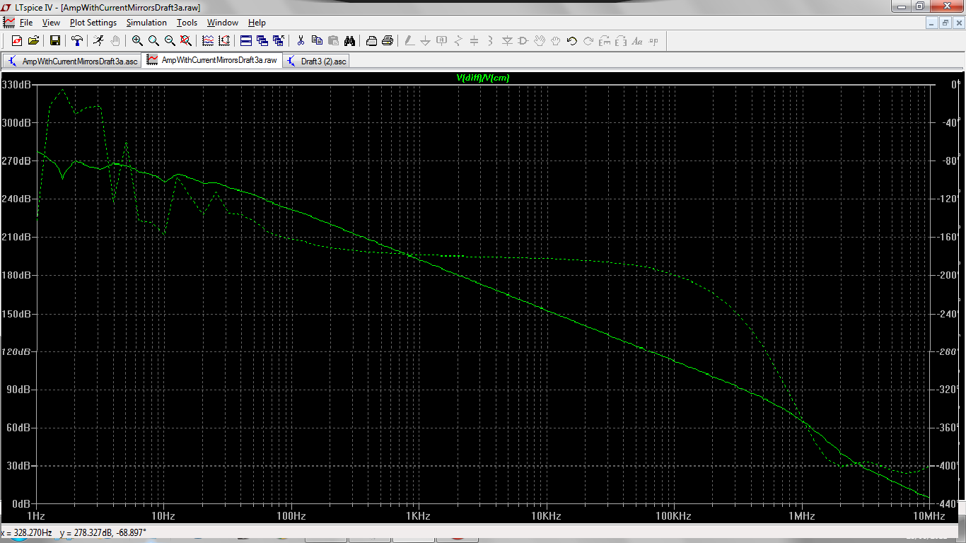

Below picture is the CMRR of circuit in LTspice. The dotted line shows something. what's that?
(ignore)
Phase :-)

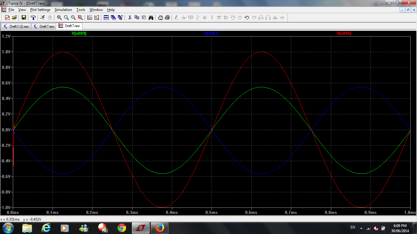

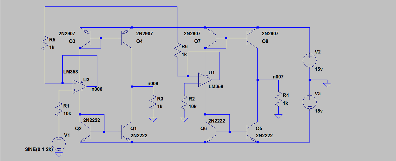

In below picture the voltage nodes of 009 and 007 are 0.5v instead of 1v. I simulated this circuit with LM358 and LT1001 op amps. why are they 0.5v?
