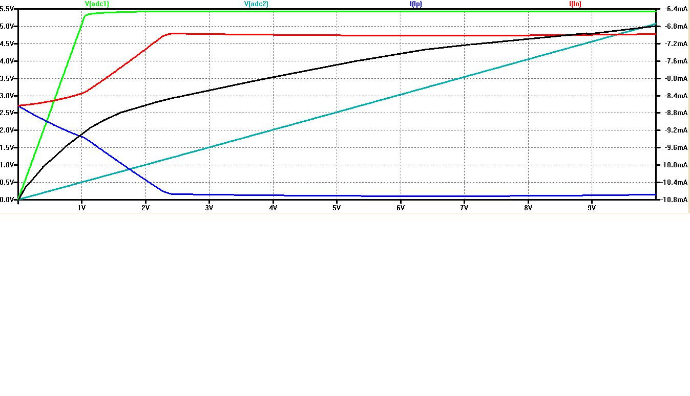

Question, do you want the 1mV thru 10V AC to be linear over the compression range required, ie: 0mVac = 0Vdc thru 10Vac = 5Vdc...??
Hi Eric,
Alec-t asked if it would be possible to simply use a POT immediately after the COIL around the first Opamp, then set the range between the two different circuits (1mv-1 and 1-10) each time.
In this early question of yours, you ask if I want linear? I was wondering if there is a way of adding components that give a none linear line, as my black line on your Graph (attached).
This would be a luxury, failing this, I'm more than happy with your original design.
Cheers.
