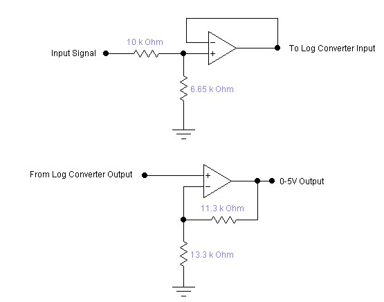

Here are some buffer circuits to use with the AD8310 log circuit.
The input op amp attenuates the 10Vpp to the 4Vpp maximum input of the AD8310 and drives the relatively low input impedance of the AD8310.
The output op amp provides gain to increase the 2.7V max AD8310 output to the 5V of the PIC A/D converter input.
The op amp's power is not shown but it must be the appropriate voltages for the op amp chosen.

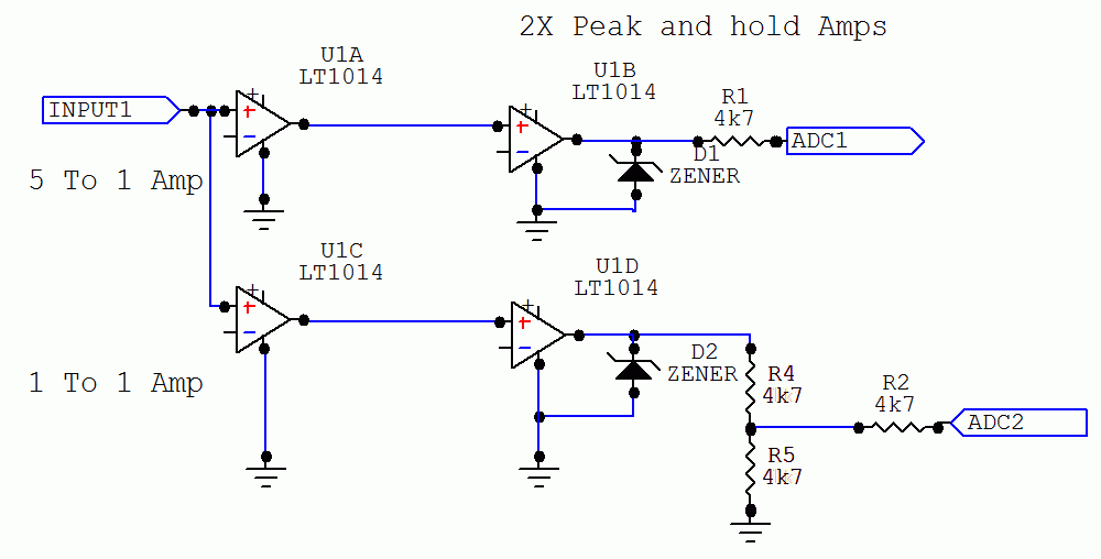

The LT1013 will swing close to 0V, but the upper swing is ~ +Vs - 2V.
From the datasheet the power output swing appears limited, especially at 50KHz.
I have moved the Zener diodes.
You do realise that you will have to resistively attenuation the input signal.?
Its not permitted to drive the inputs with a signal that swings close to the power supply voltages.
Lets see your peak detect and hold circuit.

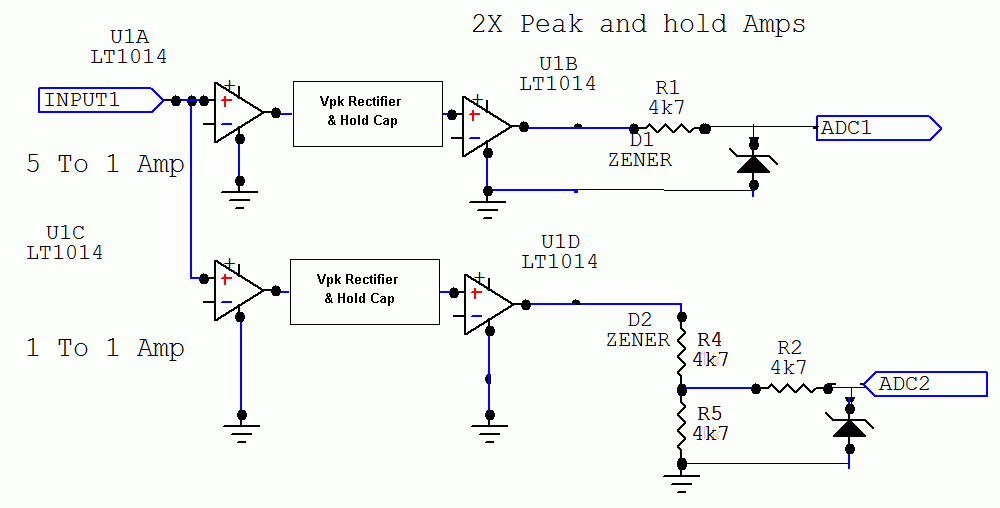

1/ So no to LT1013
2/Zeners, OK.
2/ No, but I'll put a resistor in.

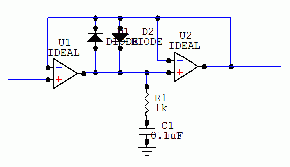

3/I had to Google Peak and hold, have a look. I presume the Peak and hold part takes up 2X Opamps form the Quad.
Hi Ron,
Looks interesting, I'll concentrate on EricGibbs circuit for now, thanks.

I would be interesting to help with the design but I would need to know a lot more about the application.

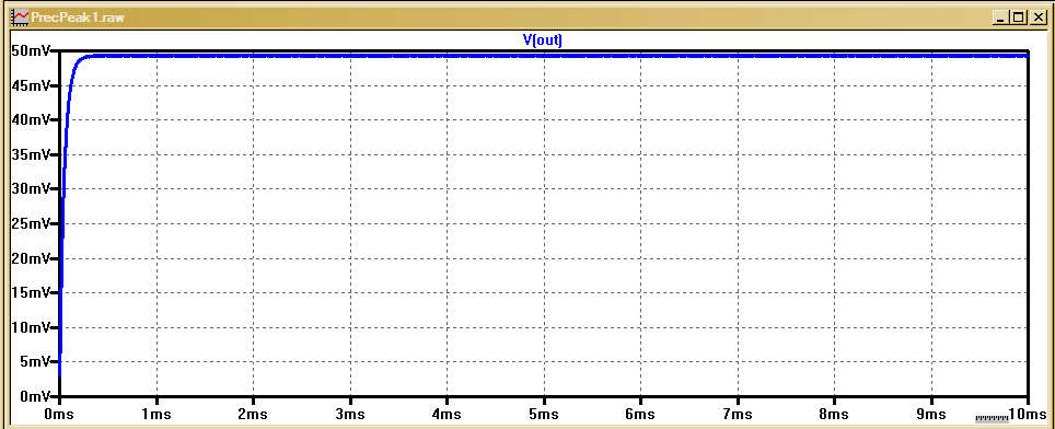

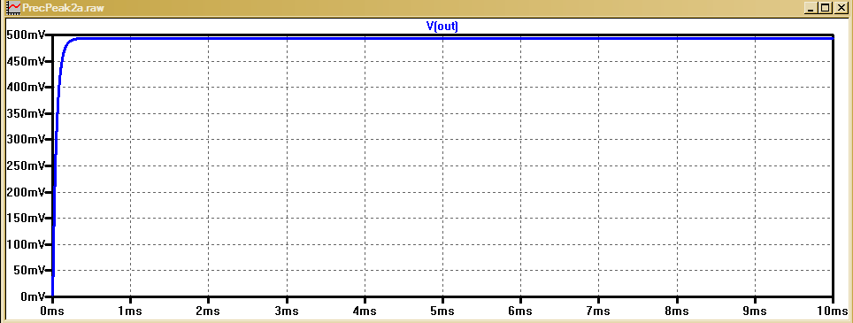

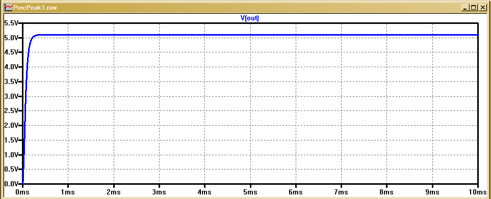

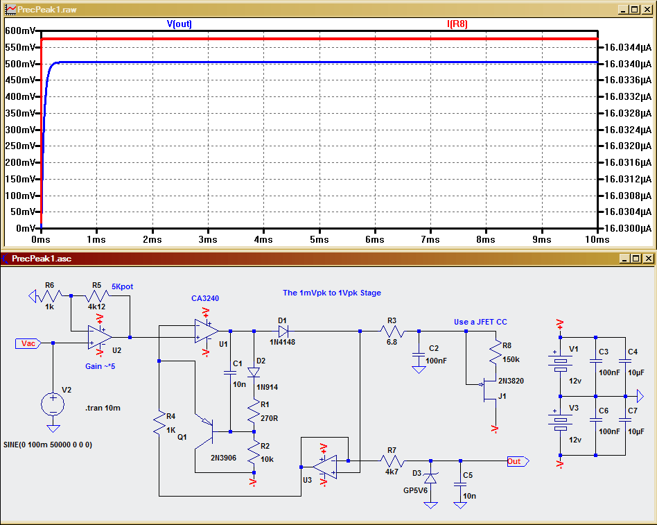

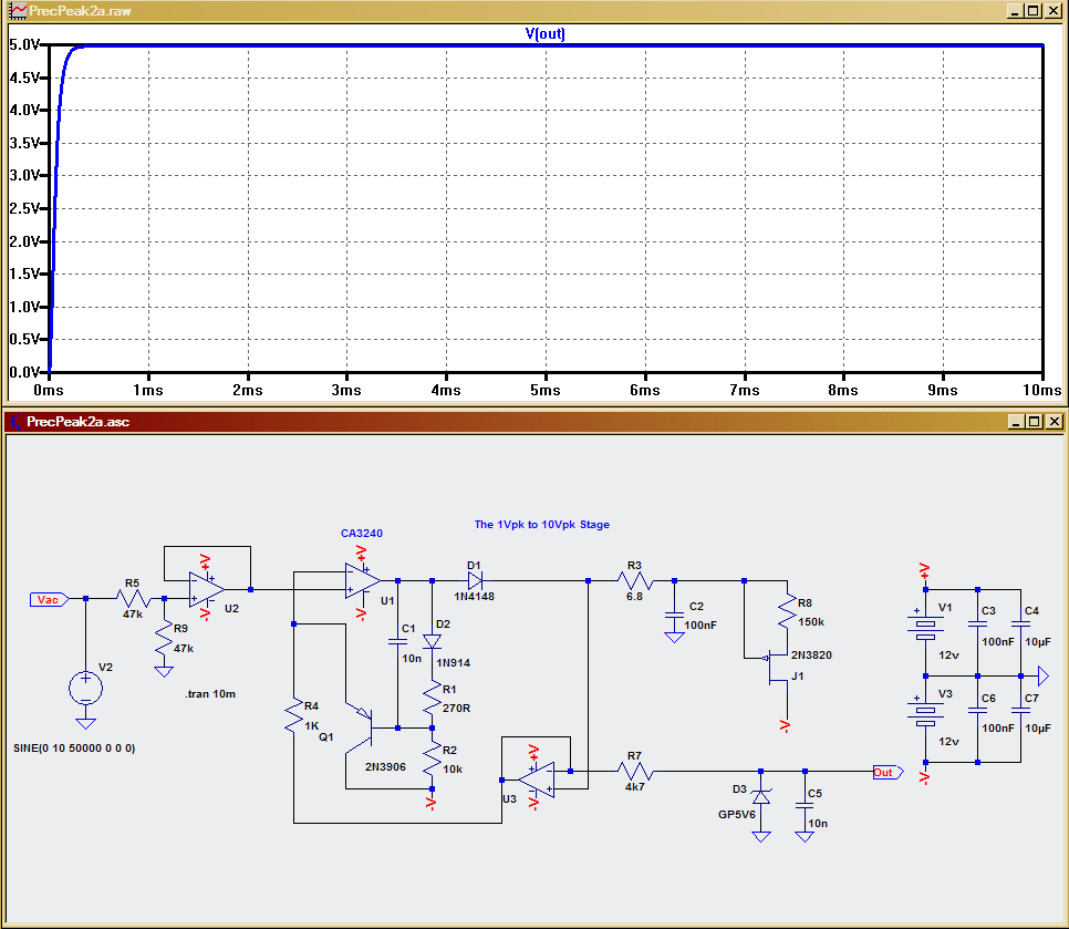

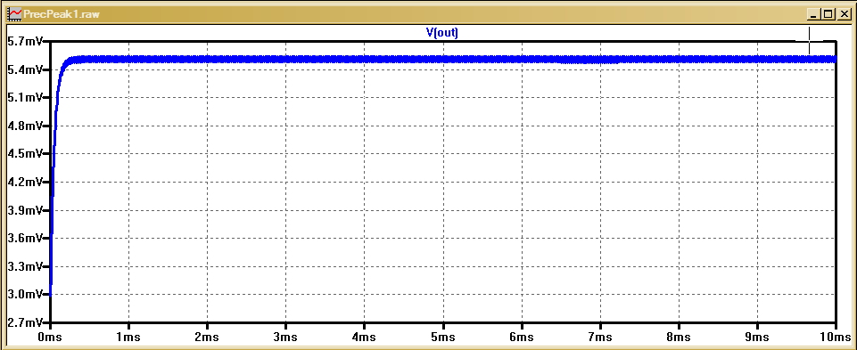

This should help get you started.:)
In the zip is the circuit diagram and 1mV thru 10V plots.
The images are 1mV,10mV and 1V ......... [ *5]

Hi Eric,
I've been swatting up on Opamps, but I would have never ended up with this circuit, it and the readings looks great.
One problem is that my system uses 1X 12V Battery. Can your circuit be altered to suit?
If this is possible, I'm sure it would fit the bill. Thanks.

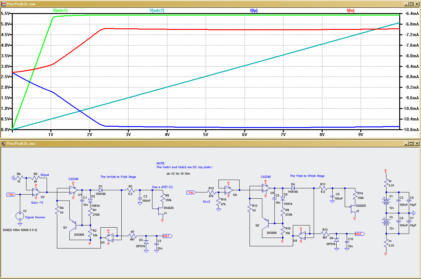

Its really got to be a dual supply.
This sim shows the 1V to 10V part

Look at this image , it shows the +V and -V supply currents.
Approx 11mA for +12V and 7mA for the -12V.
The two 12V batteries are in Series not Parallel,
I have added the two adc inputs to show how they are related, note I have a used a 1mV to 10V DC sweep to show the plots.
I nearly understand it, an it looks good to me.
Did I say batteries in parallel! Of course it is series. So the second battery @7mA won't need to be too big either. A couple of A/hrs = A week or so. That's fine.
I will need to Divide ADC /2.
It will be w hile before it is set-up, with circuits and programs etc, but I'll let you know the outcome.
Thanks for you efforts.
