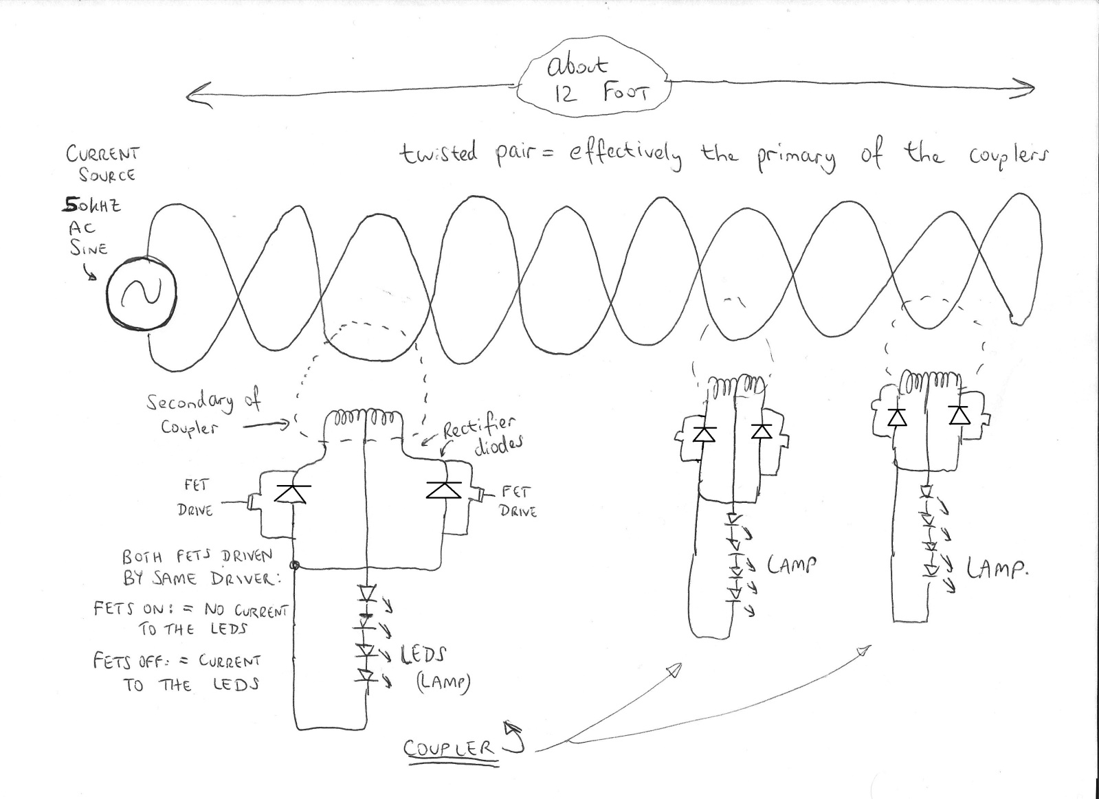

as ()blivion pointed out............this is no normal transformer...this is a "resonant inductove coupler"...........its high science, schematics of which i am not invited to see....................maybe the R.I.C. has a current transformer at its output to buffer it from the led load?...what do you think?............i unfortunately do not know........i wish i did know, becasue when i am designing someting for a system, i like to know a bit about the system first.
as you know, i am trying to design a 50KHz phase cutter for the output of the R.I.C..so that the leds can be dimmed............and each individual R.I.C. has a different available current range

I'm more baffled by the ability to get any real power out of that single wire coupling. I've seen current clamps but they're not 50W but more mW and as far as I know somewhat inefficient.
Bonus question. Show me a circuit, coil whatever that can pull 5V @ 10A off a single insulated wire running at 100V @ 51kHz, ??A in a box about the size of a human hand.
Has anyone here done the maths? We have 1.9A going through a twisted-pair of wires forming a distribution cable. What is the magnetic field around one of those wires? I guess piffling! So even if you had 100% coupling efficiency over, say, 10cm of wire the power drawn off via the magnetic field would be.....piffling :D. I don't see how 50W, yet alone 650W, is possible.

51 KHZ and a ferrite core with a core area of 1 CM^2 can get you 5.7 volts per turn.
so for 50 watts you need about 10 amps of current at 51Khz flowing through that twisted pair wire.
...no its 1.9A rms in the twisted pair wire...and that gives the 50W
Doesn't that give off a huge amount of RF noise and if not how are they keeping it from doing so?
51KHz is not a frequency thats easy to make radiate without huge structures. (antennas)
.....such as all that twisted pair distribution wiring? :D. Besides, it's harmonics of that 51kHz which could pose a problem.
due to the variable load placed on the main inverter, this is definitely an application requiring at least some kind of quasi resonant drive network, this could easily keep the harmonics below 500Khz. but its also really expensive VA wise, so you've got a lot of money burnt up in some high quality impedance transforming network...
unless you want to pwm an LCL filter at 500Khz?
and yes you're only going to get 5 volts per turn per square centimetre of core area. that is theoretically about 10 watts.
or 50 for 10 square centimetres of core area, explaining why you have a 100 gram ferrite core.
