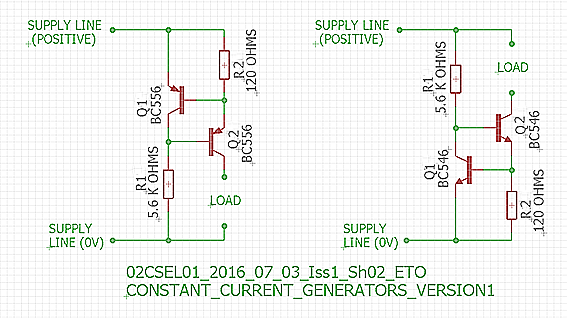

(3) Schematics
(3.1) Here are two schematics (drawn in EAGLE): the constant current generator circuit from your original post which has a positive supply line referenced load is on the right; both transistors have been changed and the value of resistor (R1) has been changed. An inverted constant current generator which has a zero Volt referenced load is shown on the left. Both circuits have identical performances.
(4) Notes
See Les' post #11 for a good description of how these circuits work

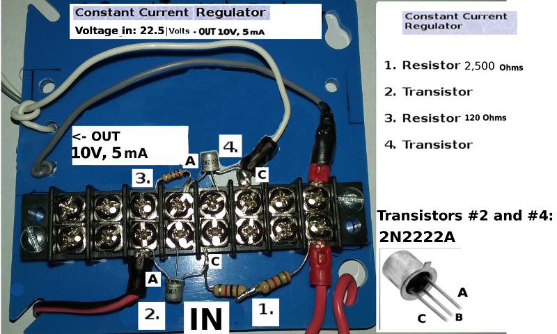

Back to "dilemma" I have presented - initially, and from my understanding, (summarizing & new example given), if I may:
- 22.5 Volts - input from a Constant Current Power Supply
- Resistor #1. 2500 Ohms, (give other ranges - examples?)
- Transistor #2. (observe picture - attached - initially), 2N2222A or (better - BC546 transistor)
- Second resistor #3. 120 Ohms
- Transistor #4. (observe picture - attached - initially), 2N2222A or (better - BC546 transistor)
MATH:
22.5 V - 10 V = 12.5 V
12.5 / 2500 Ohms = 0.005
(2500 Ohms * 0.005 = 12.5 V)
(10 V * 0.005 = 2000)
.06 V / 0.005 = 120 Ohms

- Can I deduce that 2500 Ohm resistor #1., in (R1 in the schematic) - would be acceptable?!
Output, MUST be 0.005
Thank you, Spec & Les

Not too sure what you are asking here, but to answer your final question, yes a 2500 Ohm resistor can be used for R1. (22.5V-1.2V)/2500 = 0.0056 A would be flowing through R1. The constant current would still be 0.005 Amps.
This is one of the weird things about electronics- certain components are not critical (R1) but other components are super critical (R2).
Note that if Q2 were a BC546 and you made the supply line 65V the 2500 Ohm resistor would need to be at least a half watt type.

Q1 and Q2 are 2N2222A. However R1 is 1/2 Watt - resistor. (please, see post #22)

Quotation, answer from Spec, Post #29 :
With Q2 as a type 2N2222A (as opposed to type 2N2222) the maximum supply line would be 50V as the 2N2222A data sheet shows a maximum VCE of 50V.
R1 at 2500 Ohms and half watt rating will be fine.
spec
This product is finished and works fine. Mission accomplished.
Thank you fellow members, very much

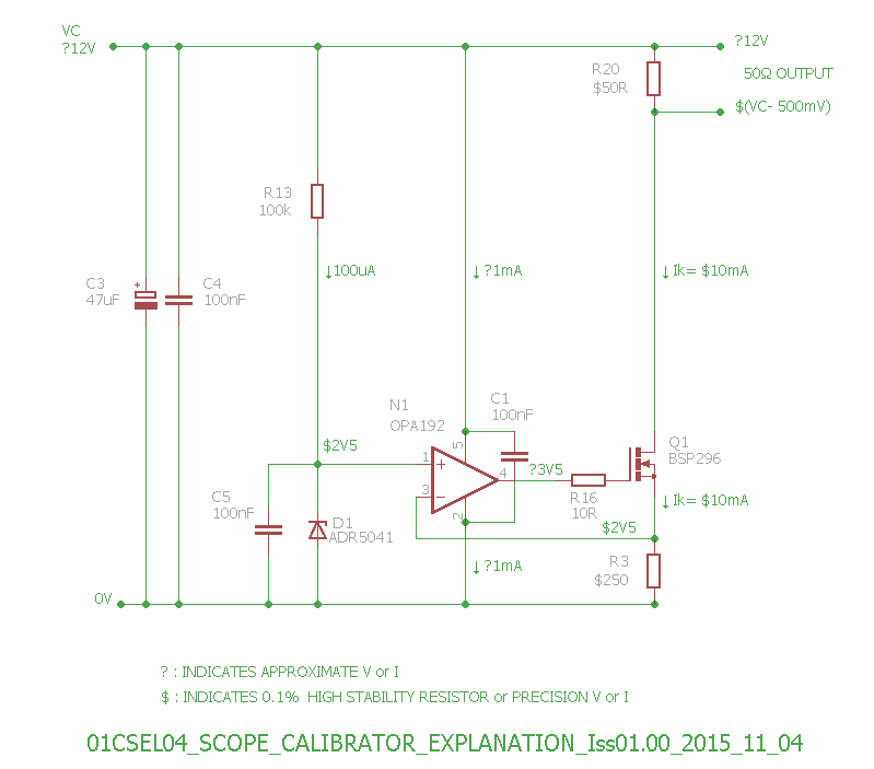

Hy Simon822,
Just as a matter of interest, this is an example of a precision constant current (Ik) generator.
(1) In your circuit, the reference voltage for generating the constant current is the 0.6V base/emitter voltage of a silicon transistor, while in this circuit the reference voltage is the 2.5V of a precision reference diode (D1) which is accurate to +- 0.1%.
(2) Instead of a normal NPN silicon transistor, an N type MOSFET (Q1) is used where its drain current and source current are identical.
(3) The precision operational amplifier (N1) monitors the voltage across R3 (+-0.1%) and, by controlling the gate of the MOSFET makes the voltage across R3 also 2.5V. The inputs of the opamp take no current in practical terms.
(4) An opamp always tries to make its two inputs the same voltage. It does this by adjusting its output. This is the basic functioning of an opamp in a nutshell.
(5) By setting the voltage across R3 the current through R3 is defined, hence the source current of the MOSFET is defined and it thus follows that the MOSFET drain current is also defined. In this case the drain current of the MOSFET (Ik) is 10mA +- 0.2% worst case. This current will be constant regardless of the value of the load resistance R20 (providing that the voltage on the drain of the MOSFET does not drop below about 3.5V that is).
(6) By changing the value of R3 the constant current can be set to any reasonable value. For example if R3 were made 500 Ohms +- 0.1% the constant current would be 5mA.
(7) By the way, don't let the capacitors cloud the issue. They have no effect on the basic functioning of the circuit and are just there as good practice to keep the various components happy. This also applies to R3 connected to the gate of the MOSFET.
Thank you, Spec.
