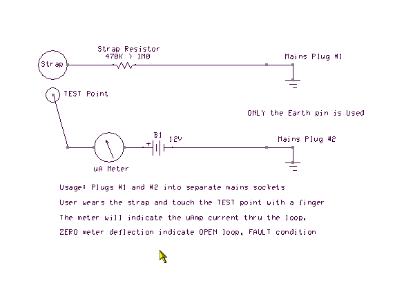

To test a grounding wrist strap requires a KNOWN good earthing point.
Measuring the value of the resistor [470K thru 1M0] and the continuity of the connecting wire will not proof test the strap.
You need to apply a voltage to the strap and the KNOWN ground.
If I gave some instructions on how to construct a test box, do you have the facilities and expertise to make it.?

This is a very basic tester.
I would use an amplifier across a sampling resistor, that would drive a GO/NOGO buzzer or LED.
Its the Earth loop thats important.

i'm really interested in that.
And i have checked the given ckt. that was really nice.but that is not suitable to use in an industry.
thnx
