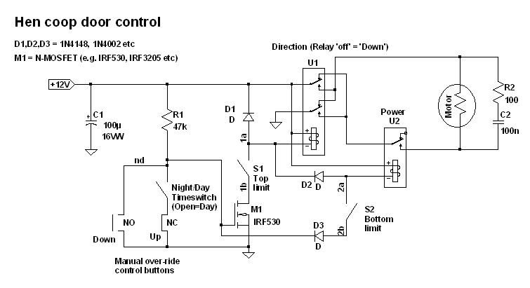

I appreciate the donation but, it isn't necessary. I can easily obtain them here. Ned, could you provide me with a simple diagram as to the proper connections? I believe this would be the easy, cost effective means to accomplish my goals. Each time the relays are powered up by the timer, the contacts would switch position and reverse the polarity of the motor. Do I understand that correctly?
I am pleased you don't need the relay. I think the circuit posted by cowboybob is fine for you. The only thing I can think of is to make sure there are diode rectifiers like 1n4001 series in parallel with each relay coil with the cathode to hot (12V+) connection of the relay. They will insure that relay coil de-energizing spike does not cause problems.

If you're using automotive relays be aware that their coils are current-hungry. You need a circuit which doesn't keep a coil energised for longer than it takes to raise/lower the door, otherwise your battery will drain rather quickly.

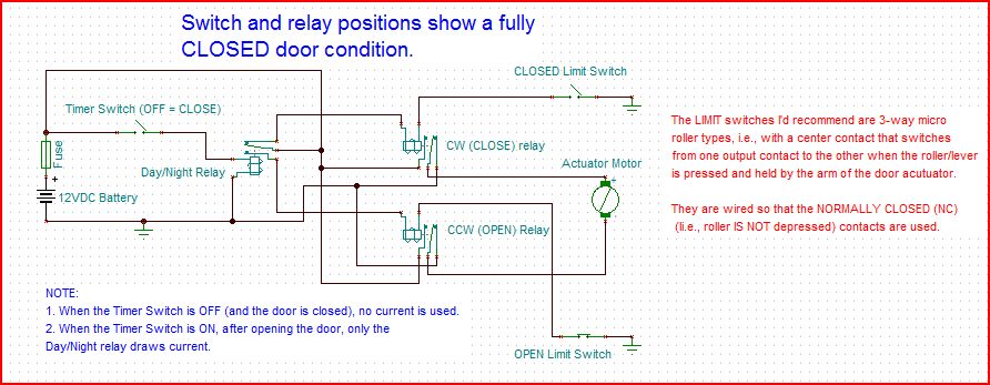

One final plea- is it possible to provide me an idiot proof diagram? From the timer with +&- out to a "polarity switching device" (ie- 4pin spst, 5 pin spdt or 8 pin dpdt relays- I now have them all) to a two (2) wire reversible motor? You see, I can't find a CW or CCW and no one here knows what I'm asking for and neither do I. I really do appreciate the input from all of you- I guess it boils down to the language of your discipline. What seems so simple to you all may as well be brain surgery- I don't know either one.

My friend, I have used relays in the only manner I understand. Aux lights, radios, etc... How they can be used to reverse polarity is eluding me. Looks like I'm in for the $200 door...Problem is I need three and don't have the $600 to spare. I've looked for all the parts that you have all suggested and I now realize I'm in over my head. I'd buy us both a pint if I could, Doc. And, no- I haven't the time to teach my chickens (lol)- they already know how to do what I need- lay eggs and taste good...

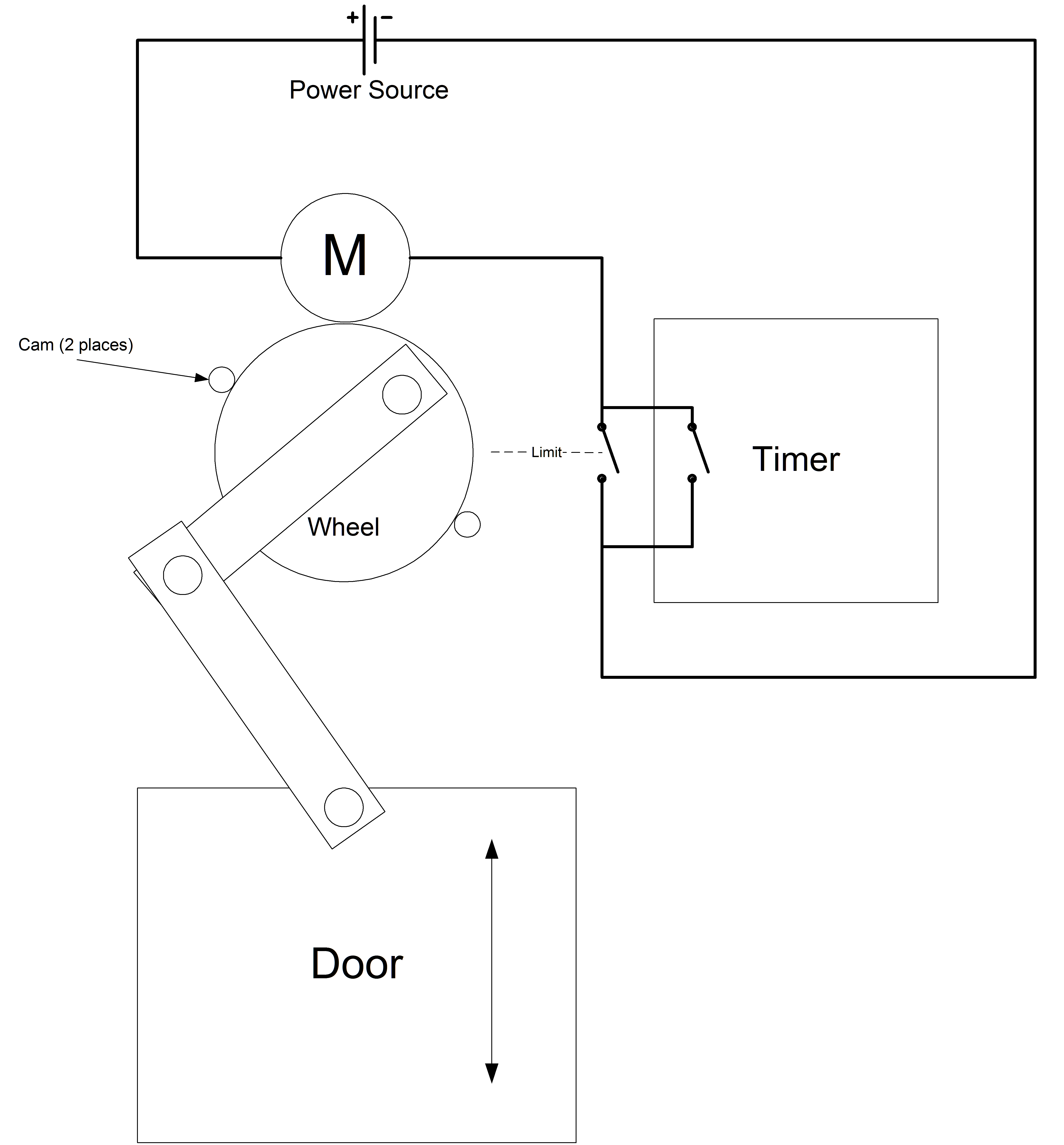

Hi Farmer,
Here's another idea. See the attached diagram. The circuit can hardly get any simpler. The motor drives the wheel. The pivoted arms open and close the door as the motor (and wheel) rotates in one direction only, choo-choo train style. The two cams are positioned so that they push against, and open, a limit switch when the door is in the open and closed positions. When the door is closed it can't be forced open because the two pivoted arms will be in a straight line parallel to the movement of the door so that no rotational force is applied to the wheel and the force works perpendicular to the shaft of the wheel. The timer switch is set to only briefly close to get the motor running at your preset times. When either cam hits the limit switch, the motor stops until the timer switch momentarily closes again. You can install a pushbutton switch near the door, connected in parallel with the limit switch to operate the door locally. That may not be necessary, however, if the timer allows you to manually close its switch momentarily.

Sounds like I've missed the bus, but here's an option using the timer and relays you already have, with an average standby current of only ~ 125 microamps:
...Bus?... you mean the run that ran me over?...Thanks, Alec. I'll show this to my friend (Good thing I helped him get the bats out of his house a couple years ago- I figure I've "payed forward" a time or two).

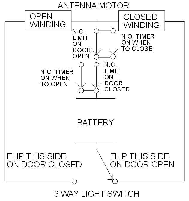

Howdy, been a while...
Am I missing something? Don't antenna motors have both up & down windings i.e. built in "reverse"?
That so, all needed is an SPDT switch, stable in either state (std 3 way wall light switch).
Mechanically linked so the end of either move flips the switch to the other direction.
Add in 2 limit switches, and the 2 timers with N.O. contacts.
Good Hunting... <<<)))
P.S. I think limit switches are also built into the antenna motor.
Some do, some don't, it seems.
