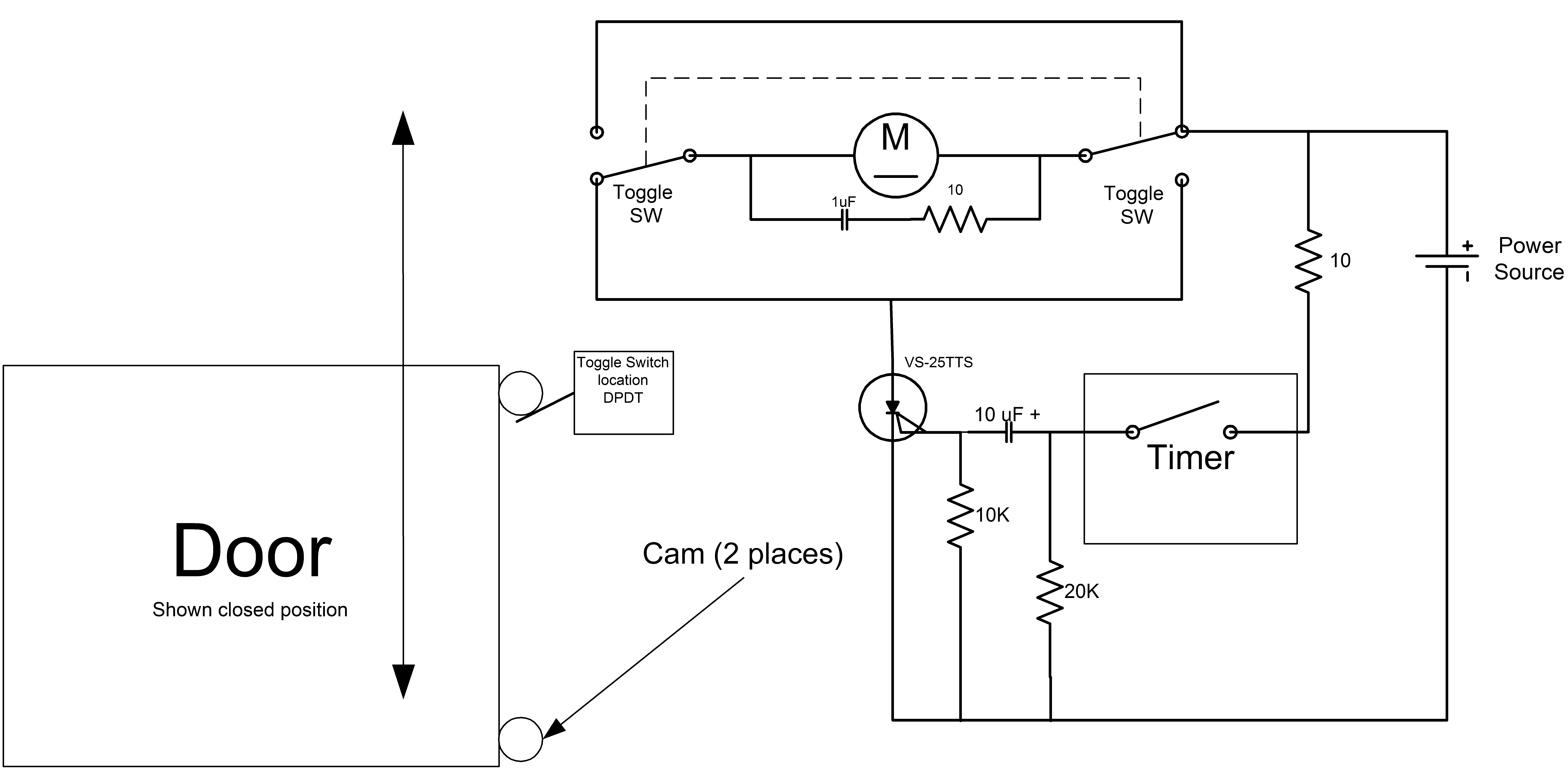

Okay, here's yet another idea; cheap and easy if you must reverse the direction of the motor for up and down. A single DPDT toggle switch performs the reversing and limit function. The SCR is triggered by the timer switch closing, thus latching and supplying power to the motor. When the door reaches either limit, current to the motor is interrupted briefly as the toggle switch changes position, so the SCR turns off. The toggle switch is set to reverse the motor direction when the SCR is triggered again.

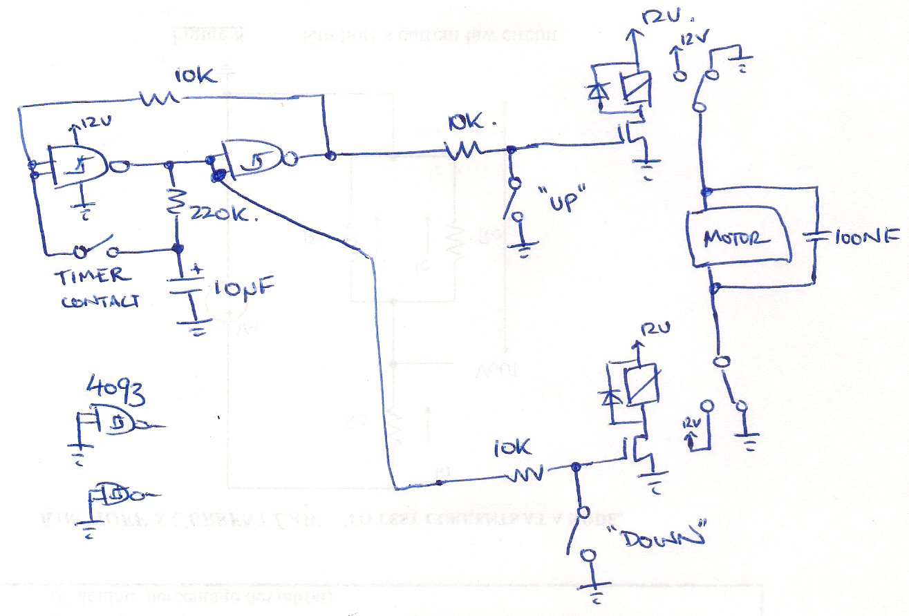

I apologise for not reading all the previous posts, but going on the requirement for a motor controller that reverses the motor each time the timer activates, while heeding limit switches, the attached circuit should work. It's simply some logic to toggle between forward and reverse whenever the timer closes the contacts. The limit switches disable the motor when it hits the end of travel. Hope this meets your requirements.

Thank-You, Dougy83. I'm searching for someone here to "decode" the notations. God as my Witness, I had no idea that this would be so complicated. What an education! I must re-state a previous thought- You all have a talent (if not an art) that is truly fascinating. I am inspired (and, bewildered).
Oh, you mean the schematic is too cryptic? If you're happy with the function that I outlined, I'd be happy to redraw it showing how to physically wire it up.
Things have been "interesting" around the farm lately- So, I'm sorry I didn't respond more quickly. Yes, from what I understood of your drawing, I believe your idea is "on the money". I will provide you with the components I have (and, can discard if they're incorrect- I'll use them for something else) and get what I need.
