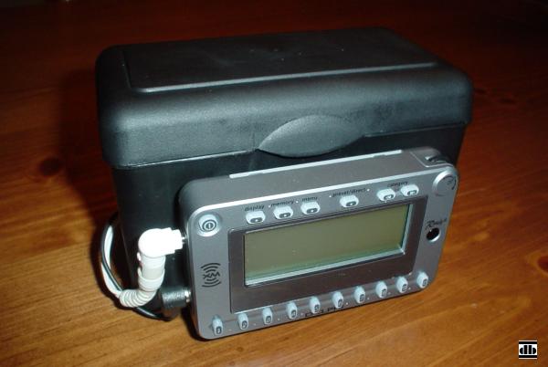

I just got one of the newer XM Radio "Roady2" units which has a built in FM transmitter. This way you don't have to hard-wire it into your existing car stereo. It's intended to be mounted on your dashboard...

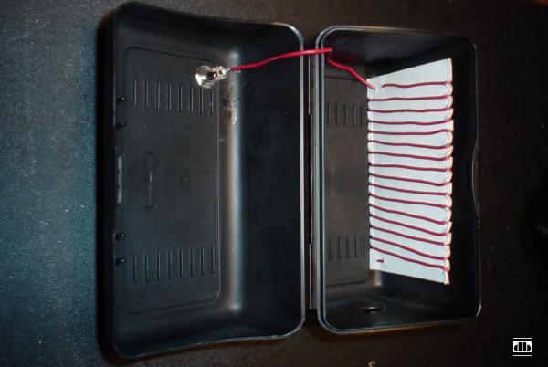

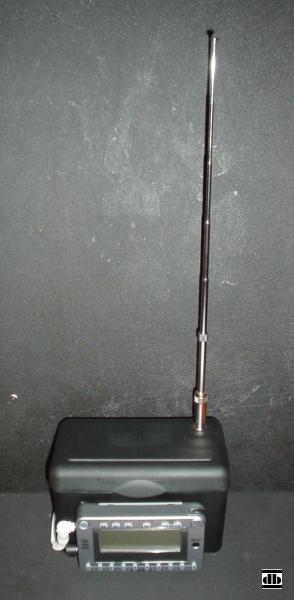

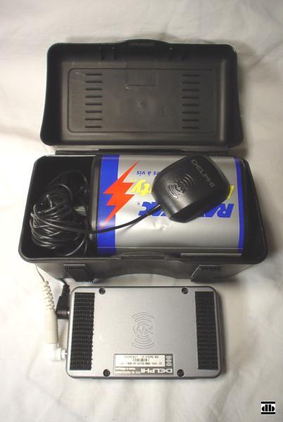

What I did, was build a little battery box out of a plastic index card holder from Staples, that holds a 6v lantern battery and the satellite antenna so that I can make it more portable. The problem is that the built in FM transmitter is not strong enough to send a signal as far as I would like it to.

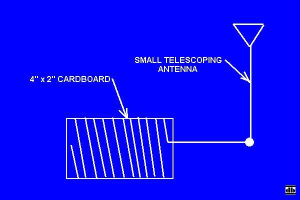

The built in FM antenna is nothing more than a "loop" of metal suspended above the PCB on the interior of the XM reciever. I was hoping that a simple coil of wire placed directly behind the XM reciever would "catch" the signal and that I could re-direct that signal to a small telescoping antenna, thus getting more range out of it.
I tried two versions of this idea, one using a short length of wire and one using 50 feet of wire, both wrapped around a piece of cardboard. Neither seemed to have any affect at all.
Is this there any way to improve upon this idea?

Well, as far as whether or not the signal from the XM is getting picked up by the coil and directed to my telescoping antenna, I can't tell... There is no marked improvement in distance of reception.
There won't be, it's not a workable idea.
I like the OP amp idea, but I was hoping that I could avoid anything too complicated. Perhaps there is a way of making a coil that acts as a sort of transformer, "stepping up" the output of the telescoping antenna?
You can't use an opamp for something like this, you would need an RF power amplifier.
I don't even know if my original coil idea is a step in the right directionl. I just assumed that it might work, but like I said, I'm not getting any good results.
You would need to remove the original aerial, and replace it with a better one, making sure it's tuned to the correct frequency and matched to the impedance of the transmitter. The design of the transmitter is probably such that this could be quite difficult, it's only designed for extremely short range - adding a better aerial probably won't make a huge difference.
How far are wanting to extend it?.
I'd be tempted to clip a 6 inch length of wire to the antenna to see what happens - possibly adding a capacitor (10 pf maybe) or small air variable to uncouple any DC. It might or might not cause stability problems with the transmitter. What you've shown is actually quite the popular way to couple an AM receiving antenna to an AM radio with an internal loopstick. I could be wrong but the inductance of your coil is likely to be an impediment at FM frequencies.

Since I use the XM in both my truck and on this battery box, I wanted to avoid any kind of "direct" connection to the internall antenna.
Perhaps I'll try a solid metal plate in place of the coil and see what that does.
It's a shame the output of the built in antenna isn't just a bit stronger... The reason behind the idea is that I can only get a sattellite signal from a south facing window and our office (where the boombox is) is on the north side of the house about 20-30 feet away (thru some walls).

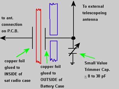

The diagram I'm ( hopefully ) attaching shows a way to COUPLE the external antenna to the FM transmitter .
The copper foil will act like a capacitor. The thickness and dialectric properties of the sat radios case will determine the SIZE of the copper foil pads , and you will have to experiment for best coupling.
the telescope antenna should be between 10 to 19 inches in length.
the trimmer capacitor is used to TUNE the network for resonance.
IF the FM RECIEVER you are planning on useing is going to be a DEDICATED reciever ( MAIN purpose is to recieve the output of the sat radio ) you might want to look into PEAKING the thing for BEST reception on the sat radios OUTPUT frequency.
