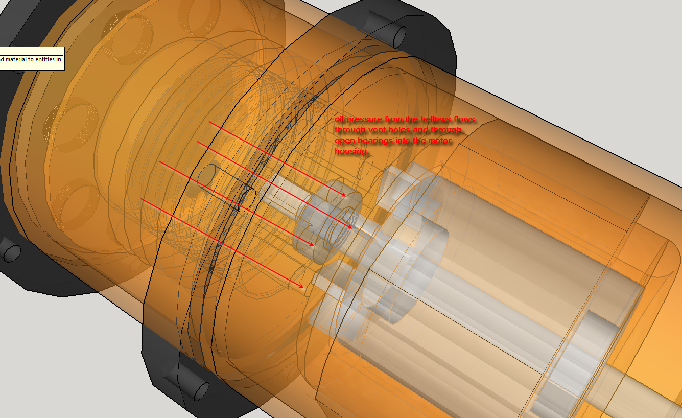

I don't know where I'm failing to properly explain this... We DON'T need or want a pressure vessel. I AM designing an oil filled enclosure which naturally adapts to ambient pressure.
Not trying to be combative on this. But can't see any way this, naturally adapts, will work without venting to the depth pressure. And this will change as depth changes. A vessel filled and sealed at one atmospheric pressure will still be at that pressure when the out side pressure rises. And the same laws for pressure vessel bursting pertain to pressure implosion. Both legal and physical.

There is a pressure balancing diaphragm mechanism between the motor vessel and the sea water. Oil stays inand water stays out regardless of depth and relative pressures.
No it won´t. A pressure vessel will, but that is not what strantor wants. A vessel that is not made to withstand that pressure will simply deform until the pressure inside and outside is equal, so if you design in such deformation zone everything will be hunky dory.

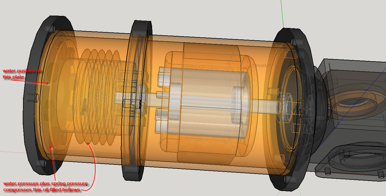

Yes. It is done all the time on many bits of equipment which are intended for use subsea. It is called a Pressure Compensator.
Pressure vessels to keep subsea pressure out, are big heavy and very expensive.
If the "thing" which goes inside the pressure vessel, is able to withstand seabed pressure, then you don't need a pressure vessel.
All you need is a sealed container which sufficient strength to withstand normal mechanical loads, fill it with fluid (usually some type of oil) and have a pressure compensator which is usually a thick neoprene rubber bladder, which is filled with oil and connected to the container such that oil can move from the bladder to the container.
Then, when the whole assembly is put down on the seabed, the seawater squeezes on the bladder and the sea pressure is communicated through to the inside of the container.
Same pressure inside as outside of the container, so it does not need to be a pressure vessel.
Lighter, cheaper and everyone is happy.

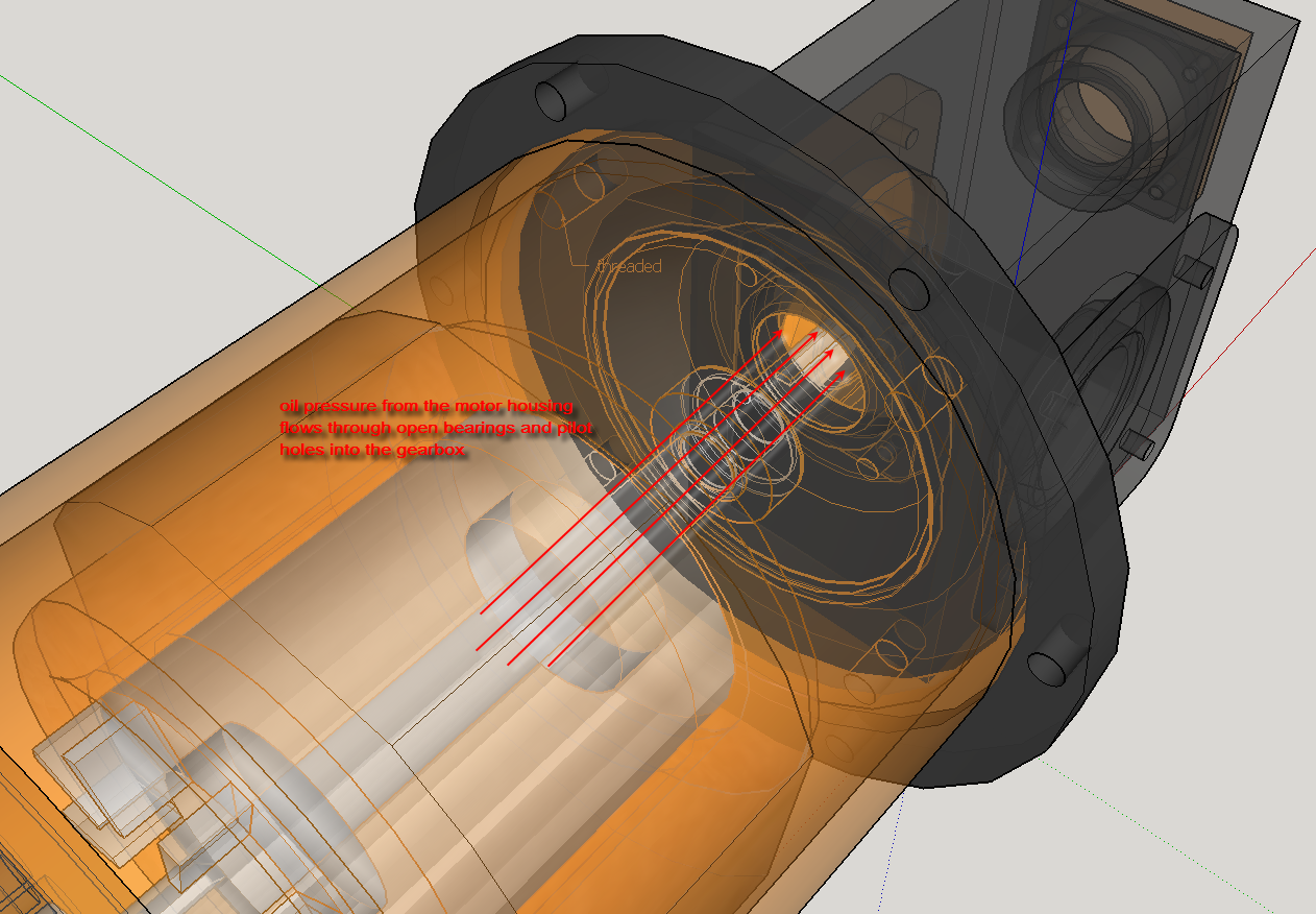

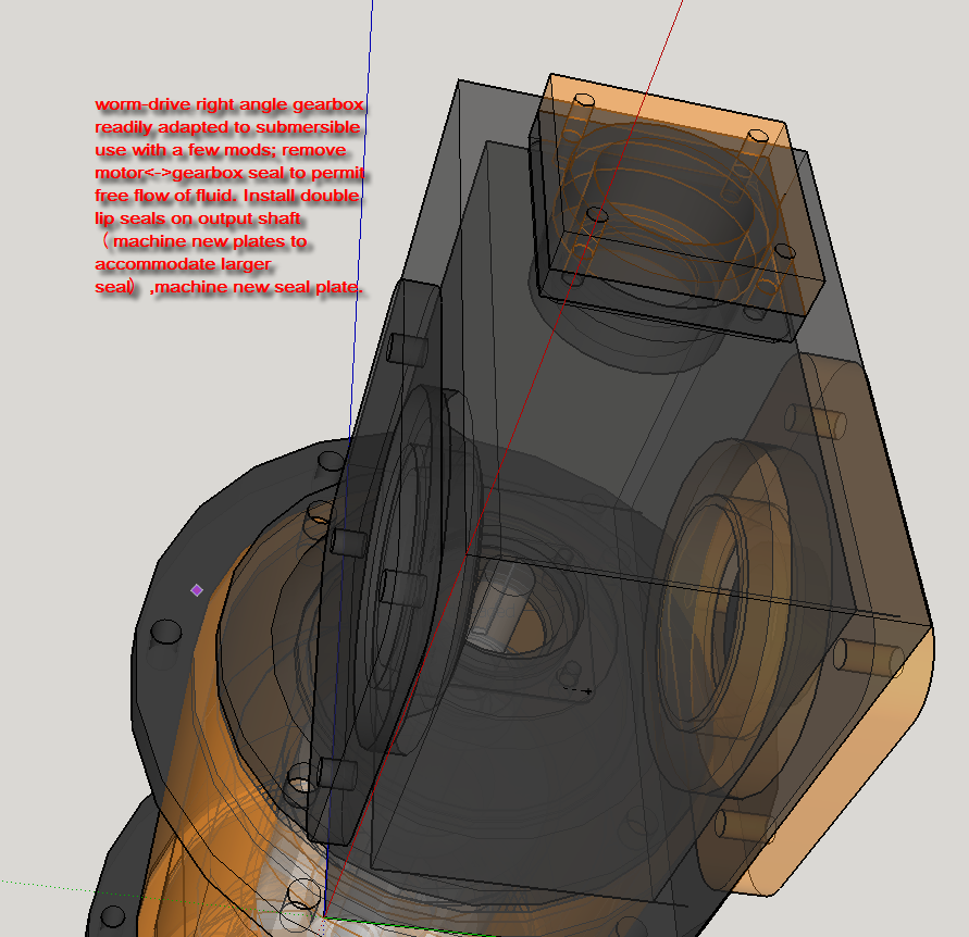

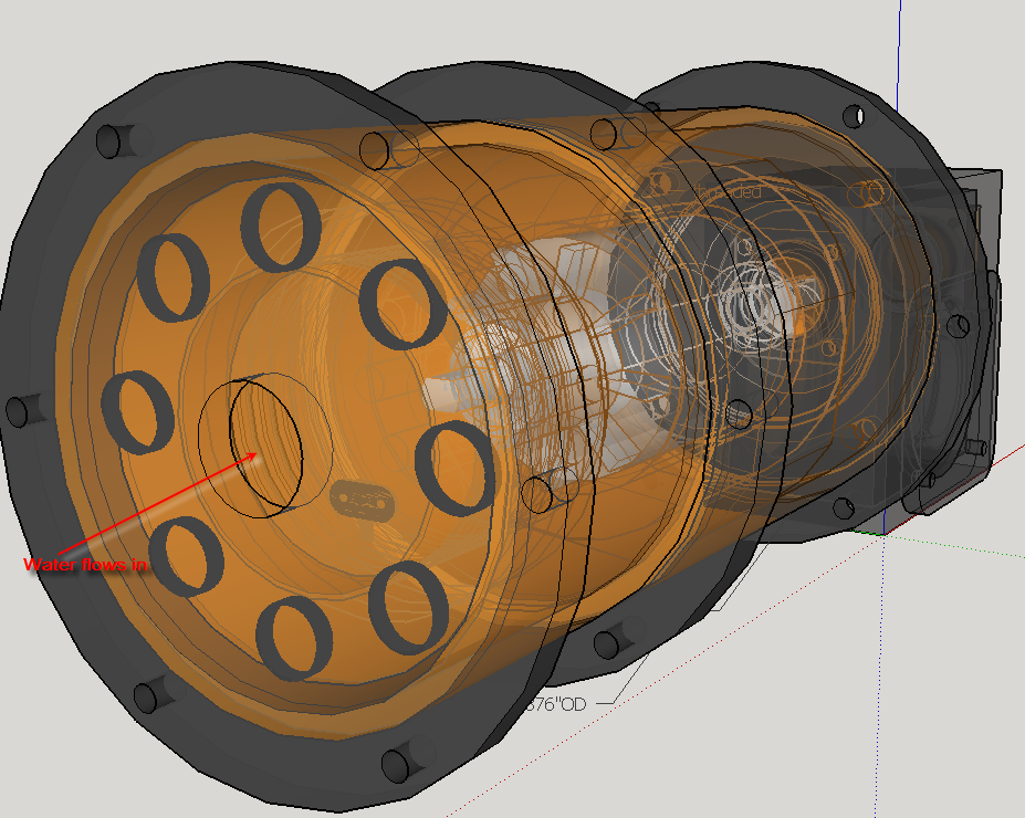

There's a piece of the puzzle you're missing. I thought I discussed it, but maybe I neglected to mention the integrated accumulator. There's a collapsible bellows exposed to atmosphere which keeps the internal pressure always a few PSI higher than atmosphere via compression springs. Here's some screenshots of my current design. It's rough; I'm not done.
