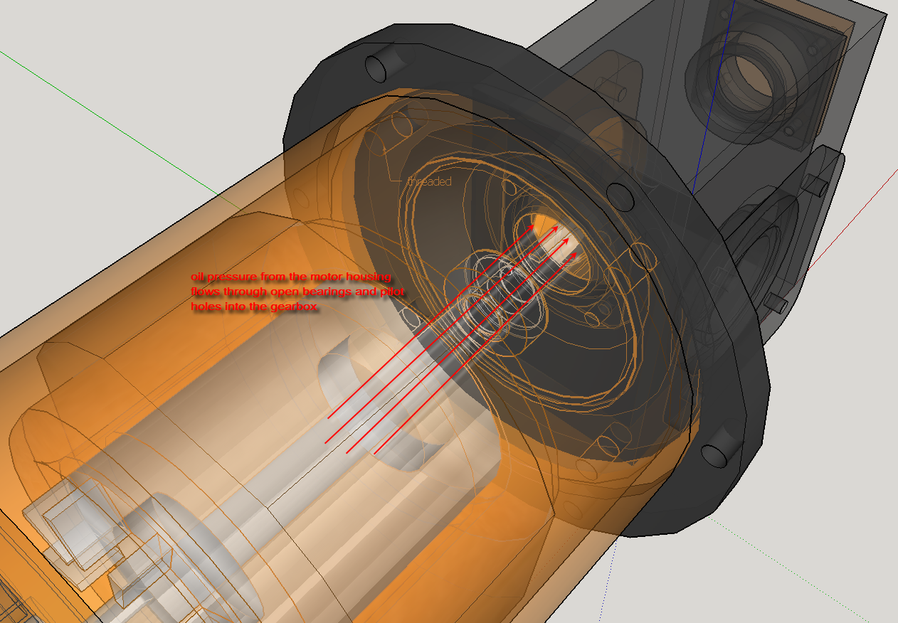

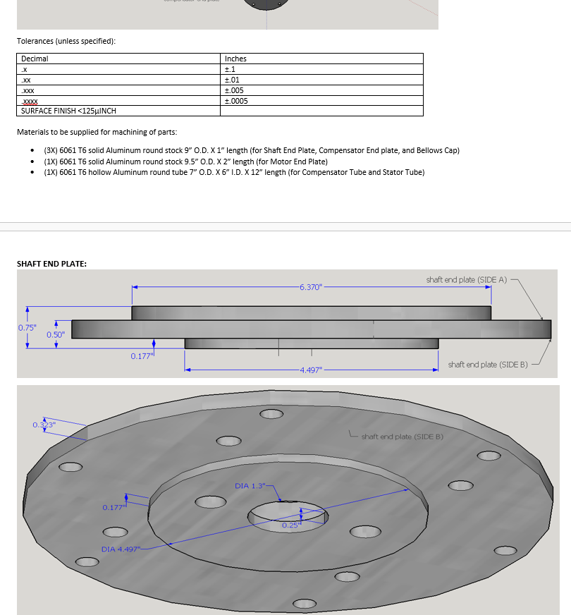

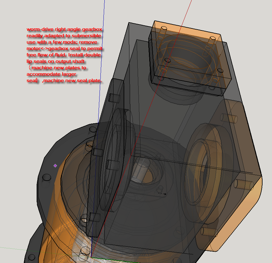

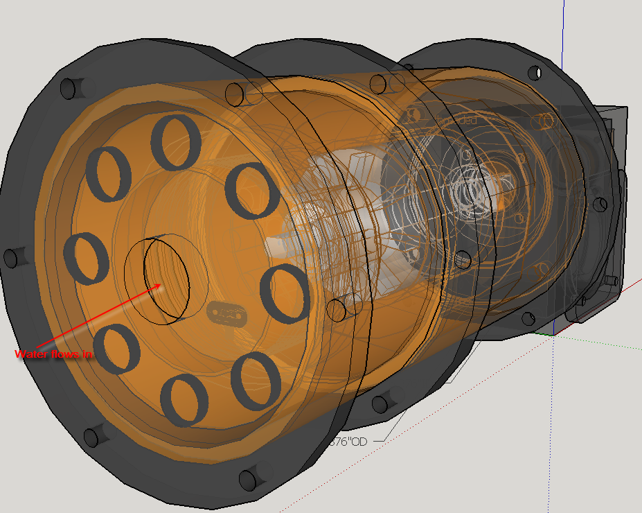

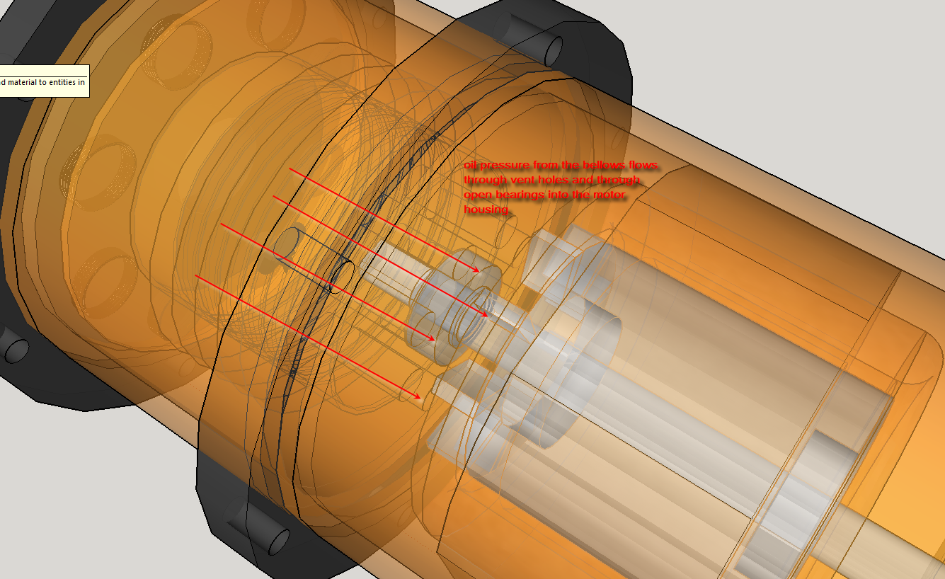

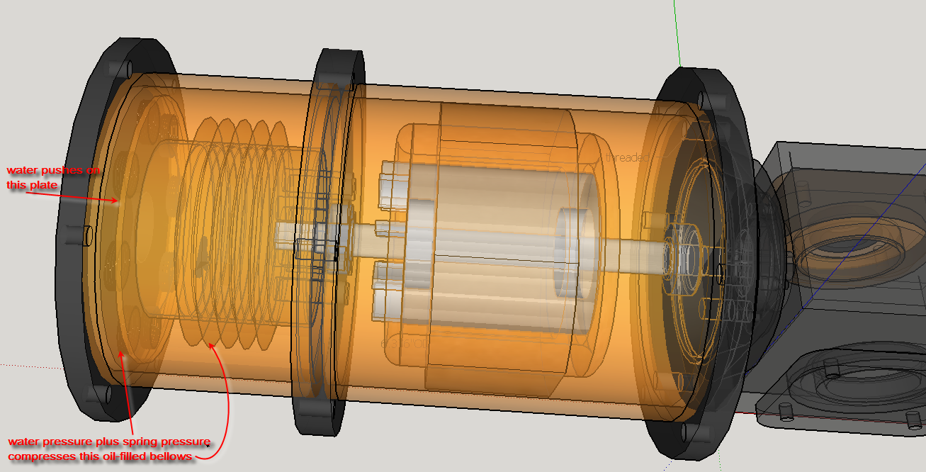

There's a piece of the puzzle you're missing. I thought I discussed it, but maybe I neglected to mention the integrated accumulator. There's a collapsible bellows exposed to atmosphere which keeps the internal pressure always a few PSI higher than atmosphere via compression springs. Here's some screenshots of my current design. It's rough; I'm not done.

Strantor, did you make the 3D drawings? Pretty nice. Knowing a 3D tool along with your electronics background makes you quite versatile.
Hey, thanks. Yeah I made the drawings in Sketchup. It's the only tool I know, and that's a problem. When it comes time to have these parts made, machine shops are accustomed to having CAD files submitted in formats that translate to their CAM software to be more-or-less directly loaded into their CNC machines. Sketchup doesn't do that. Sketchup is for hobbyists. Solidworks and Autodesk are what the industry uses, and they play nice with the machines. In the past I have had to submit my designs as PDFs with graphical drawings like this:
Then the machine shop has to re-draw it, or if it's a simple part made on a manual machine, it's good enough for the machinist to just make it.
