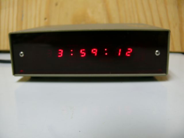

I'm sorry KISS, that's a really nice clock but you've got the screw-look I don't want! Maybe if they were black...

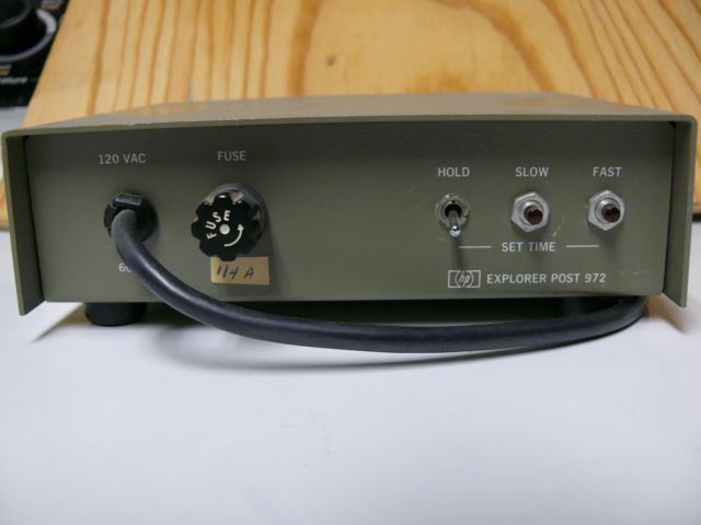

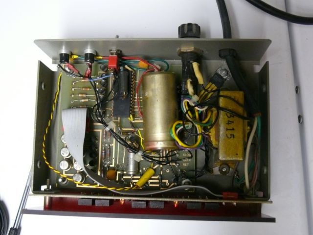

I was unsuccessful trying to retro the chip for back-up purposes. Note the HP Logo on the rear panel. Our first names of the three of us that did the board per group of 3 or 4 are visible from the front. This was basically high school for me. A Boy Scout's Explorer's Post. We just had to PCB layout (just the traces) in 4x using black, blue and red tape, assemble and troubleshoot the clocks. So, I said, the first group's clock to work and the second assembled. I think we had a bad 5V regulator like many others and a missing display trace. It was tiny and it may have fell off.

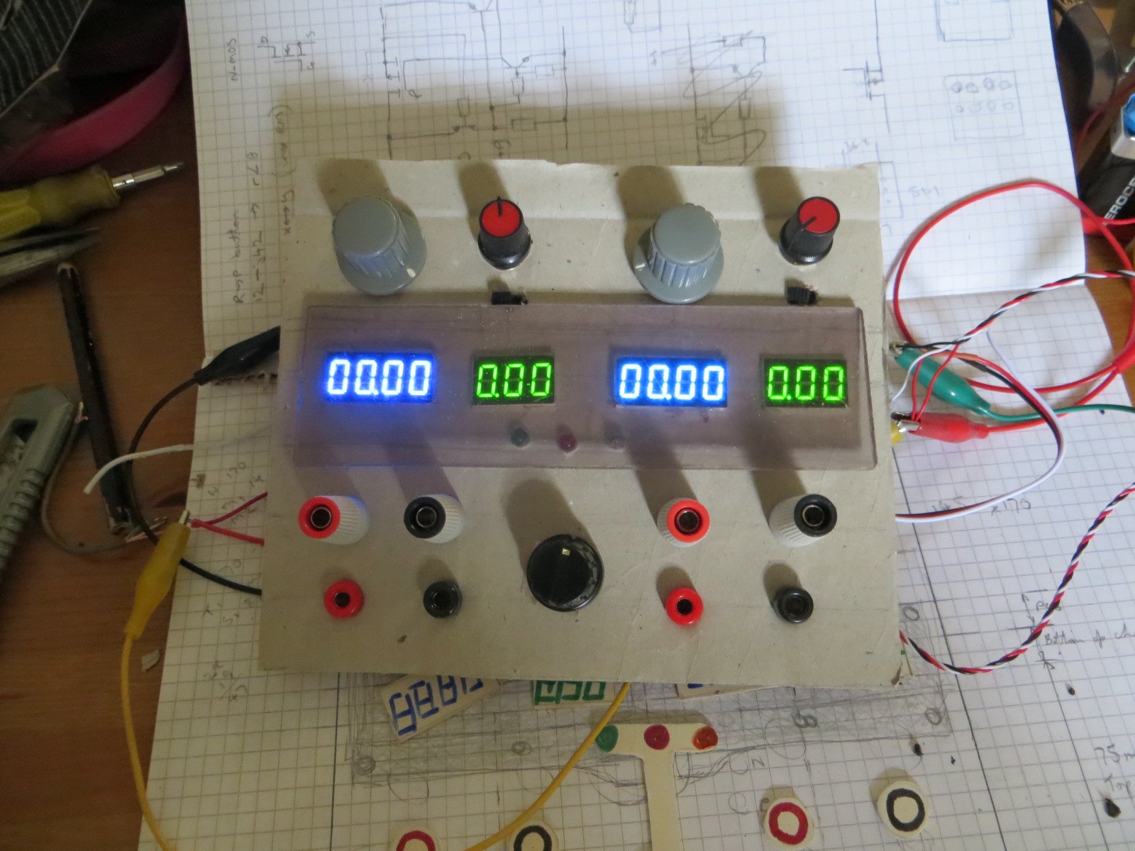

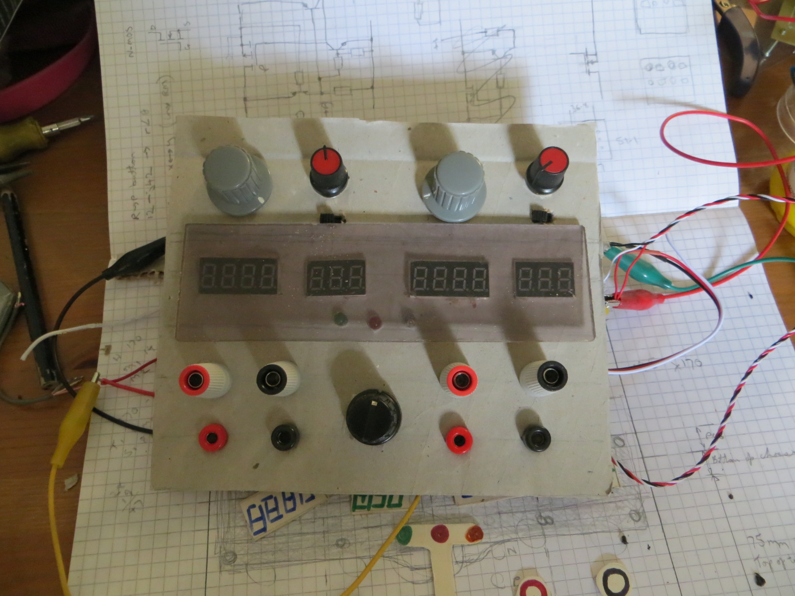

Ok here's a not very good mock up of the panel - it's made from a piece of cardboard with some grey paper stuck on it. It's a bit wonky because I did it all freehand. The perspex I actually use should be darker than the piece here but it gives an idea. I plan 4 screws along the top and 4 along the bottom of the piece.

I prefer a tiny bit more separation for each side, rather than a even spacing for everything. But that is a totally personal thing, will look great! I like the large to the back and small socket to the front, I have a cheapo chinky one thats the other way around and it drives me bonkers!! why be so stupid and do that?
Errrm, everything's at the front. Nothing at the back!
But anyway, I could make a wider panel. It was originally square because I wanted to keep the size down, which I didn't really like but was due to the spacings I needed in the case. I'm splitting up the main board so I've got more leeway now, so it's now shorter. Also I didn't want it to be significantly wider than the main board, but now I can see how it will (roughly) look I can see it needs more width. I was going to have the displays closer together so there would be a bigger gap in the middle and at either edge, but their circuit boards will overlap if they're closer than 10mm. I can file a bit off, but not much.
I was thinking I could use a layer of metallised plastic from an anti-static bag behind the bezel, save having to get the darker tinted stuff and stick with this piece of old record player top. That might look cool if it works.
