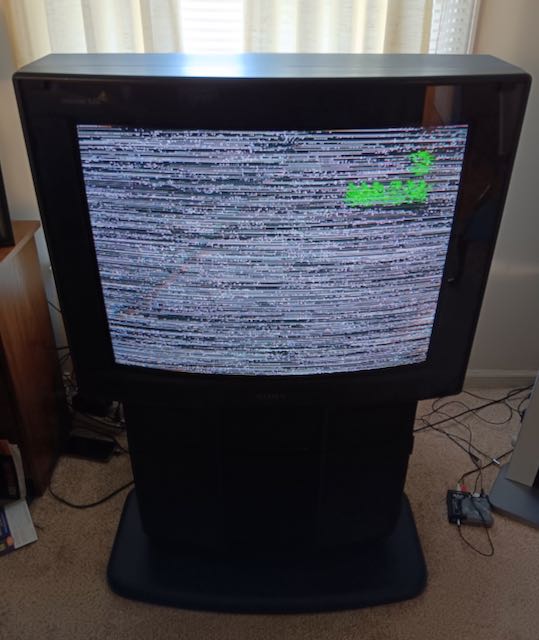

I have a Sony KV-29XBR85 that has a scrambled picture when the set is powered on (audio works fine). It stays like that for 4-5 minutes before the picture straightens out. The scrambled picture is on all the inputs. Once the picture does come on it is steady and looks excellent. The TV initially had the green vertical bar problem so I disconnected the P-32 connector to disable picture in picture and it solved that issue. It's getting worse and the picture is taking longer to unscramble every time I power it on. I am wondering if this is being caused by a cold solder joint, bad cap or transistor and where in the circuit the problem is likely to be. Has anyone seen this issue before?
Thanks, I do have the service manual already and have been looking it over. I was hoping someone may have seen this problem before and may be able to tell me if it's likely a power supply issue, sweep circuit, crt failure or something else.
Since it eventually runs okay, it could be a bad electrolytic capacitor somewhere in the power supply.
Can you monitor the power supply voltages as it warms up?
Disconnecting the one connector just temporarily covered up the problem. The horizontal tearing is from the horizontal AFC circuit malfunctioning. Since the picture in picture is effected (first symptom) them then the AFC processor on the video Luma/chroma/sync processor (IC301) or an associated part is the issue or the first one I would start troubleshooting with the picture in picture connector plugged back in.

I'm suspicious about the 'green bar problem', and disconnecting P-32, you can't really tell from a picture, but it looks more a digital processing issue than anything else.

This horizontal tearing until warmed up just makes me lead to the AFC circuit, but its also the same section is where picture in picture is combined. These later models incorporated it in an IC. I just can't remember if the factory repair kit for this problem included more than the ic301 because its been such a long time.

An update: I thought I'd try going in the service menu to see if adjusting the settings would help. I noticed that changing the HFRE (h-freq) setting lessened the scrambling slightly but did not fix. I could see that there didn't seem to be any color or picture, just a black and white scrambled pattern. I also adjusted the AFC which straightened the green service menu text and numbers but did not affect the picture. None of the adjustments I made were written to memory, I left the settings as they were. I opened up the tv and after discharging CRT I took out the F (power) board. There is alot of brown gunk around the solder joints particularly around IC651, D659 and D657; see pictures. C664 also looked slightly bulged and leaky. I'm thinking the next step would be to recap the board and test the diodes.

As it's a thermally intermittent fault, a can of freezer spray may help you locate the fault? - wait until the set has started working OK, then spray the various PCB's in turn, seeing if you can find aboard that when cooled reintroduces the fault.
