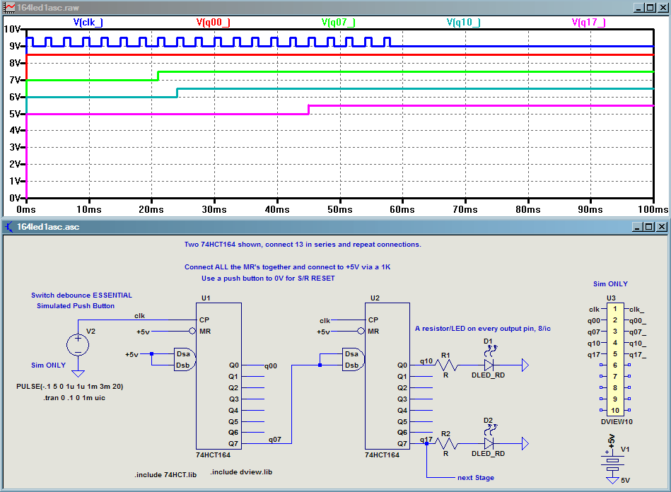

This image shows the bare bones for the shift register.:)

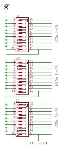

just forget about my design. I didn't realize you want all LEDs on (bargraph).

You can minimize this effect by connecting the switches as shown in the attachment.
Regards
Boncuk

Ok I have put together this circuit based on what ericgibbs has posted using a 74HTC164. It only includes the control circuit and the resistors for the LEDs. Each of the green pads will go to an LED. I have a couple of questions...
1) Have I done this right?!
2) What do I do with all the clock inputs?
3) Will this circuit definitely do what I need ie - count up by one everytime the button is pressed whilst keeping all the previous LEDs illuminated?
4) What power supply will I need if I am using 1.85V red LEDs with a 20mA operating current?
If I can't get this circuit sorted by the end of today I think I'm going to have to go down the dip switch route...
