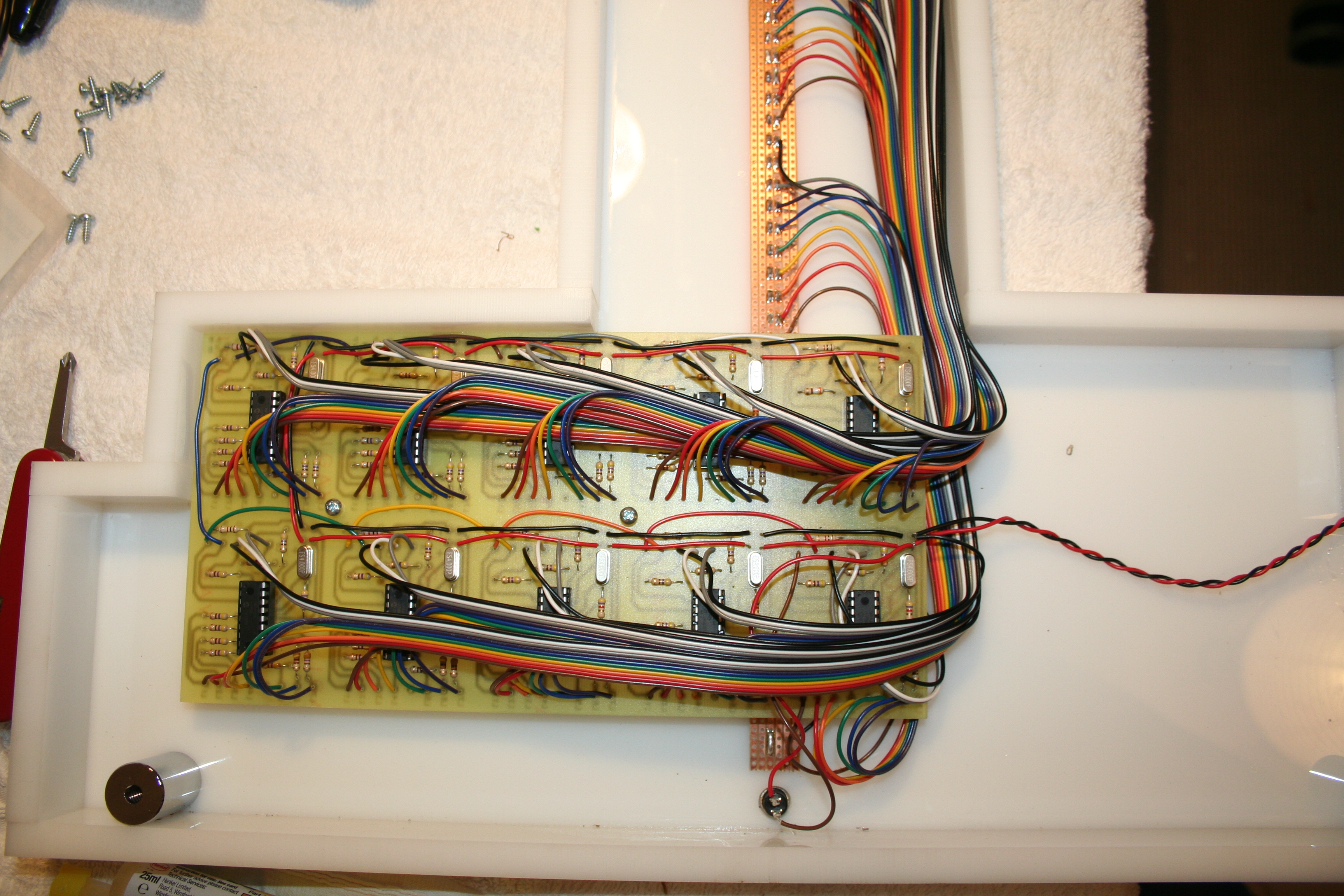

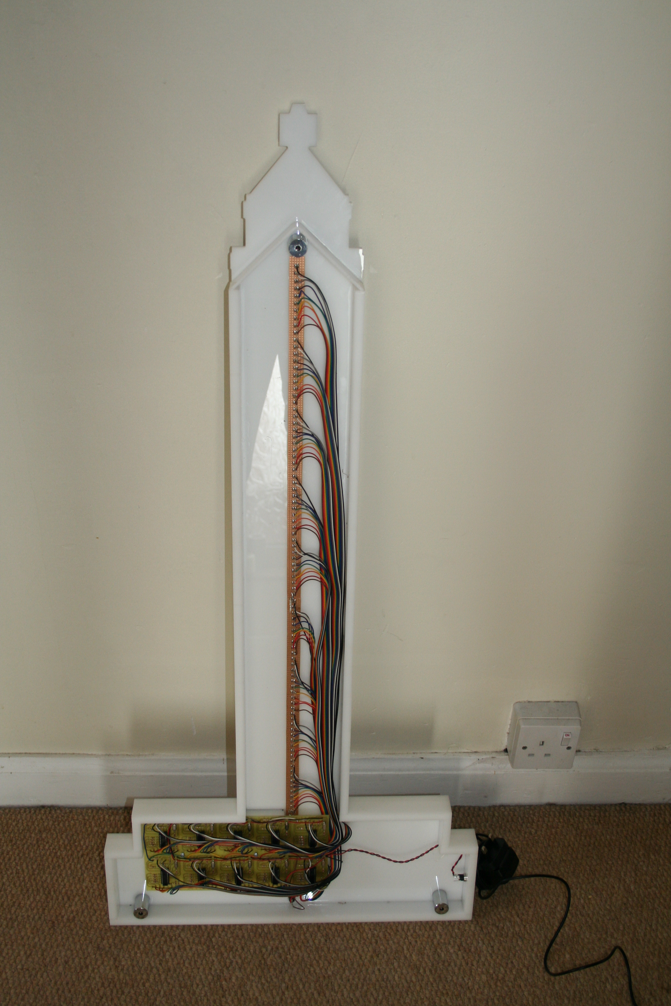

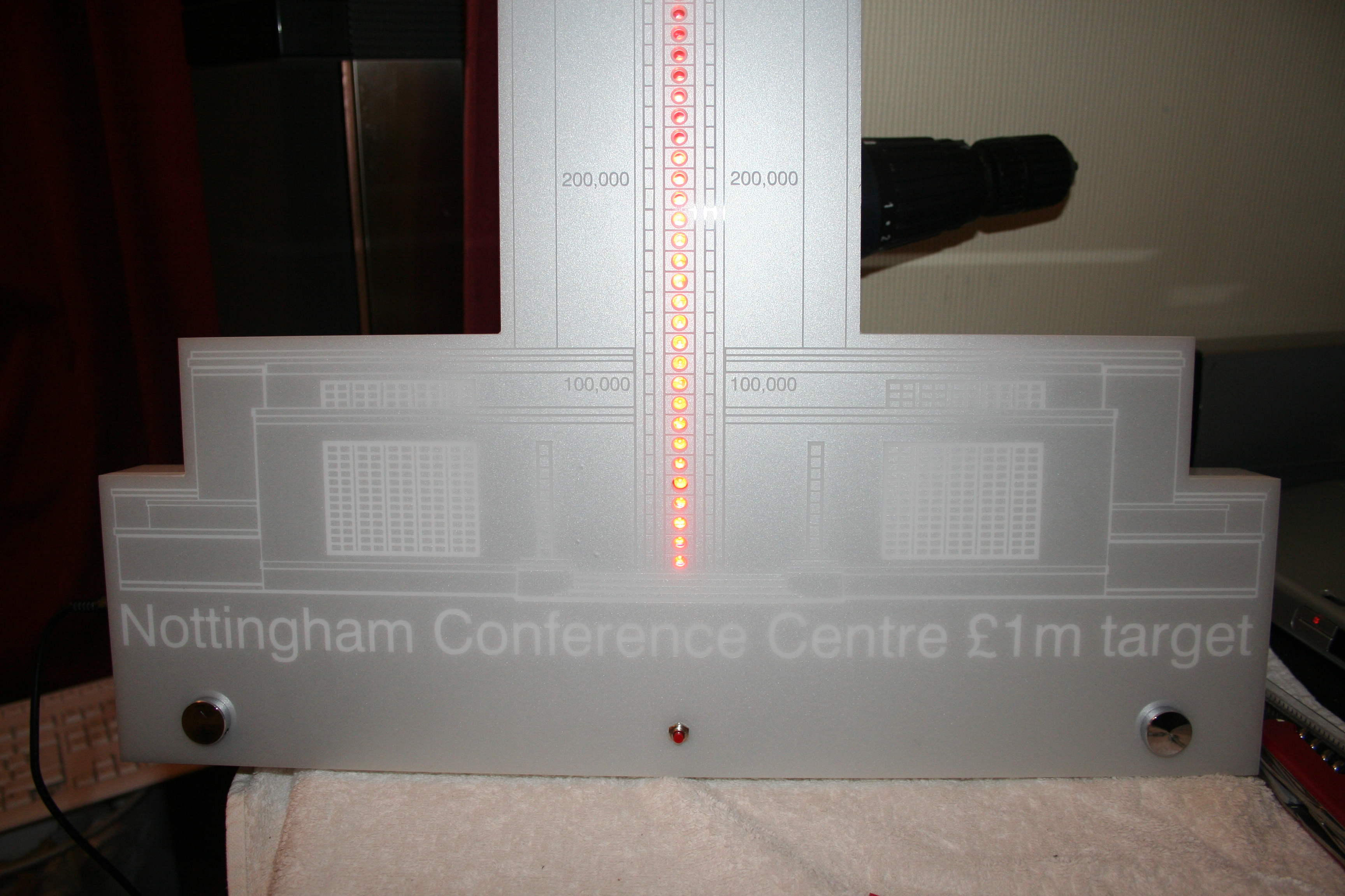

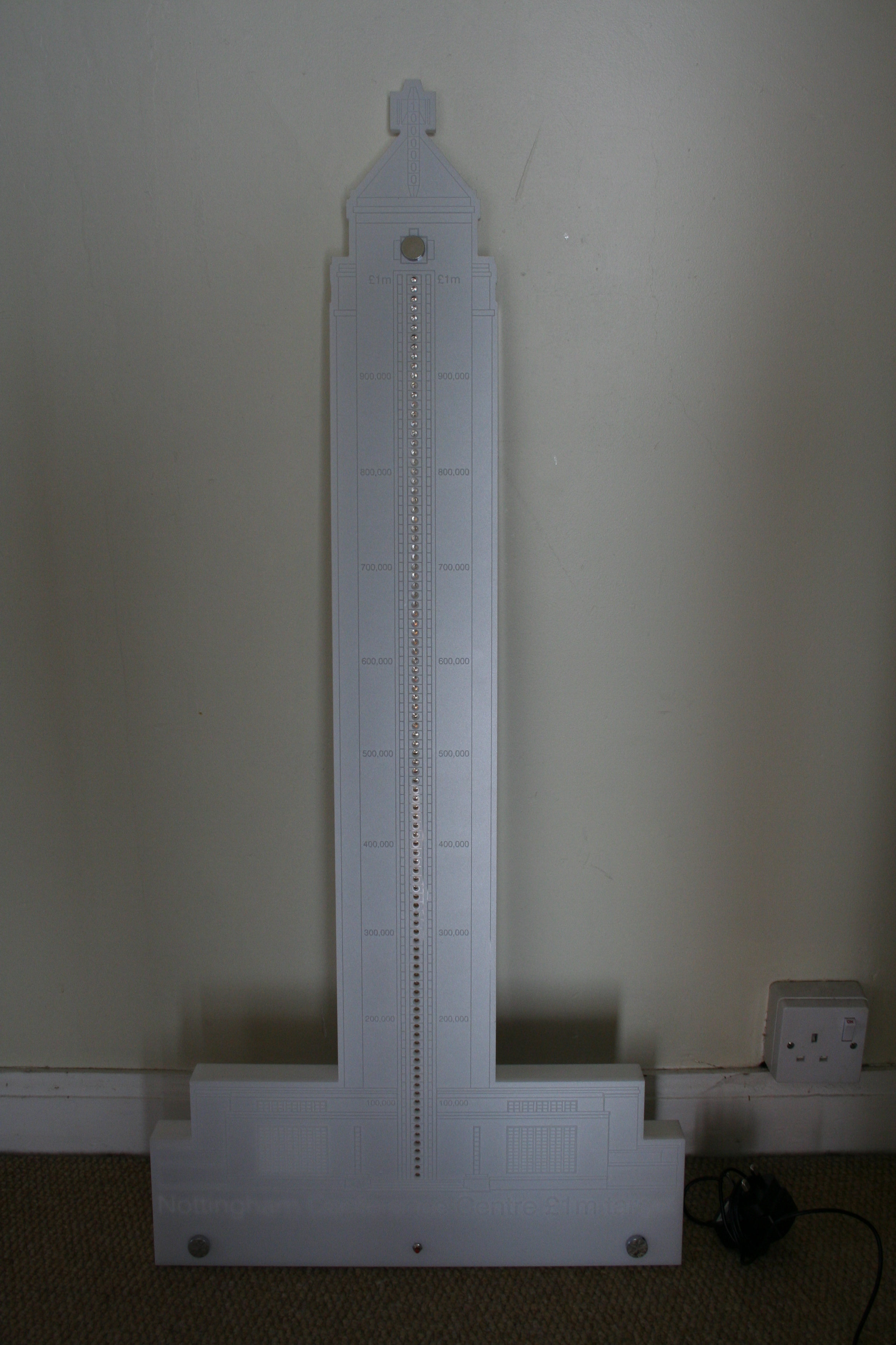

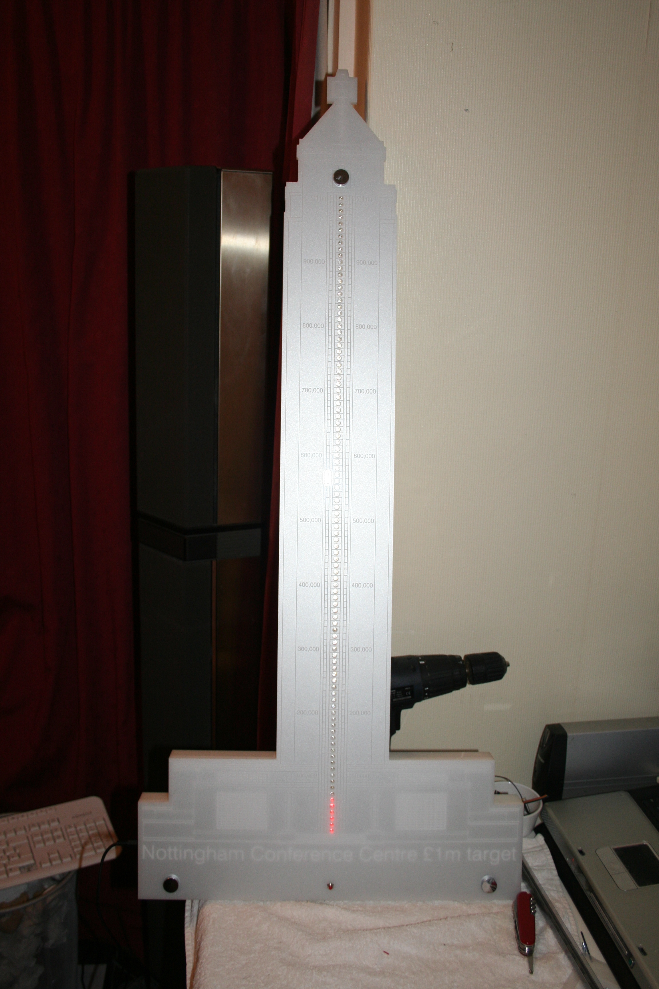

As promised here are some pictures of the finished thing. Managed to get it finished in time after a very late night putting it all together on Thursday, amazingly it worked first time and I only had a couple of dodgy soldering joints on the LEDs to fix.

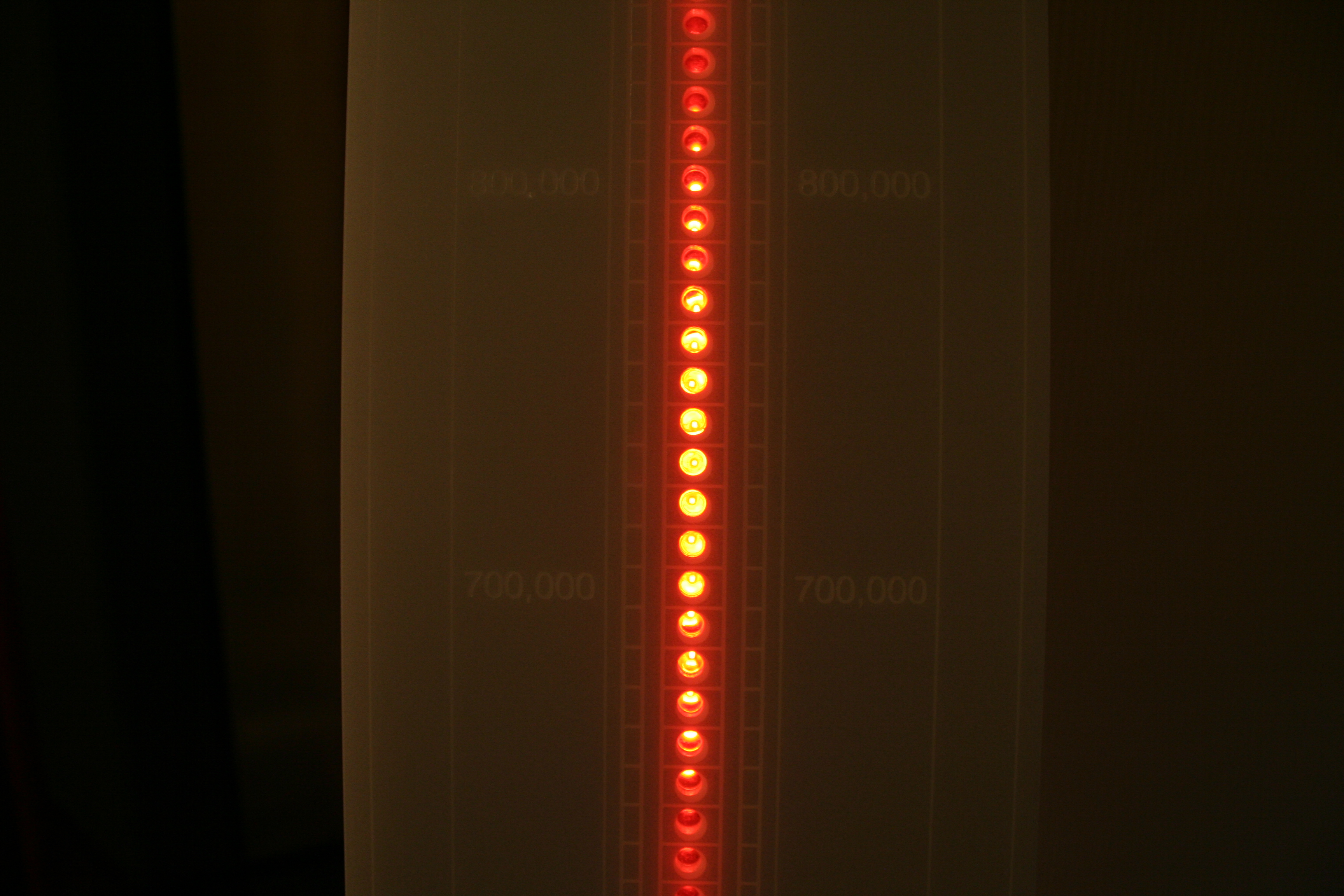

I notice that the LEDs have a very narrow viewing angle.

How tall is that SB1 rocket?

nice looking project. still think bargraph leds would have been better.

Haha! I thought it looked a bit "Empire State" until I read the Nottingham conference centre bit down the bottom.

PICs are cheap, if the quickest way to a solution is 10 of 'em, I say go for it. If you did it with 1 PIC then you're talking a slew of driver and gate ICs and probably more work than just hooking 10 PICs together.
They're in sockets, so after the sales target is reached they can be pulled and used in other projects. Or cut up the PIC board and use them in 10 different projects.
I hope they didn't use 20 MHz crystals for the PICs. Now that would be overkill. Heck, they could have just used the PIC's internal oscillators.
