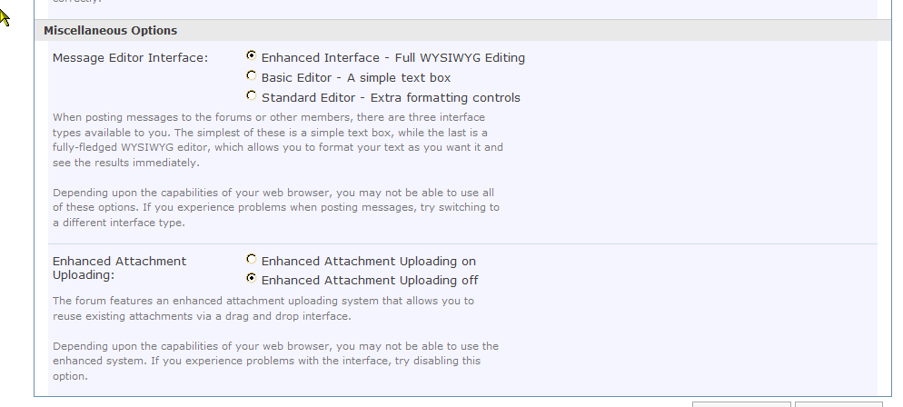

You only get that dialogue box when using Firefox or Iinternet explorer, clicking on **broken link removed** in Opera just generates image tags. Pasting a file name and path on your computer into image tags doesn't work.
My General site editor settings are:
I've just edited my post to add more information - I tried it using Firefox.

I've had a look in the settings and the settings are the same, except I have Enhanced Attachment Uploading on and you have it switched off but that shoudn't make any difference to the editor.
Either way, even under Firefox or IE, it's still not possible to simply type image tags and paste the path and file name into the editor, you need to properly upload the file in order to attach it to a post.

hero,
I am using this IMAGE Icon, I just click it, it places IMG tags on the post and then asks me to browse my PC for the image, which I then unload.

It doesn't do that for me because it isn't supported under Opera, I just get a dialogue box asking for the url of the picture, typing the a path of a file on my computer doesn't work, it only works for files on the Internet.

It makes no difference to me whether I used the advanced or quick reply button.
I do normally use the manage attachment button. I'm just pointing out that image tags only work for file hosted on the Internet. The insert image icon does more than just insert image tags when you ask it to upload a file, it copies it to the ETO server, then inserts a link to it in your post.
