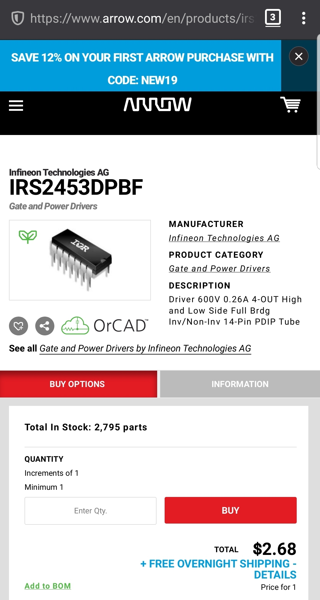

I would like to build the H circuit but the IRS2453 is $15 for 1 plus postage in USA but only $1.84 from China it takes a month to arrive. It seems to me the 555 master & slave flip flop circuit can be used with 10% off cycle between each one so they can never both be on at the same time.
For the large MOSFETs (high gate charge) and frequencies I imagine you using, the 260mA gate drive current of the IRS2453 does not seem anywhere near enough
