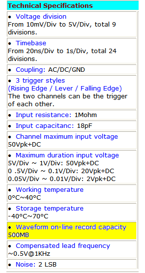

What do you suppose this means? (see area highlighted in yellow)
Means absolutely nothing as far as the DSO's features go.
It's the PC's software limit for storage of received information.
