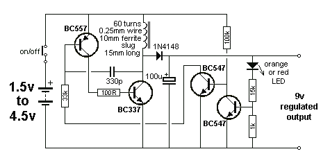

No problem mate, and i got a schematics from collin's site here, does it work? And how much current will be reduced from 750mA while it outputs 9V?
The inverter circuit shown above is only good for 20mA ouput.
For every 10mA output, the current from the battery will be about 40mA.

You modified that circuit. But the schematic you keep posting is the wrong original circuit with 3 transistors so you are confusing everybody.
I posted a circuit with a single transistor that I guessed is the circuit you used. Please post your accurate schematic.

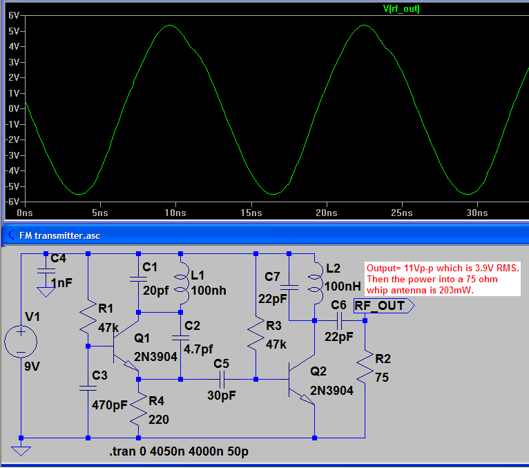

I simulated my FM transmitter RF section:
1) With a 3V supply the output is 3.2V p-p and the power into a 75 ohm whip antenna is 17mW.
2) With a 9V supply the output is 11V p-p and the power into a 75 ohm whip antenna is 12 times more at 203mW.
Can you measure the current draw? Or, maybe since he has modeled it AG could give it to us so you would know how much the converter needs to supply.
