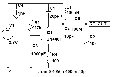

No it is not. That circuit does not work. Z!dd!k said he modified it: "i changed the 2nd transistor with s8050 and removed the final amp transistor, and replaced the v.cap with a fixed "15pf" cap, finally the emitter resistor of 2nd transistor replaced with 100ohm, that is all i modified".
I posted a simulation that might be his modified circuit except I used an American transistor instead of a cheap Chinese one and I added 5pf of stray capacitance to the 15pF fixed capacitor.
The oscillator does not oscillate when a 75 ohm 1/4 wave whip antenna is connected to the collector of the oscillator. Maybe he connected the antenna to the emitter.
Here is what I think is the circuuit Z!dd!k used:

ok, as the arrogant audioguru posted a schematic, i assume that this is ziddik's circuit collin, now please post a boost conv for this

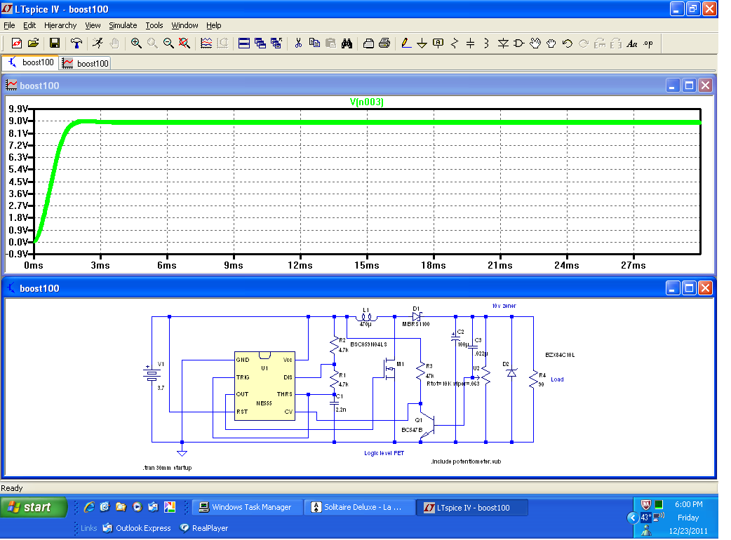

Boost
Here is a circuit for a 100 ma discrete boost converter. It's not the best, and I have not built it but it looks okay. There are lots of single chip solutions out there but if you can't get them maybe this will work.
But the minimum supply for an ordinarey 555 is 4.5V. His 3.7V Lithium battery cell drops to 3.0V during is discharge.
