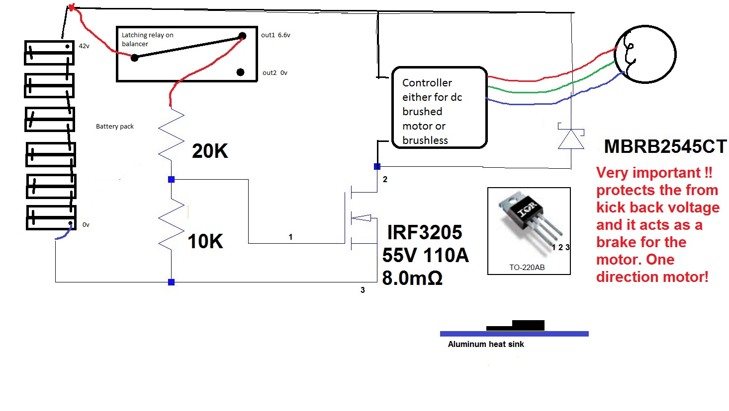

42v to 12v
it would be wise to find a 60volt
added to your schematic, one IRF3205 110 amp 55 volt FET should handle your load, voltage divider will spread the load over the whole battery stack. If your equipment has an adequate piece of metal to be a heat sink, you can mount the FET to that and insulate it if needed or mount to FET to a store bought heat sink or use piece of aluminum plate, I use alum channel fairly often.View attachment 100997 here's an example of using a piece of alum channel as heat sink and conductor that is isolated from the body of my vehicle.View attachment 100996
the diode across the motor is for transient voltages
you will also need this or similar
ebay to220 insolator
YES!!!, THIS CIRCUIT WILL WORK! at 42 volt on the battery, you will have 1/3 of that voltage on the gate, 14 V , as you battery discharges down to 36 V you still have 12 volts on the gate, at 30 volts, that's 10 volts on the gate, if you use a 15K instead of 20K, you'll have more to the gate, I thought about a zener, but I don't think that's a good idea for when you need to turn the fet off. If your bike is brushless, you may not need the diode, I can't speak to what kick back you get from brushless motors or what type of regeneration they produce, if any. Brushed permanent magnet would regenerate and the diode would cause it to brake, it's there to shunt the transient voltages and protect the rest of the circuit2.
The circuit won't work.
and just WHY won't this work? How much real experience do you have using high current FETs? I've been playing with IRF3205 fets for a couple of years now.
SimonTHK, one problem I forsee is lack of any throttle, as drawn, it's all or nothing, unless there are things you have divulged.
My son has a 24v scooter for his kids and someone took the controller out, so we had to make another
Thank you Kinarfi, I will try this circuit for sure, I am gonna order the component´s.
The LOAD is actually the controller, which then drives either a brushed or brushless motor. Since it has 3 wires I can only guess it is brushless at this moment.
I dont think the mosfet and the diode will be a problem (braking wise), since it is continuously open at all time, , unless battery gets low in voltage.(do I even need the diode then?,I need the mosfet only to act as a relay). The latch relay only turn off, when the voltage gets low on either of the 12 cell´s, using a https://123smartbms.com/ balancer.

I mistakenly thought that the gate voltage was 6.2V. However, working with 42V, at what point will the mosfet turn off? It's guaranteed to fully turn off at Gv = 2V (Battery = 6V!!). However, what about when the battery is at 13.5V and gate at 4.5V. Referring to the chart above (from datasheet) the current will have dropped to about 8A and the voltage across the mosfet will be 10 - 20V. That's 80-160W and that is enough to melt the mosfet.
I would be very interested to see your calculations.
The circuit will work, at least for a while. But I doubt that it will be reliable over time.

Hi Chris
I did write 50 amp, but it draw really more like 25 amps as an absolute maximum peak, and 15 amp continuously as an absolute maximum continuously. I did write 50 amp for the same reasons as why you use more mosfets :)
Could I use the IPP045N10N just to replace the IRF3205?
Could I use 2x IRF3205 in parallel, having 2x110 Amp to draw, with only now 25 as max drawn, that will only draw 11,3% of the allowed 220 amp.
I can get 50 pieces of the IRF3205 for only 9 bucks, free shipping.

Jeff, how much of your experience has been at 42 Volts? Or has it mostly been in the 12 volt neighborhood?
At 12 Volts, a 55 Volt mosfet has a safety margin of over 300%. But at 42 volts, that same mosfet only gives you a safety margin of 30%. It may still be OK, but will require a lot more care in managing transient and inductive spikes from the motor and connection wires.
Also, you refer to a motor controller. Is there another thread from Simon saying that there is a downstream controller in his system? Or have I somehow missed a post from him saying that there is one. It may be a mistake on my part, but I have just assumed that the relay or mosfet switch was connected directly to the motor.
But, if there is a motor controller, why not just use that to turn the motor on and off? Why would he need to switch the power into the controller on and off? Also, switching the input power for a controller would probably need to be done on the high side, which requires a different mosfet circuit architecture.

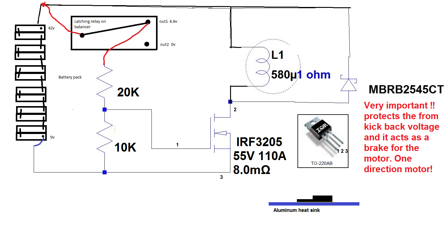

ChrisP58, go back to post 45, it appears that Simon went back and edited and added a drawing, I went through the back posts to see where he said he had a controller and saw stuff I hadn't seen before. I guess that's one of the problems with editing post a day or two later, I've read it an moved on, so I usually don't go back and catch the edit.
You are correct! most of my experience is at the 12 to 15 volt range. but the current often exceed 20 to 50, and more and since I often crush the blown FET in a vice to get the 'face' off I have seen a few where the glass in the FET had actually melted, cool! or I mean HOT!!! :)

I visually skimmed over this the first time through, this time I read it more thoroughly and mentally skimmed through it, because I realize that these do fry at high currents. Have you found where it says
ID @ TC = 25°C Continuous Drain Current, VGS @ 10V 110 5 in circle which refers you to:
Calculated continuous current based on maximum allowable junction temperature. Package limitation current is 75A.
So what ever the current rating is, it refers the silicone, not the leads and case, which are only good for 75 amps.
I've always worried about pushing that much current through one of those leads. It doesn't seem right!! I once had to make a 220 amp fuse and all I had use was a strand of #12AWG copper wire. I worked, I had to replace it twice before I found the problem that had blown several other fuses, Note, This fuse was a REN, which means the element can be replaced. Makes you wonder what would happen if you did run 100 amps through a well heat sinked fet, I have the soldered on hook up wires melt the solder let go.

Hi Chris thank you
The mosfet is controlled by a smart BMS system, that manage battery pack. The system turn on/off when it acces load or charge. That is why I need it.
Jeff
When I read datasheet about IRF3205, it says that it has power dissipation of 200 watt. Does this mean that this is the maximum power that can run through drain to source? That would be 200watt/42v= 4,76 ampere?
If you mean that there was 42 volts betwee source and drain AND the current was 4.72 amps then the answer is YES. I don't think this is what is happening in your application. (I am guessing as you have still not given full details of what you are doing.) I think you are using it as a switch so when it was off (Source to gate voltage zero) then there would be 42 volts between source and drain but no current flowing so there would be no power dissipated. When it is on I am assuming the source to gate voltage is well above the threashold voltage (Say about 10 volts.) then the source to drain resistance will be some low value. For example if it was 0.1 ohms the with 4.76 amps flowing there will be 0.476 volts droped which will mean the power dissipated would be 4.76 x 0.476 = 2.27 watts. You can find what the source to drain resistance will be from the data sheet.
Les.
Les.
Thank you very much for this explanation. I have to write down my little own notes on how mosfets work :)
The resistance is 0,008 ohm. So that will with 25 amp be 0,2v. 25 x 0,2 = 5 watt. Seems doable J
Greatly appreciated
