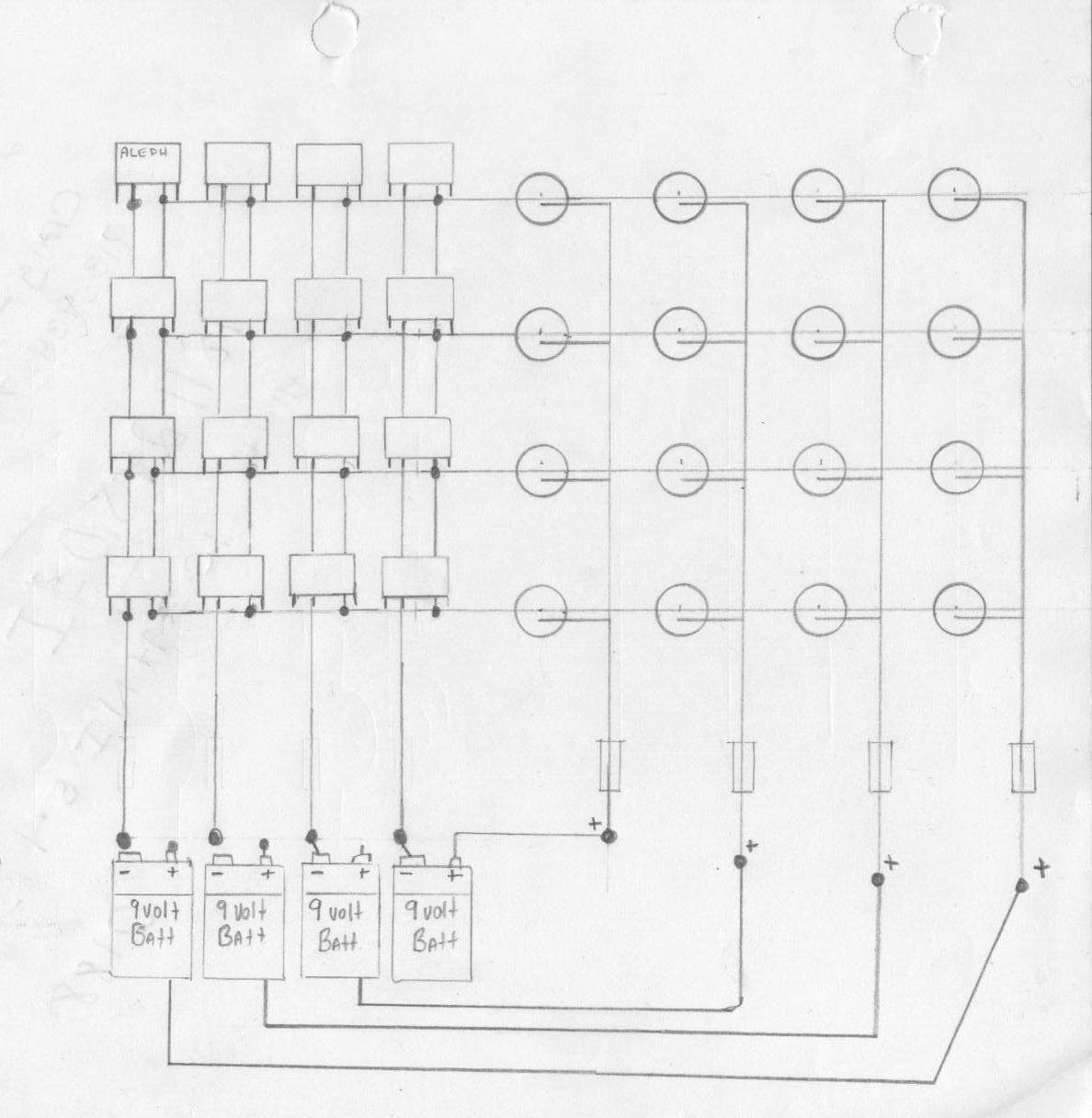

I AM TRYING TO ACTIVATE 16 RELAYS WITH A 4X4 KEYPAD MEMBRAIN AND I AM TRYING TO ELIMANATE THE USE OF 4 SETS OF 9 VOLT BATTERIES. I WOULD LIKE THIS TO COME FROM ONE POWER SORCE OF 9 VOLTS

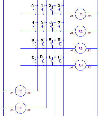

Make sure to remove R8 (put short) and replace other resistors with relays. Each output will require two relay contacts in series.
Since each button will turn on two relays (the coils will be in series)
power supply should be for ca double of the coil ratings.
Single 9V battery should work with 5V relays.

if you could be happy with only two batteries,
i sort of feel you could halve the matrixing
by feeding through two diodes, but i haven't
thought it through yet, but give it a think ...

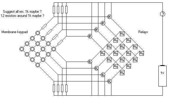

but i did come up with this possibility instead.
The transistors used would be four PNP and four NPN.
They don't need to be 'matched' just similar.
The resistor values are just guesswork, maybe the
middle resistors could be a bit higher.
But they should work ok as shown, i think.
As shown, a little current would also travel in
adjacent relays when one is operated, but it wont be
much.
If that bothers you, you could fit diodes on each relay.
I don't know what operating current your relays are,
you would have to choose appropriate transistors.
Notice that two transistors in series operate each
relay, so the transistors have to be good enough to
do that.

If the relays are very small,
it's possible they could be driven straight from TTL,
which might make for a simpler construction ?

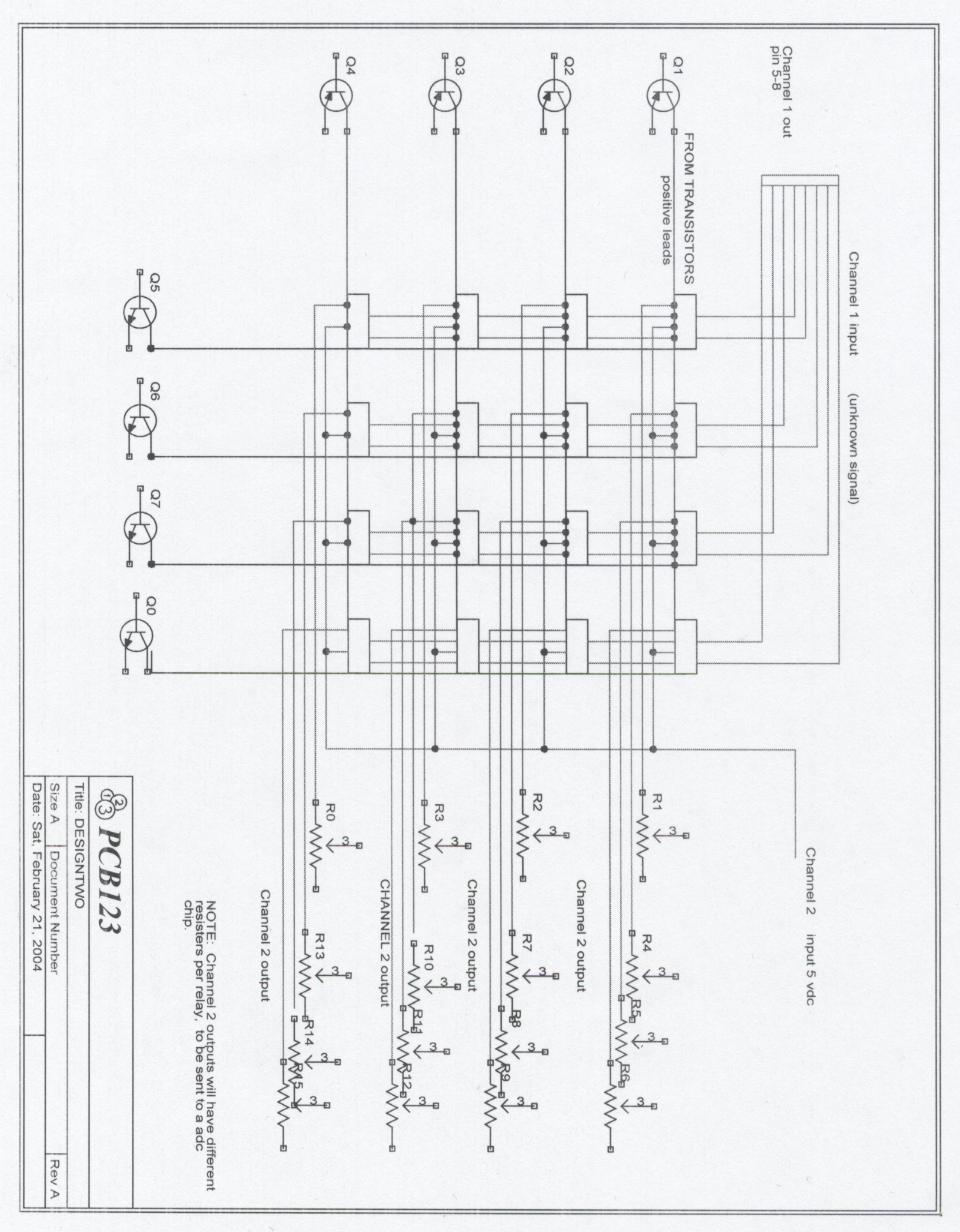

john1, Your circuit is pretty. Maybe if we know, for what application need this conversion, we can give more help. E.g.: if need only the conversion from matrix keys to 16 outputs with common GND, optocouplers also a solution with lower price...
Thank you for the compliment.
Your point about the common ground is well taken.
If the relays needed a common ground,
then clearly that circuit would not do.
However in the first post it looks like
a common ground was not needed.
That circuit looks very interesting,
but i can't quite follow it,
maybe theres some missing ?

I tought this is self explanatory but let me try to explain.
The drawing was done in hurry so I left the switches out
because they are integral part of the 4x4 matrix.
So there are 16 of them (4x4=16) and they are wired to
intersections of rows and colums. For example membrane
switch in upper left corner of the matrix is connected to A2
terminal of R5 coil and A1 terminal of R1 coil.
Vertical line connected to A1 of R5, R6, R7 and R8 is positive
rail (+9V for example). A2 terminals of R1, R2, R3 and R4 are
connected to negative rail (0VDC for example).

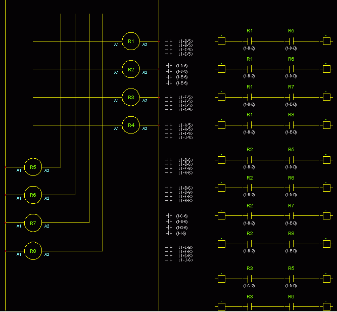

When first membrane sw. ("0") is pressed, current flows from
positive rail through R5, through switch and through R1.
Yes, R1 and R5 coils will be in series.
If you want 9V power, use 5VDC relays because coils are in series.
To control something, just use contact of each relay in series like
the first branch in the upper right corner.
You have there pair of terminals going to whatever you want to
control. Between the terminals you have contacts from R1 and R5.
So button "0" will activate R1 and R5, and output "0" has contacts from R1 and R5 in series.
So button "0" will activate R1 and R5.
Output "0" has contacts from R1 and R5 in series.
Button "1" will activate R1 and R6.
Output "1" has contacts from R1 and R6 in series.
Button "2" will activate R1 and R7.
Output "2" has contacts from R1 and R7 in series.
Button "3" will activate R1 and R8.
Output "3" has contacts from R1 and R8 in series.
Button "4" will activate R2 and R5.
Output "4" has contacts from R2 and R5 in series....
I hope this explains it. This is not the silver bullet for matrix keypads.
Scanned matrix is much better of course because there are no
problems when multiple buttons are pressed. I've posted it simply
to demonstrate that it is possible to make circuit without active
components.
