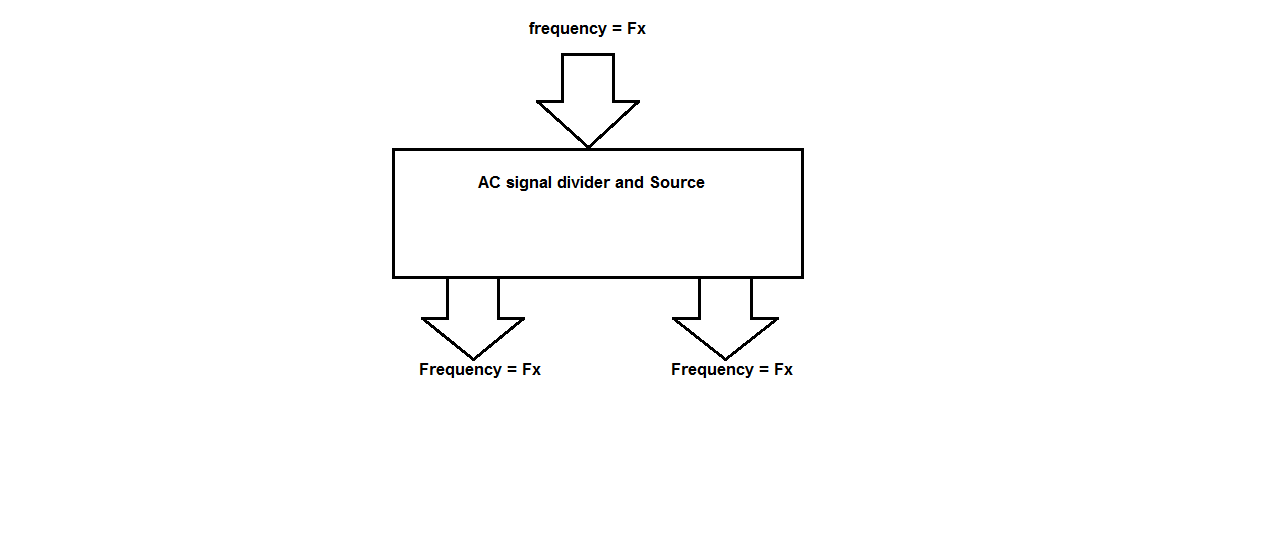

Hello people,
I want a device/Circuit which can make 2 AC signal source from one , with same amplitude and frequency. which can be used for two different circuits.
The problem i have encountered is that i cant make two independent AC signal out of one but merely deviding them on two different wires. if one signal encounters some load thn it will interfare with other siganl and even its mother signal.

I want to duplicate AC signal of 4V pk to pk power with 10 to 20 KHz of freq. from its mother signal
I didnt understand anything please post a schematic.
Two op-amps with a gain of 1 used as buffers? or even just a single op-amp with a low output impedance.

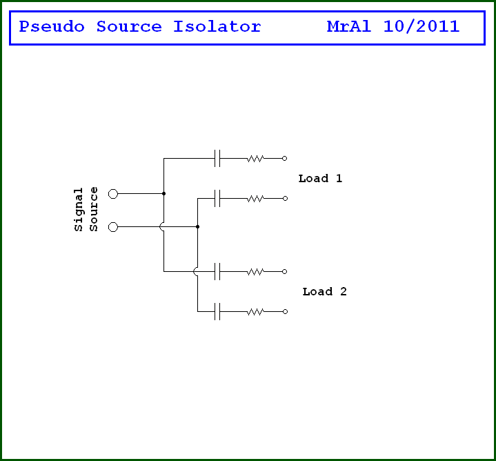

Here's a drawing...
Excuse my naiveness, but i see 2 signal input and 4 output.
is there something i am missing
The lower lead of each output goes to load ground of the respective load, and the upper lead of each goes to load signal input.
You wanted to split the signal so you have one source and two loads.
pls check is this what you are talking about !
  • AC devider.asc
No, something like the attached was intended. B and D are DC-isolated virtual grounds. I have simplified MrAl's circuit by removing two redundant resistors.

Hi again,
No not exactly...here's the correct drawing. Note that none of the resistors are redundant in the practical circuit unless you have special circumstances.
  • ACdivider2.asc

Hi again,
If the load resistors R5 and R6 are not comparable to the series resistors in each section, it could appear that the AC current level does not change. Give different value series resistors it would change significantly if the capacitors were comparatively high in value too.
If you find you get too much loss you may end up using a buffer anyway. If not, you're good to go :)
