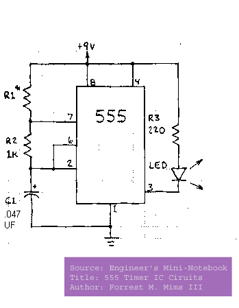

I'm working on an IR beam break system right now.
I have modulated an IR led with a 25/26kHz square wave from a 555 timer. I'm not sure how to make a filter for the receiver though. I would like to make a passive RC filter. The square wave turns the LED on during negative pulses.

Hi Zach,
A simple coupling cap feeding a resistor to ground will make a highpass filter so that 120Hz from lightbulbs doesn't activate the IR receiver. A passive bandpass filter would be lousy and have a high loss.
I don't remember the schematic of your IR receiver that might not respond as high as 25kHz anyway. Many people around here think they can use a low-bandwidth LM324 or LM358 opamp for high frequencies. :(
Its not only the 120hz. Its the sunlight also. The receiver will be in direct sunlight.
Im sure I could make the frquency lower.
