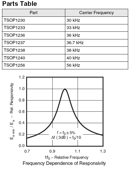

Although I haven't tried it, I thought that sunlight has much more IR energy than an IR LED, so would drastically affect an IR receiver.
The datasheet for Vishay's improved IR receiver module shows that its sensitivity reduces to less than 1/10th by its AGC during high ambient light:

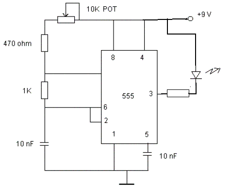

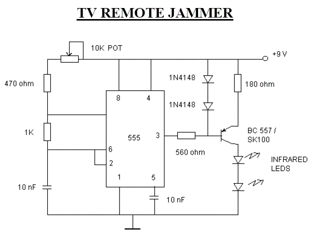

I made this circuit accept for the LED is directly off pin 3 without the transistor. I know it's bright enough because I tried a regular LED and it was plenty bright.
I cannot get the output on the IR receiver to go low with this circuit though. If I turn the 10k pot fast, I can see the output go low very quickly and then return to normal. If I turn it slowly though, I cannot get the output to go low at all. I am very confused!

Hi Zach,
If you are using an IR receiver IC, it won't work unless the carrier frequency closely matches the frequency of its bandpass filter:
That's a pretty sharp bandpass filter.

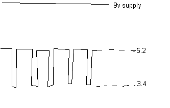

I think I figured out why it's not working. On my oscilloscope, I realized that the LED is not turning all the way off. Look at the picture of the square wave. Since the LED is connected to pin 3 and the +9v supply, the lower pin 3 goes, the harder the LED is on.
I am getting 3.4v low peaks, and 5.2v high peaks. Even at 5.2v, the LED is still on because the voltage across the LED equals 3.8v, plenty to turn it on.
Yes, I know this is strikingly obvious, but I just got my oscilloscope and am getting used to it, and this is my first 555 project. So what do you recommend I do?

You don't give any indication where you have the scope connected?, nor what value the resistor in series with it is?.
If you want a proven working IR LED driver, try checking the hardware for my IR PIC tutorial - it could be fed from a 555 just as well as a PIC.
Oh yeah :roll: That would help. My scope is connected at pin 3.
I want to use the 555 because I already have it and I won't have to buy a PIC, and wait a week to get it.
Hi Zach,
A 555 couldn't be that bad. You don't show a very important supply bypass capacitor so I suspect that the LED is drawing a high current that is causing the 9V battery voltage to drop a lot. Scope the battery's positive voltage to see if it has any ripple. Adding a 0.1uF ceramic disc in parallel with a 10uF electrolytic caps mounted very close to the power pins of the 555 and the LED should fix it.
What voltage is the battery while it is powering the 555 and LED? Less than 7V?
How much current are you drawing through the LED? More than 200mA?
Hey audio. That didn't work, so i rebuilt the entire circuit and it worked :roll: . I think that I didn't have pin 8 connected :lol:

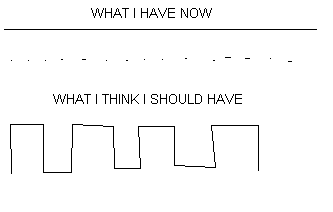

anyway, one problem solved. Another thing that I am wondering if it is a problem is that the pulses are extremely narrow on pin 3. On my scope, i basically see a straight line with little dots under it. Its a square wave, but like I said, the negative pulses (relative to +9v) are extremely narrow. Shouldn't they be even?
Look at the picture.

Hi Zach,
A 555 works best with its power supply pin connected, doesn't it?
The timing cap is charged by 1k plus 470 plus maybe 5k from the pot = 6.47k ohms. But it is discharged much quicker by only 1k. If you increase the 1k to 4.7k and turn-down the pot so the frequency is the same then the timing cap will discharge half the time it will charge. Good enough. :lol:
I sort of got the pulsed IR LED working: I put it right up next to the TV and the TV got jammed, but it only worked close up. I think my problem lies in the IR LED. Gonna get a new one.
