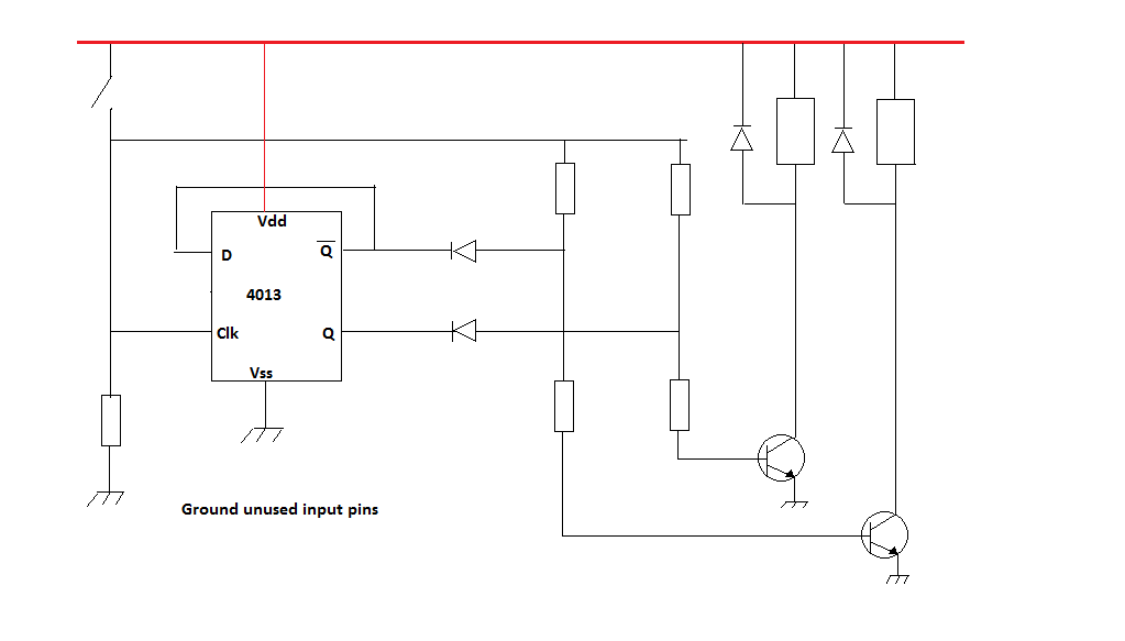

In the attached circuit, the relays are driven by CLK "and" Q , Clk "and" Q'. The 4013 changes state when the clock goes H but the turn on delay of the transistor and relay should prevent problems.

What resistor values did you use ? To solve this problem, replace each of the lower resistors connected to the base of the transistors with two 1N4148 or similar diodes in series and add a 10k resistor between base and emitter of the transistors.

Did you ground all the unused input pins ? The truth table in the datasheet specifies that both Q and Q' will be H if both Reset and Set are H. The following pins should be grounded : 4, 6, 7, 8, 9, 10, 11.
What are the voltages on pins 1 and 2 ?

Hi willeng, this is how the circuit works : when the switch is pushed, the clock line goes high and changes the state of the 4013. The clock line also provides voltage to the two top resistors that supply base current to both transistors.
One of the 4013 outputs will be low and the other high
The diode that is connected to the low output diverts the current flowing through the top resistor away from the transistor base, into the output of the 4013 so the transistor is not turned on because it's base current has been "stolen" by the ic.
The diode that is connected to the high output is reverse biased and does not affect the current flowing to the base of the other transistor which turns on.
The diodes and resistors form a simple AND gate so they must be connected as shown for the circuit to work (diode arrow pointing to the 4013 output).

willeng, please check out the pin connections for the relay you are using. On the diagram you attached, the relay contact connections are not correct. You should use the common and normally open terminals. The common terminal is between the two coil terminals.
