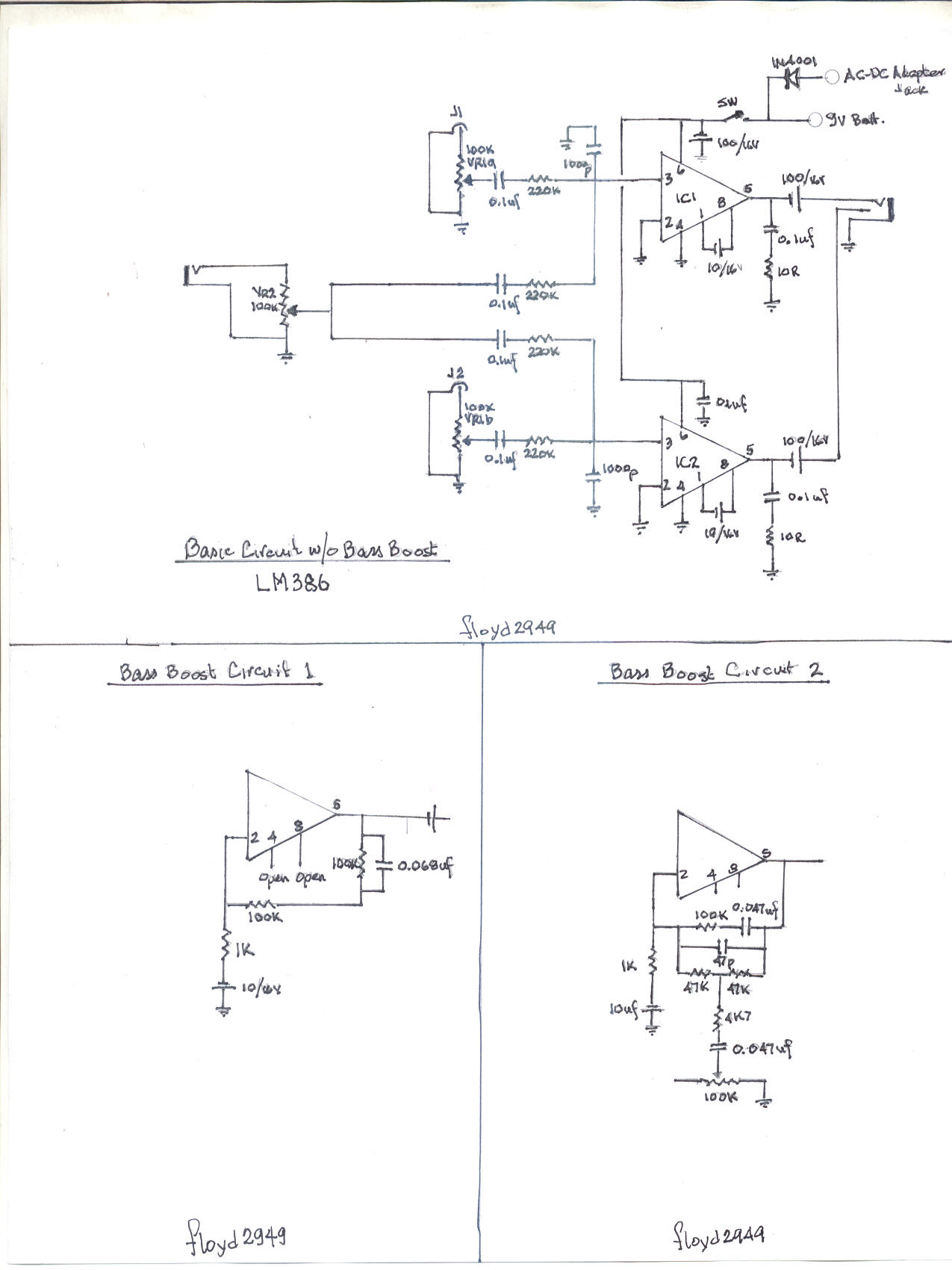

i am interested in making a small amplifier, much like the smokey amphere, small enough to fit into a cigarette box, and obviously the circuit has to work on a small speaker, say .5w, i was wondering how i could lower the output of a regular amplifier circuit so that it gives off around .5w so that i can use a smaller speaker, and prferably run it off a 9v battery.
any diagrams would be helpful
thanks
Looks like you search for a LM386 application:
Its a nice low power amp and the circuitry is very simple ...

heres the simple circuit diagram of the mini guitar amp, any questions pls feel free to do so thru my email add. :D

thanks for those lads, but does it say on the LM386 what type of transistors to use? i couldnt see it. and is there any way to add some nice tone potentioometers to the circuitry of your circuit mozicluv?

:D hey erp,
there's no need for the transistors, the lm386 will do the job as a small guitar amp. as you can see on the schem there are no transistors involve.
the other amp which i was talking is another amp operating at 6v. am not recommending this as a guitar amp. you may use this on other audio purposes and besides i have not tried it as a guitar amp. you may try but you have to alter the input stage.
if you still want the circuit of this 6v amp 1.3w i can post it here. :wink:

guitar amp circuit
:D erp,
i'll try to find the sub for that, but for the meantime is KA2201 available in your place? :cry:

the smokey guitar amp has an overdrive to obtain those crunchy tones...i was lookin to make a little amp that runs off a 9v battery and has that gain, wattage isnt important aslong as the tone can be obtained...i can find a speaker to match.
Any help would be much obliged
