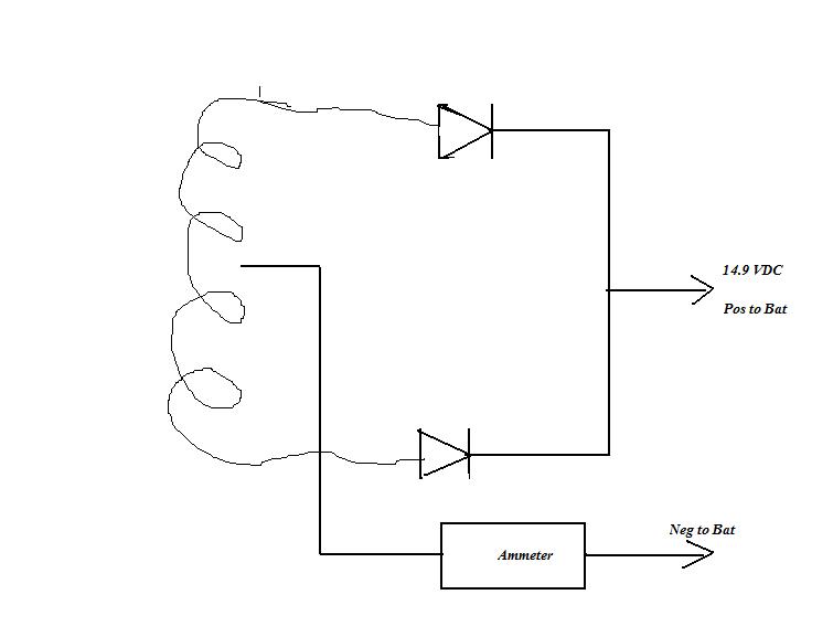

I have bypassed the cct board for testing so essentially, full wave CT rectifier and measured 12.6 volts with the primary taps I selected. I then connected a small lead acid battery (measured 9.6 volts before any charging) and the output then measured 15 volts. I expected it to increase gradually as battery charged....? Also, the ammeter in the charger indicated only about 2 amps....I expected more charging current due to differential so can someone give a brief explanation as to why voltage across battery increased immediately (meter averaging? ) and current is so low (is there a higher impedance in small batteries that limit current?)
The original cct bd was simple...cannot recall components and some were burnt beyond recognition but I am guessing a large SCR or transistor and a few small discrete components. Some of the circuits I see posted here ie Guleph cct (**broken link removed**), look quite complex. Any suggestions for a simple charging cct? Can I just switch (via Mosfet or transistor) the rectifier output to the battery till battery voltage comes up, assuming I have to stop charging to monitor voltage. This as a result of my tests today indicate that the battery voltage appears higher during charging than the actual battery voltage is? So, it becomes charge, stop and check voltage, if necessary, charge...repeat. If not necessary, just monitor voltage.....?
I have ventured into uControllers a little so thinking of using one but it seems overkill considering the original cct in this box.....and leads to including a +5 supply for it, etc, so simple gets complicated. I guess it is true that "simple problems bring complicated solutions" ....;-)

The AC voltage at the Diode Anodes is 29.8 volt and using the center tap, of course, 1/2 that so 14.4ish. this is the primary tap of the transformer that I suspect yielded the 10 amp 12 volt charge (switch has been disconnected years ago too...:-( )

ronv, the transformer is 29.6 volts with a center tap, therefore 14.5 either side. It is not a full wave but uses 2 diodes and the center tap so the voltage is <15 that supplies the charging. See crude drawing attached ;-) That might be called a full wave rectifier as technically it is, but it is not a bridge rectifier, I don't think. Never did know what this configuration is actually called. "2 Diode full wave", "Center tap full wave"?
The diagram is pretty much what I am working with right now and I want to come up with a simple circuit to replace the old one that burned up. If I am getting the jest of these simple chargers, then it should not be too hard. I think I was overcomplicating it. I am hoping for feedback as to if my understandings in posts #14 and #15 are correct, then I just switch the charge on and off according to the battery voltage. A uController could set full charge rate up to about 11 volts (80% of 13.8) then use PWM on the Mosfet to charge less agressively till Vbat=13. 8, then just check battery once in a while, like hourly? I think an 8 pin chip should do it with the right Mosfet, if I am on the right track....?
Don't be afraid to tell me I am still not getting it, my wife does it all the time....;-)
The centre-tapped circuit you have drawn is called a: FULL WAVE CENTRE-TAPPED DESIGN.
The way the circuit works is this.
[This has never been explained before by anyone.]
The circuit is classified as a TIGHT DESIGN.
In other words, the output voltage is very accurately determined (by the number of turns on the secondary) for the voltage of the battery being charged.
When a battery charges, its voltage increases and when it is at a point where it is fully charged, its voltage increases further.
The battery charger is designed to deliver say 5 amp when it is charging, but when the voltage rises to its fully-charged voltage, the current drops to less than 1 amp.
This situation can only be created by a “tight circuit.”
That’s why changing the rectifier from a selenium rectifier to silicon does will upset the charger, as will adding an ammeter or even adding long leads or altering the supply voltage.
A “loose circuit” is one where the output voltage of the charger is far higher than required and as the battery becomes charged, the current drops off very little.
