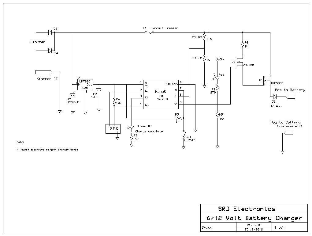

I have a bit of a glitch. In connecting the circuit to a battery and running off the charger, as the schematic is, I find that the voltage at the junction of R4 and 3 is 1.7 volts (much to high to enable charging), as it is seeing the charging voltage at the top of R3. I suspect that since the neg of the battery connects to the circuit only through Q1, it is not a part of the circuit till Q1 is on, but won't be on if cct is seeing open cct charging voltage (19+ volts)
I need to get the reference voltage but not connect the battery to ground....perhaps the mosfet being part of the neg lead is not a good idea....? Looked odd to me but trying to work with what stock I have....
Suggestion? I will look at moving the mosfet but to turn it on, I needed to have the source at gnd potential so having it in the pos lead is not possible, (I do not think) so perhaps it is the wrong component for this application?
What do you think? Am I missing something here?
I have attached a quick fix (read very quick sketch up) .....which I think will work since the charger voltage is substantially higher than the battery voltage.... but then upon connecting them, they become the same so, if so, how can I turn on Q1 in this circuit? Perhaps the only solution is a depletion fet?

Thats right you want to check it before charging.
If you are going to switch the high side a P FET is probably the easiest way to go.
Here is a schematic for a high side switch.
Another thing to think about is the ripple on the battery voltage. How do you plan to terminate the charge?
Also note the short glitch at turn on. This is from discharging the filter cap in the logic supply. Might want to "work around" this in your software.

That schematic looks good! The only thing needed is a small resistor on the gate to protect the micro in case the transistor shorts out. It would make the mosfet a little slower, but that won't hurt much.

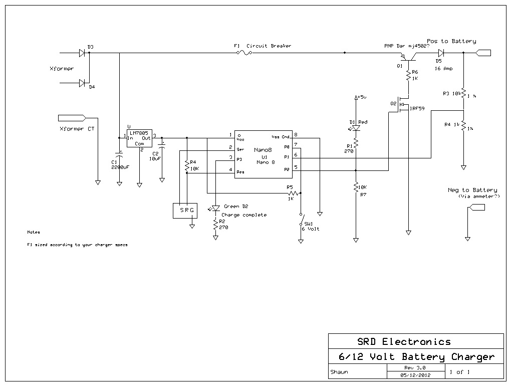

I have some power PNP's around here. What about using one of those? ie MJ4502 has a gain of 25-100. At 10 amps max charge rate, and a gain of 25, that means Ib of about 400 mA so Rb would have to be about 10 watts min but otherwise, would this work? Q1 would be on in saturation, if I do it right, so again, not much power dissipation, if I am correct....?
Twister, thanks for the input. I guess you are referring to Ron's diagram, not mine?..;-( yes, I am learning to trust Ron..
I will add the resistor to the gate leg in all my mosfet circuits now...good point. Never thought of a short situation. 1K? Thanks
Again, reasoning OK?
I also have 2sb337, ecg393, which have adequate collector current ratings...

The MJ4502 would work but if you look at the specs it drops 2 volts at the Hfe of 25. That would put the power dissapation at 20 watts which would want a Big heatsink. You could probably get away with say 600 ma of base drive and a .3 or .4 volt drop. I just noticed the 6 volt switch which brings up 2 things:
1- The current will be much higher at 6 volts. Is your transformer good for it? If so we need to shoot for more like 15 to 20 amps. This drives up the base current even more.
The FET is a much better implmentation just because of the power losses.
I modifies the simulation to reflect my guess at the 6 volt circuit.
I also change the 1K resistor to 10k and added a 15 volt zener so the gate voltage will be high enough to run from 6 volts.

It would be a good idea to know the peak voltage and the spec'd current at the 6 volts tap.
Absent that a 20 ohm 10W for the base resistor should do it for the 12 volts. Lets figure 8 watts lost thru the transistor. (.8 volts @ 10 Amps)
So to keep the transistor at 50C we need a heatsink of about 3 degrees C per watt. Thats about 45 square inches of surface area. Pretty big. Does the old charger have a big heatsink?

How does this look for output control?
Q2 will be a 2N7000 or similar, depending on what I have in stock. Maybe pull down resistor needed on pin 5? 1K value typical? I am thinking to prevent false triggers?
How does the rest of the cct look? See any glaring errors or poor practices? It seems to work, under test conditions, but wondering if you or anyone would have any suggestions?
I added a resistor to the controller output too, as seen in the schematic only.
I liked your first schematic here. You could drive the output transistor directly from the micro. if you exchanged it for a low on transitor, or if you put a pull up resistor on the gate and changed your micro to sink the voltage instead of sourceing it. I have no idea how you do that because I know very little about micros. You need to put a gate resistor on the base to protect the micro. in case it shorts. A 1K would work , like you said in your other post. Also you have to move the sense ground on R4 to the battery negative. The drain needs to connect to the battery negative, and the source to the charger ground. In the second schematic it looks like you have it connected to the positive, which will not work. Does the micro. put out a steady voltage or a pulse? I know that you are already going to use some P channel mosfets, as in ronv's schematic, but I have a lot of N channel mosfets and I want to make this circuit one of these days. I have been wanting to learn about micros anyway. Why did you choose the NANO8?

I made a couple of changes.
I think I had added the zener before just in case your input voltage is above 20 volts. I also made the gate drive resistors a little smaller to speed up the FET for your PWM.
I took out the big diode because it didn't really protect from a reversed battery. But, I added a small diode to clamp the a to d input to prevent it from going much below ground if the battery is reversed.
I also scaled up the divider to give a little better resolution and added a filter cap so you can measure average voltage. You could probably do lots of samples with the micro and average them but it's only one part.
I added Twisters resistor.
