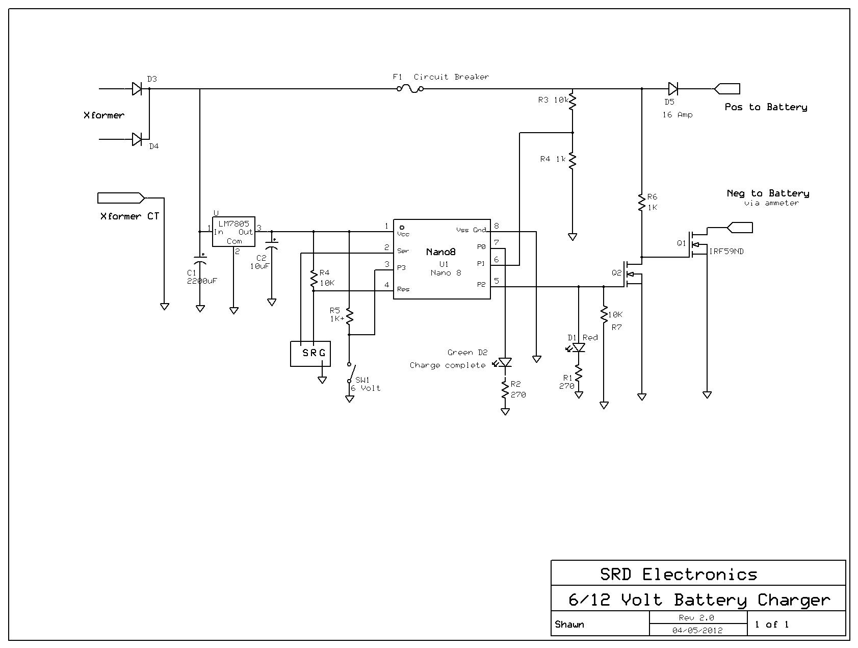

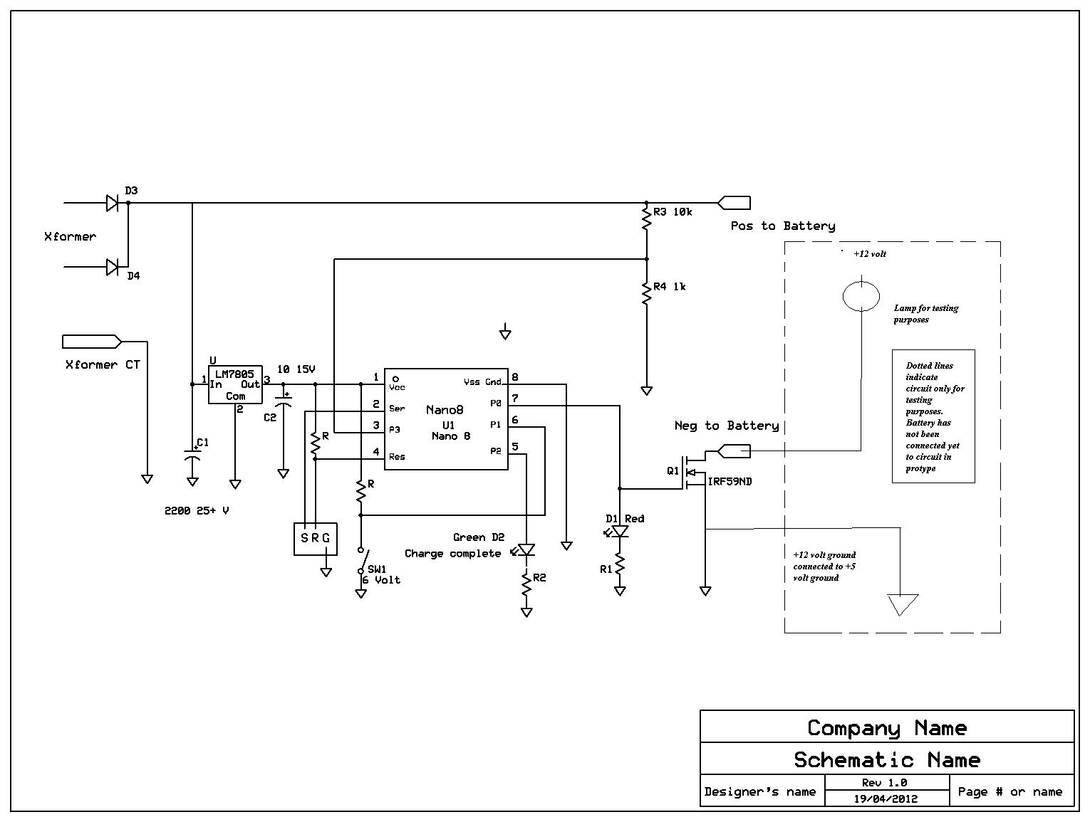

I have the programming done and the circuit drawn up and sort of built. I am using a 5 volt supply for the ucontroller and using a separate variable supply to simulate the 12 volt battery, thereby switching modes (full charge, partial and off) easily. It all works fine so tonight, I wanted to switch the Mosfet on and off. Till now, I have just been checking the output (Pin7 in this diagram although that has since changed) by monitoring D1 and a DVM.
I am having a problem turning the Mosfet (Q1) in the attached diagram on. In my test circuits, I have connected the 5 volt ground and the variable supply ground together. In the final circuit, of course, the 5 volt supply is part of the 12 volt supply so it is a non issue.
Any ideas why the mosfet might not switch? The mosfet is an IRF59ND.... https://www.electro-tech-online.com/custompdfs/2012/05/irfb59n10dpbf.pdf
It is a Hexfet and I am not sure what that means exactly. Off to google that I guess but will it not function as a normal Mosfet in this application?
Specs state Vgs of 3-5.5 volts will switch it and it is getting 4.8ish from the uContoller. I checked the D to Gnd and measured 12 volts (through the lamp) I also measured 12 volts from the source to the 12 volt positive so the wiring checks out.
I am no expert with Mosfets but did think I was getting a handle on them in this simple application but.....?

You need a logic level FET. This one has a gate threshold voltage of 3 to 5 volts but only at 250 ua.
Ahh. So perhaps switch it with another fet switching the 12 volt ...?

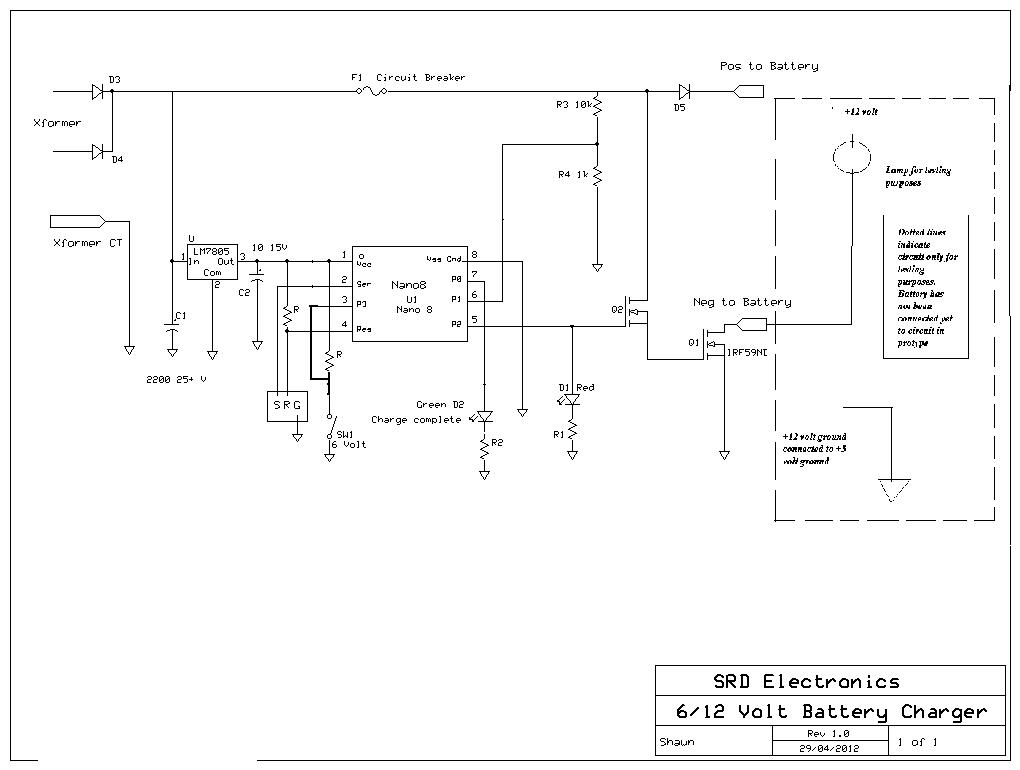

How does this look for output control?
Q2 will be a 2N7000 or similar, depending on what I have in stock. Maybe pull down resistor needed on pin 5? 1K value typical? I am thinking to prevent false triggers?
How does the rest of the cct look? See any glaring errors or poor practices? It seems to work, under test conditions, but wondering if you or anyone would have any suggestions?
I added a resistor to the controller output too, as seen in the schematic only.

Move the 1k (R6) to the drain side of the FET and take the gate signal from there. You will need to invert the signal in your micro. Right now it is a source follower ( kind of like an emitter follower) so won't work. There are versions of the 2N7000 that switch at a lower voltage that would be better, but the 2N7000 will probably work. If to have to order one look for the lower gate threshold voltage. Let me know if you have trouble finding one and I'll check it when I get back from golf.;)

I made the changes today and it works well.

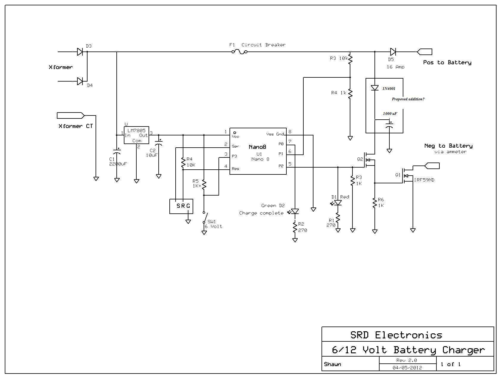

Hey Ron
I am looking for your opinion.....I was wondering what the effects of the pulsating DC will have on the operation of the Mosfet Q1. Q2 will be on 100% as it is driven from the filtered 5 V but the Drain of Q2 feeds the pulsating 12 volt supply to the gate of Q1. Should it be OK or should I be putting a filter cap in the gate of Q1 (say 1000 uf?) to provide a more constant gate threshold voltage? I was also thinking of a diode in the drain limb of Q2 so that a heavy charging current would not draw down the cap. I made the changes in the attached diagram.

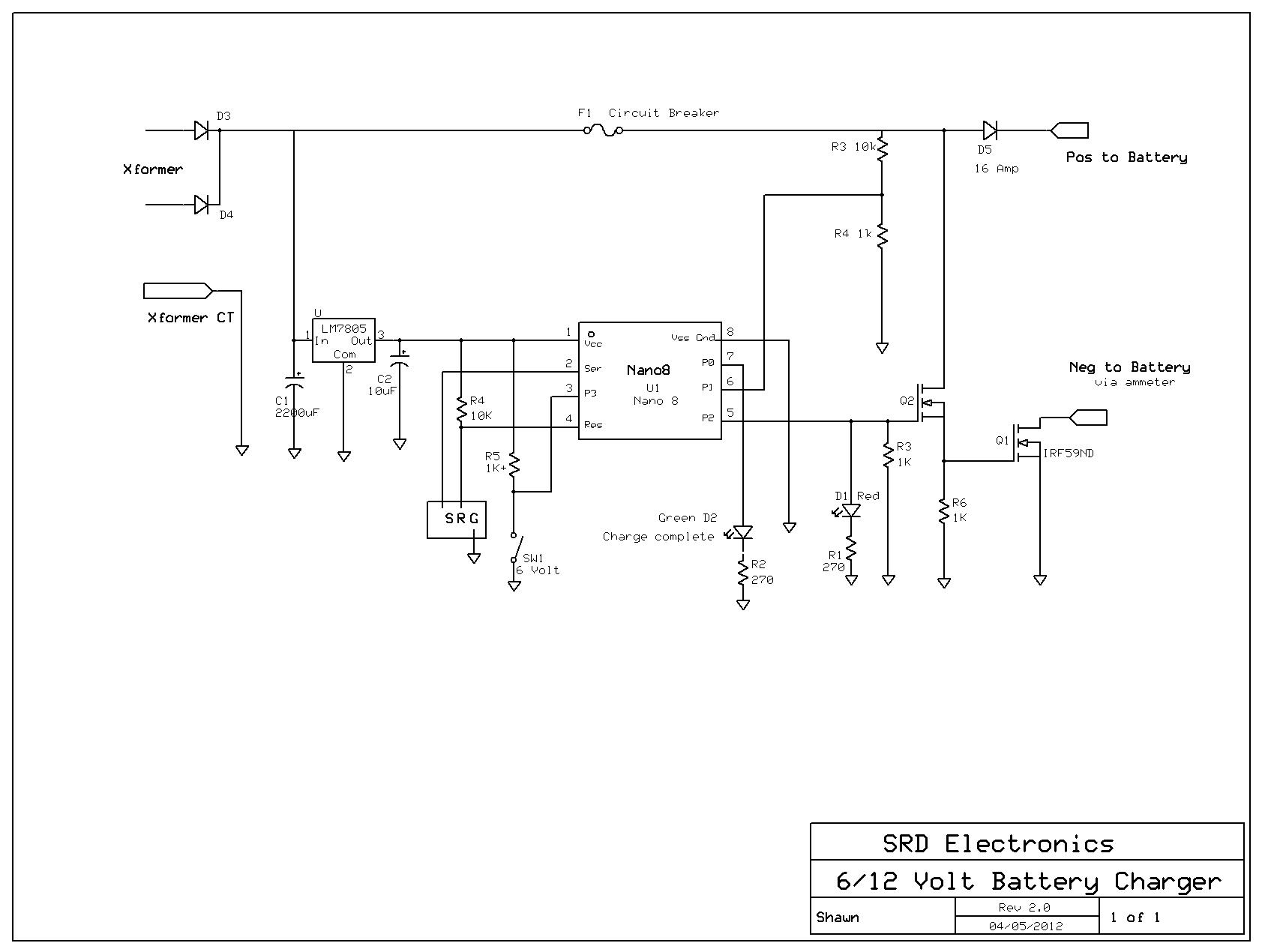

I think the 2200 Ufd. back at the regulator will hold the voltage at about the battery voltage so you probably don't need anything else. Do go back to the schematic in post #29 though. You will need to "flip" the LED and tie the resistor to +5 so it will still light while charging.
One other thought. Might be better to measure the battery voltage on the battery side of the diode so its voltage drop won't be a factor.
I think I can do that in the software with the threshold values I choose. I do not want to subject the uc to a reverse voltage should battery inadvertently get connected backwards.
Yes? No?
Sure, I guess we are not building a million of them. ;) There might be a slight error by battery type as the diode drop varies a little with current. I'm guessing you are setting the termination voltage at 14.3 or so?
