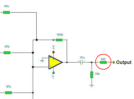

moody07747 said:
the inputs will be tied so i wont have to make any splitting cables.
Tied? Don't short inputs together or you will be shorting the outputs together of whatever connects to them.
the output of both mixer circuits will be joined to combine into one plug which will go into an amp
Don't short together the outputs of the mixer.
I nearly forgot. High speed opamps oscillate at a high frequency when they directly drive the capacitance of an output cable. Therefore add a 100 ohm resitor in series with each output like this:

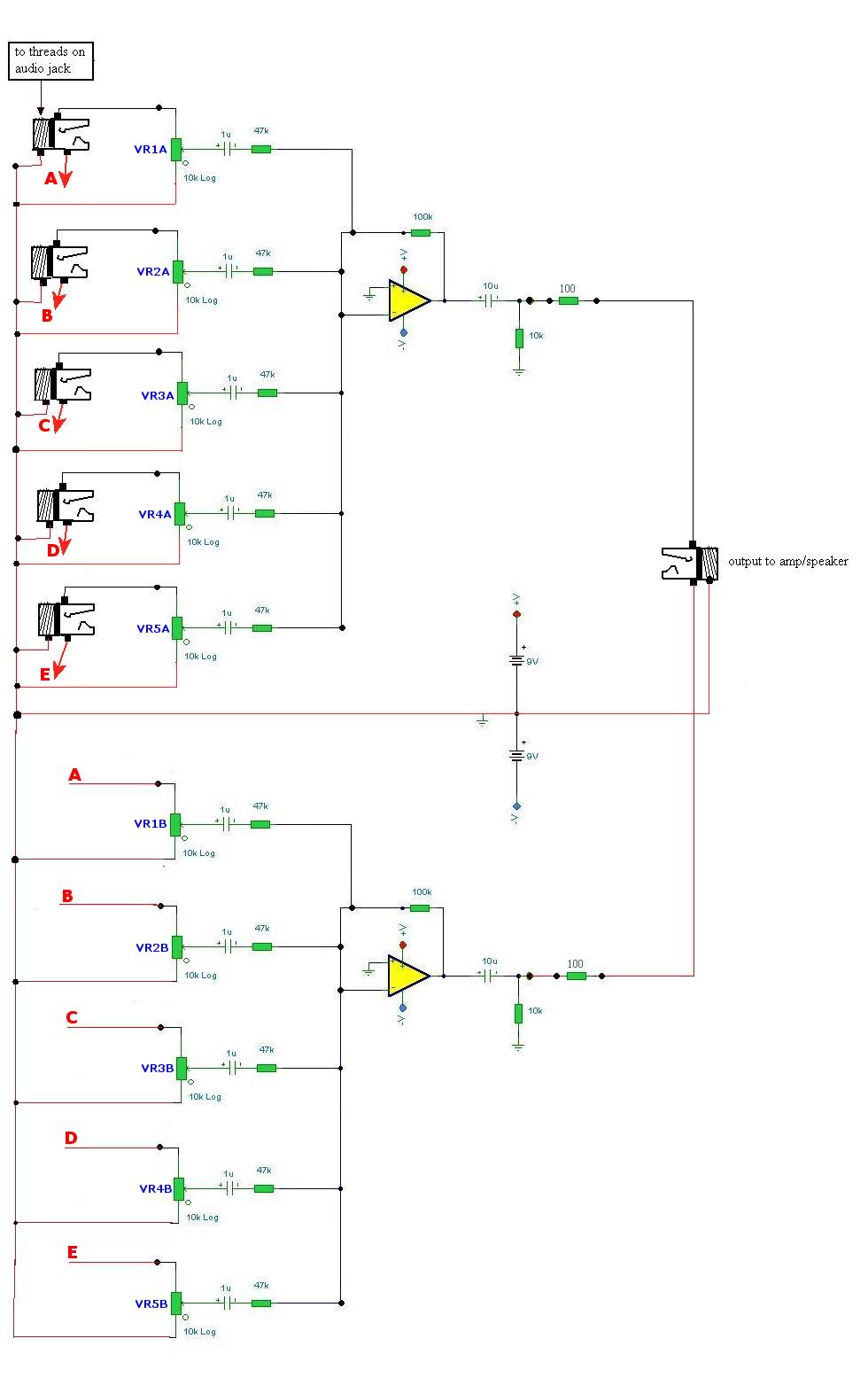

my drumset and guitar have a 1/4" jack on them for headphones or whatever
how do i connect a 1/4" plug into the input of this to get both...
wait, i may have just answered my own question
on a sterio phone jack there are 3 connectors
one connects to the threads, the other two connect to the plug that you push into the jack
my pic shows a blown up version of a phone plug
the pin at the left picks up the the signal for the Right audio output
and the pin at the right picks up the signal for the left audio output
i would ground the threads(i think), attach all the LEFT pickups to the LEFT circuit and then attach all the ight pickups to the RIGHT output circuit
i guess that would work
ill have to draw it all out again
ok i think i finally got it
look at my 3rd wiring sheet :oops:
if its not correct someone might want to spend some time redrawing it for me bacuse i am more of a visual learner meaning if i see something (like in a pic) i learn it better/faster.
here we go (see pic)
You appear to be confused regarding the jack plug connections?.
Firstly, almost ALL 1/4" jack plugs are mono, not stereo - only a very small percentage are stereo, and are mostly used for stereo headphones (also used occasionally for balanced inputs as well).
The 'threaded' connection on the jack soket is ground, and the tip is the signal - IF it's a balanced input, the ring is the inverted signal.
Guitars are almost always a mono jack, and microphones are normally a mono jack as well - if they are balanced they usually use an XLR connector.
The mixer you're proposing is line level only, and you couldn't use a microphone with it, unless you add an extra preamp stage (like the original design did).
You have to use a suitable jack though.
Here is the corrected schmatic.
You can use 5 (two-ganged) variable resistors instead of ten separate ones because most of the times you control left/right channel together.
Look at the schematics and you will see they are VR1A/VR1B,....etc.. When you adjust VR1A, VR1B will be adjusted also because they are mounted on the same shaft.
