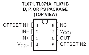

If you need a picture of an IC to identify its pins or any other info about it, look on its datasheet.

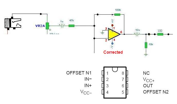

Nice try, Moody.
Out of 5 pins you got one correct. The inputs of an opamp are at the left side and its power supply pins are at top and bottom like this:

On a breadboard instead of a Veroboard or pcb without a metal case connected to its 0V, the wiring between each pot and the IC will pickup all kinds of interference. I always use shielded wire to connect to input connectors and audio pots even if the whole project is in a metal box.
I have seen many very complicated circuits having millions of wires but I never have seen anything that looks like "a huge knot of wire". Can you post its pic?

Pin2 of the opamp has a fairly high resistance in your circuit and the opamp has a gain of about 200,000.
If you can put the whole breadboard and pots in a metal case connected to 0V, it will be OK. :lol:
