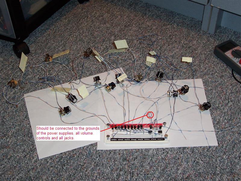

ok i just plugged in my drum set and mp3 player and didnt get any sound
i hooked the output to a pair of small PC speakers that run on 4AAs
i then plugged headphones into the output of the mixer and still no sound
whats wrong?
do i need an amp to test this?
what about plugging onto my PC speaker system?
If the pair of small PC speakers work when your drum set and mp3 player feed them then the mixer should work the same.
The pair of small PC speakers that run on 4AAs should have worked when fed by the mixer because the battery powers their speaker amp.
The mixer should drive headphones at a very low level and without any bass.
In your pic, it looks like the breadboard's ground wire isn't connected.

t he ground is connected properly
i did that when i wired in the battery holders today
now im really confused because this is not running
im really confused with it all on the floor so im gunna put it in the foam enclosure while i test it
ill look over the wiring again tomorrow.

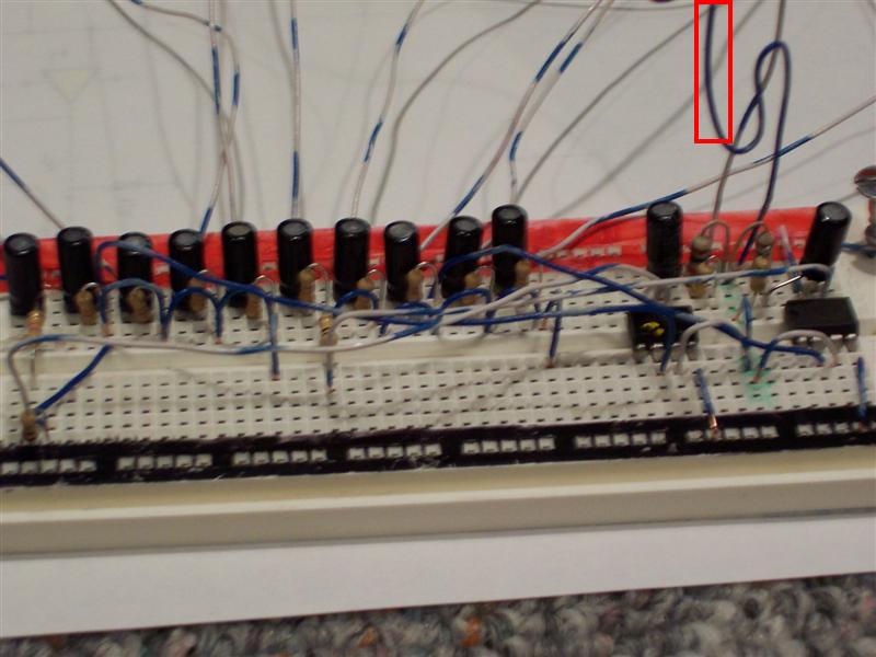

in the pic, the wire in the circle is not a ground
i put it there for a bit to mark one of the output lines
that one connected to the right audio phone jack.
That wire sure looks like it connects to pin 3 of both ICs.

i have 4 pics here
1 and 2 are just shots of the bread board in 2 angles
3 is the left of the BB and 4 is the right of the BB
i starting to get the feeling that i left a connection out by the capacitors but im just so confused with it on a wiring sheet compared to what i have on the BB :?

It would be so much easier to see wiring if a pcb or Veroboard was used.
The "audio out phone ground" is also supposed to be connected to the ground junction of the two batteries and also to the ground terminals of all the input jacks. :lol:
it is
its just not in the pics
theres a wire going to all the output and input phone ground threads to the ground on the chip, (pin 3), to the pos./neg. between the batteries and anywhere else it is called for in the wiring sheet
on the BB there is a green line...that is where all the grounds go

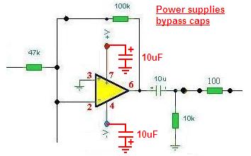

Hi Moody,
I forgot you are using far away batteries. Then the 9V rails should have 10uF caps to ground on the breadboard like this:
thanks for that AG
