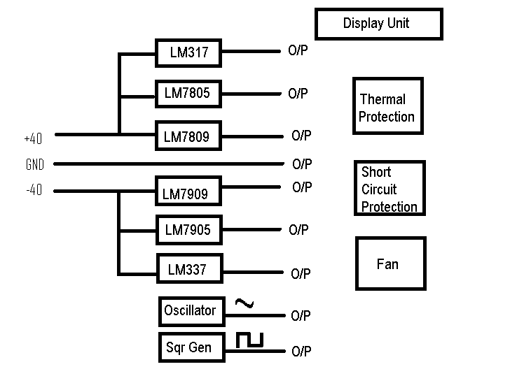

Below in the picture is my idea to construct the power supply.
Out Puts
+5V
+9V
+2 to +35V
GND
-5V
-9V
-2 to -35V
Sin Wave Genrator 100Hz TO 1MHz.
The problem is, i don't know that which type of Oscillator i need to use.
Sqr Wave Genrator 100Hz TO 1MHz.
Will LM555 timer will work???
Displaying Unit,
There should be a displaying unit for displaying the frequency of Signal gernators and out put voltage coming from power supply. But i not know how can i show them on 7Segment Display.
Thermal Protection,
There should be a thermal protection circuit, Need Help.
Short circuit Protection,
A short circuit protection circuit, Need Help.
I want to Build, not to buy.
And Plz guide me for more improvement.
Is there need for adding some thing more???
Thanks.

Wien bridge!.
Use the sine oscillator above, and square it - either an overdriven amplifier or a schmitt trigger.
Displaying Unit,
Use an LCD text module driven by a PIC, you can display all you need on one display.

The regulators you've suggested are already thermally protected, just make sure you mount them on suitably sized heatsinks.
Again, the regulators are already S/C protected, suitable heatsinks needed as above.

What current?
I assume you want 1.5A for the variable positive and negitive supplies and 1 A for the fixed supplies.
What power?
Is it important to you be able to run all the outputs at their maximum currents simultaniously?
This will require quite a large transformer.

I'd go for a wein bridge oscillator, but you'll need to switch the capacitors around and you'll need a fast op-amp.

The TS555 will bo all the way up to 2.7MHz
What about protecting the output form short circuits?
Do you what to be able to adjust the duty cycle?
Would you even like to be able to adjust the duty and frequency seperately?
If so then a schmitt trigger oscillator and comparator is probably a better option.

I need 1A current on both side(+,- V).
currents will be simultaniously...
I have 35-35Volts center tape transformer rated current on it is 2A.
Will TL072 Work???
I need out put impedance 100:eek:hm:

Your 35VAC transformer will produce an unregulated output of 47VDC which is much too high for the regulators. Their max is 35VDC and 40VDC. It would also create too much heat in the regulators.
The LM7805, LM7905, LM7809, LM7909, LM317 and LM337 cannot supply their full 1A with a high voltage across them because they will be too hot. They automatically reduce their max output current to about 300mA to protect themselves, then shutdown if they get too hot.
The TL072 has a max output swing up to only 100kHz.

You really need a 28V-0-28V transformer, either that you you could try building a 39V pre regulator using a transistor and zenner but this isn't an ideal solution.
Also consider using an LM317 and LM337 in place of the LM7809 and LM7909, the LM7805 and LM7905 can then be connected internally to the output.
Also please note that the voltages on the transformer secondary and from the output from the supply are hazardous and are above the legal in the UK and Europeean limits for allowing physical contact with. The IEEE regulations state that in dry contitions user contact shall be avoided with voltages greater than 25VAC and 60VDC. On your poposed project the secondary side of your transformer gives 70VAC, 98VDC on the output capacitors and 70VDC on the output.
I would lower the maximum output to +-30VDC and use a 24V-0-24V 2A transformer, there will still be hazardous voltages in the case but at least the output will be relativity safe. Be aware that 60VDC is the maximum and is only considered safe in dry conditions, it is high enough to give you a fair shock if you have wet skin.

For the lower voltage supplies you need a lower voltage input - do the maths for the dissipation in the regulators - it's dead simple.
W = V x I
Assuming I (current) is 1A, and assume a 5V regulator (ignoring any over-voltage concerns).
Your rectified DC voltage will be about 45V - subtracting the 5V output leaves 40V to be dropped across the poor little 7805 regulator, so W = 40 x 1, giving 40W of heat to be dissipated by the 7805. I'm not bothering looking the specs up, because 40W is obviously FAR too high for such a little device.
A little 7805 will be at its max rated temperature if it has an infinite (perfect) heatsink and only 20W of dissipation.
Maxim's MAX038 function generator is also not made anymore.
How can i solve the problem,
I have 30-30V transformer and i can't buy another transformer.
But i want to made a power supply as above.
Unless you go the switch-mode route, then there's no escape - you HAVE to dissipate the heat somewhere. You could fit very high wattage resistors between the supply rail and the regulators - but this just moves some of the heat from the regulator to the resistors, and the resistors will be expensive and need mounting on heatsinks.
Assuming all outputs are fully loaded you're probably talking about 200W or so of heat to get rid off - so huge heatsinks and cooling fans are likely to be essential!.
Far easier (and cheaper) to have an extra mains transformer that feeds the low voltage regulators. At the risk of repeating myself?, it might also be a good idea to make the variable and fixed supplies in different boxes, for added versatility - don't forget, there's no need for a voltmeter on the fixed supplies.
The problem is what you want to do isn't really practical.
What you want to do is build a linear power supply with a high voltage input and low voltage output on lowest setting. Linear regulators drop the voltage by converting the excess energy to heat so a large voltage drop will generate a lot of heat and require a lot of cooling.
Don't worry there are solutions to this:
You could lower the input voltage on lower settings. A good way of doing this is to use a transformer with a tap in the middle and run it at half the input voltage for lower voltage settings. Unfortunately you need a positive and negitive supply, so you'd need a transformer with two 28V-0-28V windings.
You might want to consider using a switching regulator. There are specialised ICs that can do this or you can use the LM317/337 with a few other componants (see datasheet). The problem is this is often harder to build (apart from some ICs) and the output is always more noisy than a linear regulator.
I suggest you use a combination of both techniques. This is know as a hybrid regulator. The idea is you use a switching regulator to drop the most voltage followed by a liner regulator to smooth the output resulting in a happy medium. You could use the 35V transfomer to get a -48 to 0 +48V supply, then regulate it down to 3V or 4V greater than the output setting (depending on how noisy it is). This could be done by either having two voltage ranges or using a subtractor circuit.
Personally I wouldn't bother becuase this is getting too complex. I'd be satisfied with having a more sensible (lower) output voltage.
With some Changes,
I found a transformer from backyard of 45-45 volts center tape 4 Ampere transformer. I opened it and reduce it's turns and add two more windings on it.
After rewinding now it's Specification,
With No Load,
Two windings of 34-34 Volts,
Two windings of 14-14 Volts.
Now my questions,
Will this work??
When we will convert these AC voltage into DC then what will be the output DC voltages???
The peak voltage of a sine-wave from a transformer is its RMS voltage times the root of 2 (1.414). So 34VAC has a peak voltage of 48.0V which is reduced by the rectifier bridge to 46.6VDC. It will be higher without a load.
The max voltage for 78xx regulators is 35VDC and the max across an LM317 is 40V. At these very high voltages they will get too hot and reduce their output current then shut down.
14VAC has a peak voltage of 19.8V which is reduced by the rectifier bridge to 18.4VDC. It will be higher without a load. With pretty big heatsinks, a 78xx or an LM317 will produce an output current of about 1.0A. With a lower input voltage they would have an output current of 1.5A.
It mean i need to rewind my transformer to reduce more turns of transformer's winding.
It means transformer specification should be,
1. Two winding of 24-24 volts RMS for producing 34 of Peak voltages and rectifier will convert them in 30 Volts Apporx.
2. Two winding of 10-10 volts RMS for producing 14 of Peak voltages and rectifier will convert them in 12 Volts Apporx
Am i right???
Am i right???
The regulators reduce their output current when there is more than 15V across them. Their max heating is only about 20W before they shut down.
If you add current-boosting power transistors to them then they won't limit the current and won't shut down.
