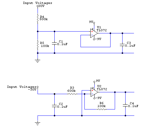

I attach circuits below, these are correct or need some improvement??
Want to improve performance:D

There's nothing wrong with what you're suggesting.
You can save yourself an opamp though. Make R6 and R3 1M:eek:hm: then you can remove UB.
Input impedance isn't too critical here since your supplies can both output a considerable current, so I wouldn't worry too much about using such high value resistors, 100k:eek:hm: and 500k:eek:hm: will more than do. You might also want to consider using precision resistors for this part of the circuit to make your readings as accurate as possible.

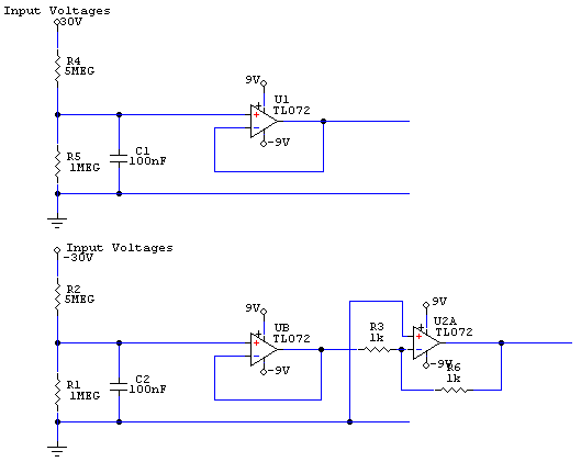

With some improvements
Thanks Hero999.
Below i made some changes,
I reduce the values of input resistors.
I simulate this circuit in "CircuitMaker" Now input currnet is 50 Mircro Ampere.
It is normal current or need to increase input resistance???
C & C ????

I think the opamps will oscillate like crazy with those capacitors shorting their outputs. Then they might even get so hot they will melt!
A TL072 oscillates with the small capacitance of only a shielded cable connected to its output.

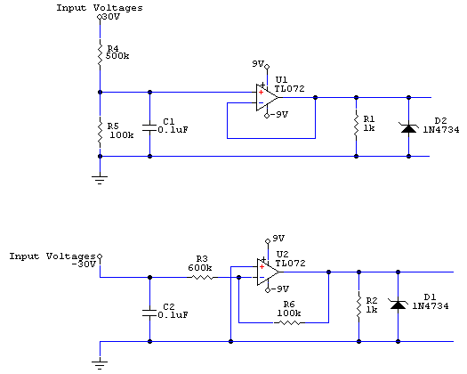

Improved.
I omit the capacitors from OP-Amp out put
and also add a zener diode. For protecting the PIC input leg.
Zener voltages is 5.6 voltages.
C & C are welcomes

There'a nothing wrong with that.
The divider ratio for +V is different to -V, have you done this on purpose or is this a mistake?
