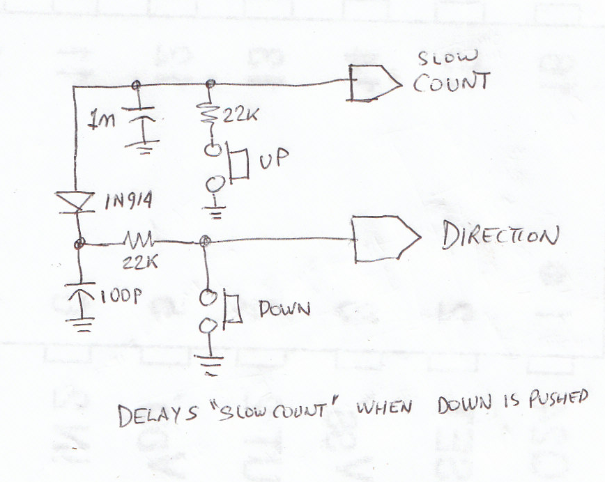

It's fed by a mains 110v supply...I'm looking to incorporate two switches (momentary) that will manually actuate the counter, one for either direction. Resourcing the correct rated switches is proving puzzling to me...not wanting to incorporate any power supply ect components.
What rating switches do I need....???
and how would the circuit look.....how do I connect them up in other words!!!!

Any small (under 1A) switches will work.

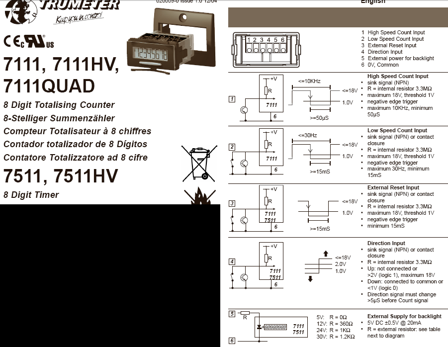

The device has a DIRECTION input and a SLOW SPEED COUNT input, you cannot just simply use two switches. The DIR input has to be driven low at least 5usec before the SLOW SPEED COUNT input is driven low to make the 7111 count down.
The attached network should do it.

As for the circuit - its shown properly in the Rs datasheet - so cannot add to that.

No they don't. Look at my attachments. The input signals are isolated low voltage. The open circuit voltage across the switch is 18V with the current limited internally by 3.3megΩ.

You are right. He is better served by using the 7111 than the HV module. My circuit will not work with the HV version.
