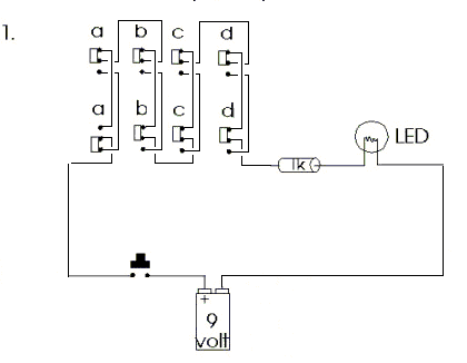

My son has to build a circuit that will allow a user to answer 15 multiple choice ( a, b, c, or d) questions. My knowledge of electronics dates back to High School (late 70's) but I'm willing to give it a try! Please help! (Previous entries include boards with 60 nails in them to which you touch a wire, I'm looking for something a little more sophisticated) We have one week and a $100 budget.
Thanks,
Tom (Canada eh!)
There are so many ways to approach your project. Here's one very basic design. If they were happy with the nails, they should like this. Selections are made by sliding a slide switch (Radio Shack #275-406) corresponding to your choice (a,b,c, or d) for each of the 15 questions. Although the diagram only shows three questions, you can expand the idea. To find out which questions were answered correctly, press the push button switch (Radio Shack #275-646). Correct answers will be noted by a lit Light Emitting Diode (LED) similar to Radio Shack #276-022 fed through a 1k (1000) ohm resistor similar to Radio Shack # 271-1321. The total cost should be in the range of $65 plus the mounting board/box/whatever, wire.
Note that the answers to questions 1, 2, and 3 are a, b, and c - but you can make any of the four switches active - in any order. Obviously, the person taking the test should not be able to see which switches are really wired-up.
Hope you get an A!

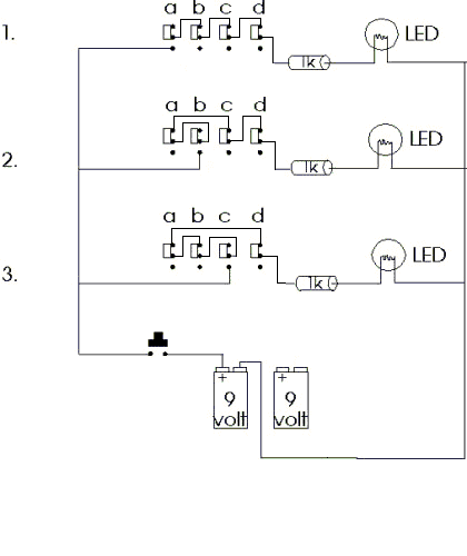

The other method which I can think of is to cut Aluminium foil in strips and stick it on card paper just like PCB tracks. Connect only the strip with correct answer to the bulb. In order to make foil track invisible, cover the base card with picture or question and its option numbers.
See sample schematic below. A B C & D are option points which are only visible through hole in the upper picture layer and can come in electrical contact with the foil track.
In this way you can create as many cards as you want.
I hope I am making myself clear. :)

Well, this is just a basic idea. The game can be made quite more interesting using electronics. Like if the player fail to answer more than 3 questins, he looses. The game locks up until reset. A score board can also be attached which increments to a fixed count after each correct answer.
There are many thing that could be done.

Thanks for your replies, especially to Gene for the diagram and parts list. I knew there was a simple solution, I just could not dredge that deep into the cerebral matter to come up with it! We're off to the parts store Friday to build on the weekend. Will let you know how it turns out.
Tom

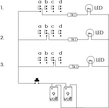

Developing an Idea ...
Gene's little circuit set me thinking ...
If someone cheats by simply operating all four switches for a question ... could we stop that operating the light/LED ?
See circuit Version 2
Then...
The system will only be useable if every set of questions uses the same answers (if someone memorises Gene's suggested answers of A-B-C then they will always be right)... could it be programmable so different answers could be used ?
See circuit Version 3
#For the latter; each multi-choice question has two banks of switches, one bank seen and used by the competitor, the other bank preset to match the questions being used and hidden from the competitor.
The same switch in both banks must be operated in order to light the lamp.
This is a lot more wiring and twice as many switches bu it even allows multiple 'correct' answers, if the quizmaster sets switches 'a' and 'c' to ON then the competitor must also set switches 'a' and 'c' in order to get the lamp to light.
