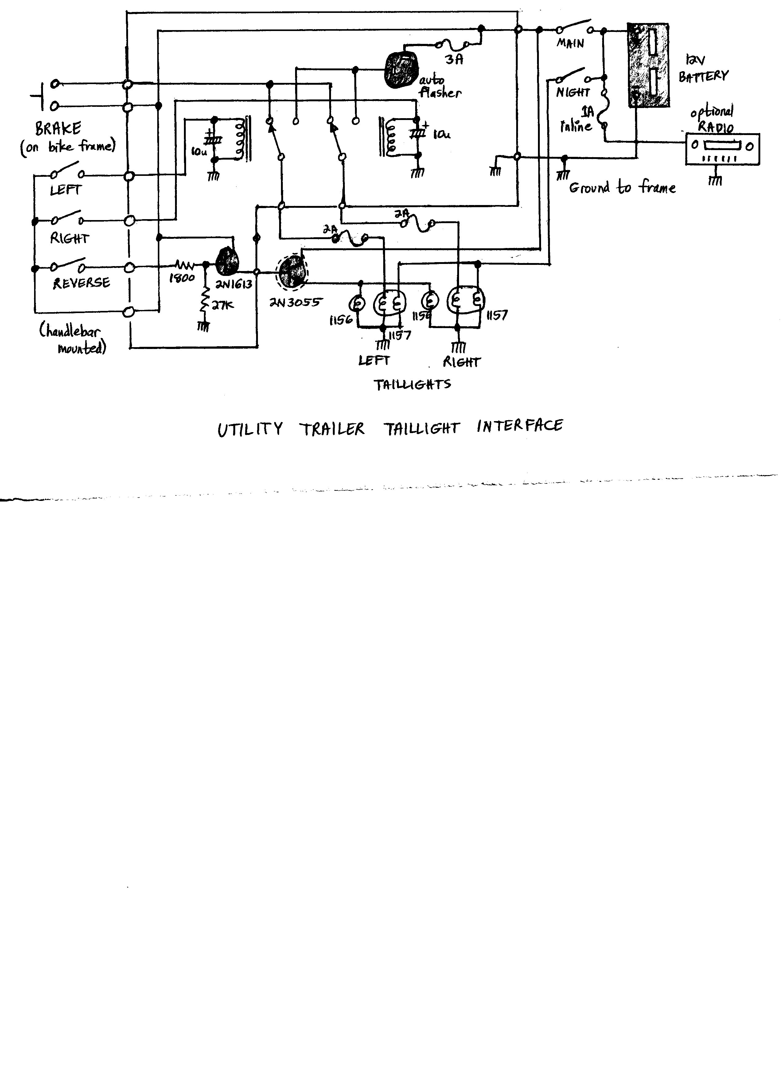

I want to use a switch on my bicycle brake cable to actuate a brake light. What style of switch should I be looking for? Does anyone have any examples?

I would take a magnetic reed switch and a magnet if there is enough movement in the cable.
Glue a magnet on the cable and mount the reed switch close to it. Also I hope this is an LED break light, otherwise you might need to use the reed relay switch to fire a circuit to drive the break light.
Maybe a paddle switch that is N.O. (normally open) and let a mechanical part open and close the paddle lever.

I am a Canadian with a 22-year-old bike trailer having a switch assembly that is the best solution. It is a cable-mounted bolt activating a snap action switch removed from a microwave oven. The bolt is adjusted so that the brake lights come on when the brake shoes touch the rim. The switch is mounted on a 1/2"-wide aluminum strip bolted to the bike frame. In my taillight controller circuit, the controller supplies the voltage to the switch, and the input voltage passes through the relay NC contacts before feeding the taillights. The circuit:
