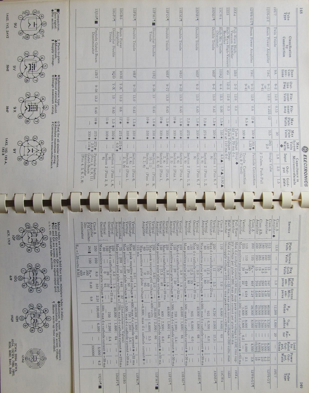

Tube-1a.JPG Here is the Full Data on this 13CW4
