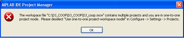

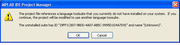

Like i said I wasn't sure you had to set what compiler it builds fine but I don't think it set the chip. I no I loaded it with mplab and i got the one led on. What i did was open the pickit2 and load it with it and it said this hex doesn't have config bits set right for your chip take a look and see if this tells you any thing
Thanks for all the help. My student version of MPLAB keeps locking up, even before I open a project, so I'm going to reinstall it. Who knows, that may fix the problem I'm having with the junebug too. Once I get home and get time to work on this, and apply your advice if the reinstal doesnt fix it, I'll let you know how it goes.

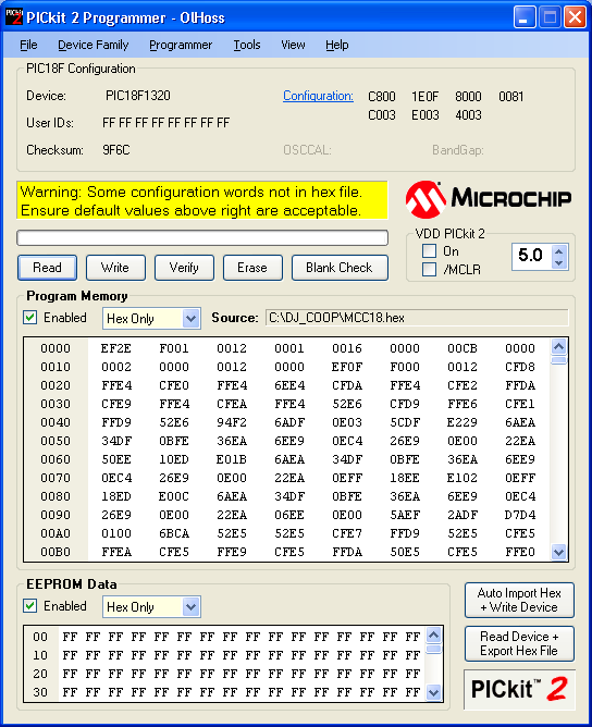

Triode:
The only thing odd that I could find is that the PICkit2 software said the HEX had LVP enabled when the C source code has it disabled.
The code is about a year old and this is the first time I have had anyone report this problem. I am not saying I write perfect code, the problem is where it is.
Regardless of the cause I would be happy to help you.
The code can be run under the Junebug debugger or with MPLAB SIM. To halt execution on each state change you can set a breakpoint inside each task on the switch statment
  switch (seq)

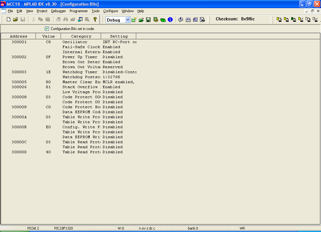

Perhaps you are building with the " Configuration bits set in code" box unchecked. It can be found under Configuration>Configuration_Bits
If that is the case you are over riding the fuse settings in the code.
 #pragma    config OSC = INTIO2, WDT = OFF, LVP = OFF
I didn't change any thing at all till the led didn't flash and I put that back like it was but maybe this is It also said my compiler is not the same as what was use for this project
MPLAB is not the most stable IDE in the world. Check to see if you are using the fuses from the program or from the IDE. It may not be saving or reading that as part of the project.
If using the fuses from the program fixes it we have found the problem.
EDIT: Be sure to do a build all.
That may be it because it was saving back to the wrong file at first so i deleted it and put just one copy on C:\ the program is running at snail speed LOL got me
To test for this problem I downloaded the .zip file from my site, uncompressed it and loaded the project in MPLAB. We should have the same bits.
I replaced my files with the code you just posted and it works also.
