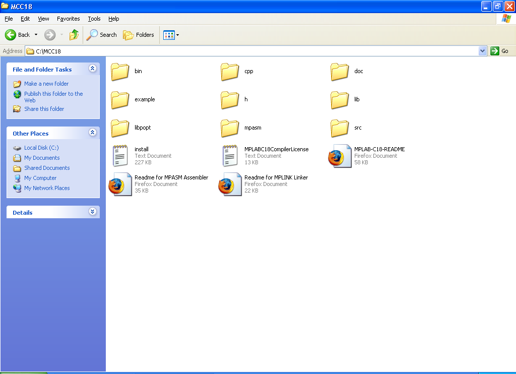

3v0 my C18 doesn't have that linker so I looked in this computer and it c18 has it going to build here and see what happens see take a look it doesn't
have that in MPLAB-C18-Academic-v3_31
3v0 take a good look at the pic there is no C:\MCC18\LNK the linkers are in bin this is
MPLAB-C18-Academic-v3_31 and i install it two time and it still installed the same

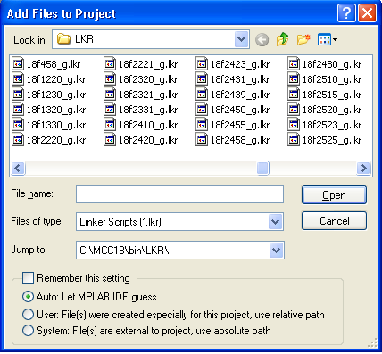

I did that it doesn't use the linker from the down load it has it in it the one you said to use.
Microchip has replaced all the C18 linker files with new ones ending in _g.
The release notes have info on backwards compatibility. I have to rework the interrupt code. In the short run using the old 18F1320.lkr or 18F1320i.lkr file will result in a correct executable.

You have your interrupt vector at 0x18. In compatible mode it should be 0x08.
Thanks Mike.
The code in multiCompiler.h should be
  #pragma code low_vector=0x08  // was 8x18
  void low_interrupt (void)
    _asm GOTO interrupt _endasm
  #pragma code
  #pragma interruptlow interrupt
I need to thank Burt for sticking to his guns on this one. The code has worked without problems for over a year. I was initially quite sure it was operator error. The problem was that Microchip made a change to the linker file which exposed what was up to then a harmless bug in my code.
3v0
Look dad no linker That worked LOL it runs like it should Thanks MiKe and 3v0 now I no
i wasn't setting it up wrong. The new C18 sets all the setting mostly for you and the linker
I tried that and it still used the new one And I set the box to let me use my own. It works fine with your code change.
