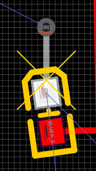

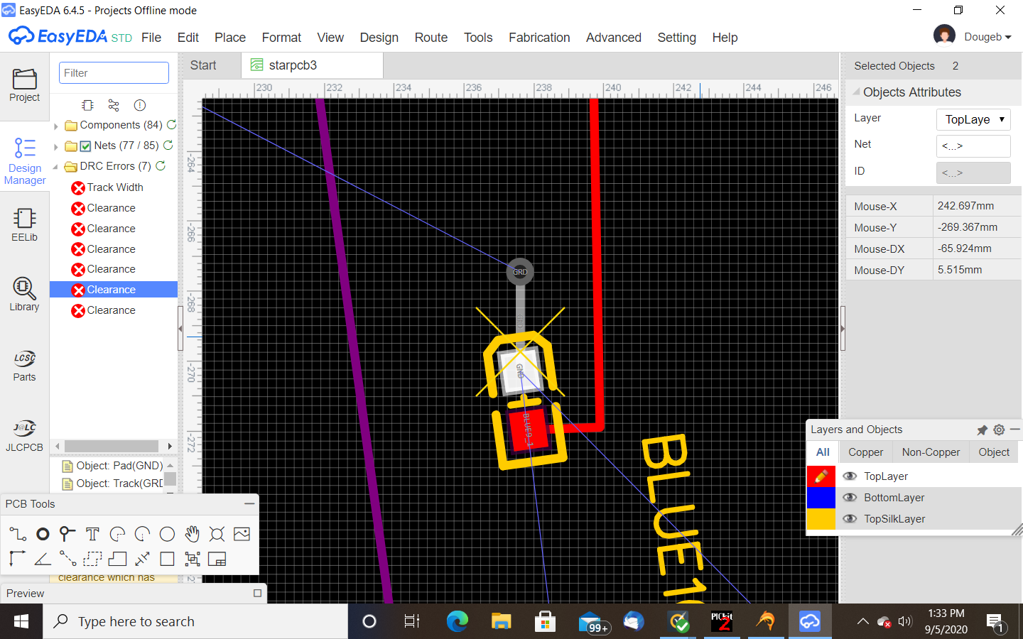

One issue I have is the little X's to indicate errors. Need to move some components away from board outline?
STUPID STUPID STUPID!
I just discovered I marked the via and trace as GRD and not GND.
ran error check and zero errors
I found that placing the copper pour around the star in a square instead of tracing the board outline it pours ONLY the board outline boarder.
Little mistakes causes one to lose hair etc. LOL
A bit late now, since you've found the error, but 'X marks the spot' where the DRC error is.
The box at the lower left, with the yellow background, tells you what the error is and the box above that gives you info.
You can see your GND & GRD conflict on the screenshot.
Hence my advice to use proper ground symbols in your schematic.

I used proper sysbols on my schematic but when I placed the via I typed in the wrong net.

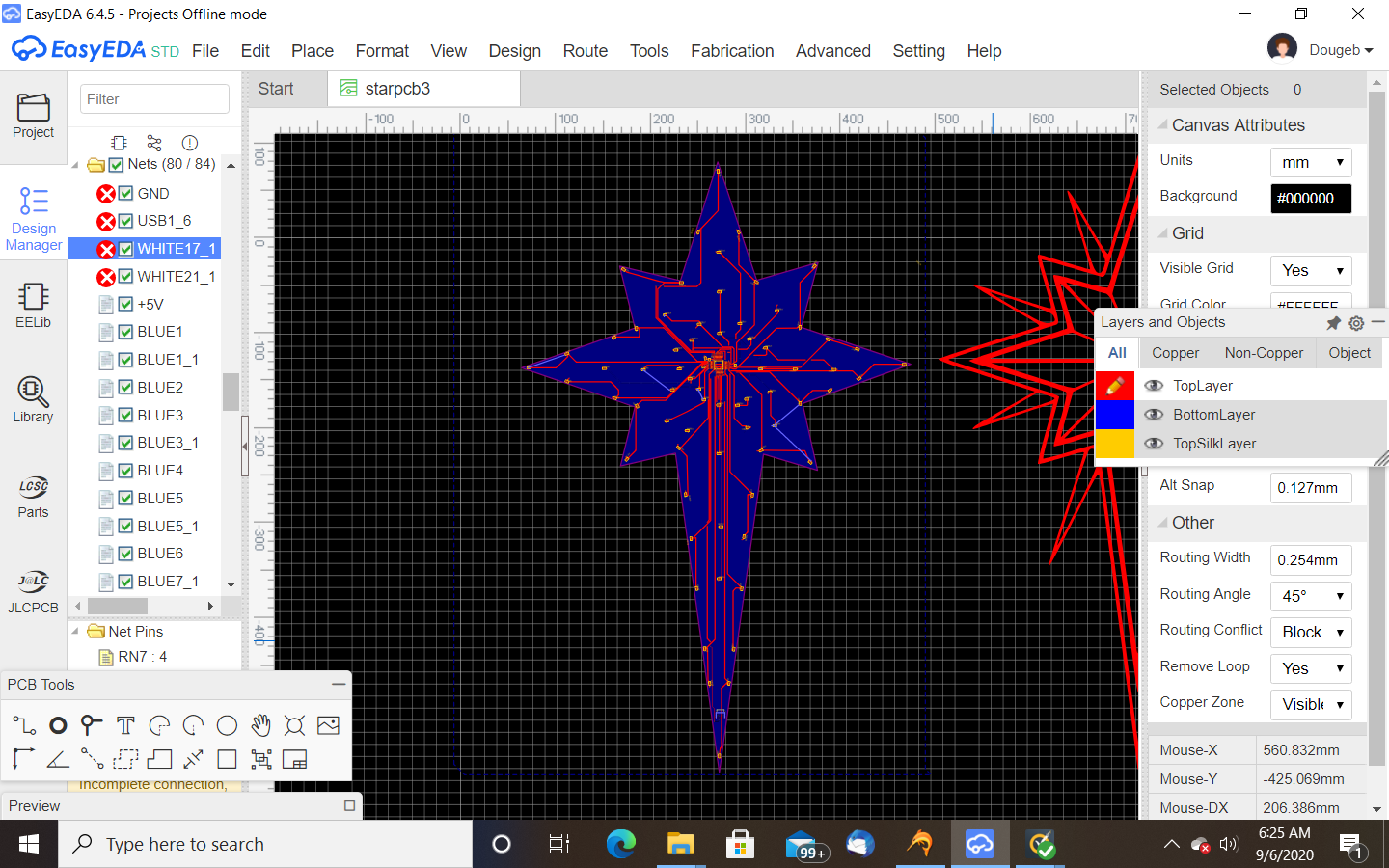

it looks like its done? but what is with the red X's but they are checked off?
Move the 'PCB Tools' box and read the text behind it.
The red Xs in the nets category means those parts of those nets are not complete. Some trace is missing.

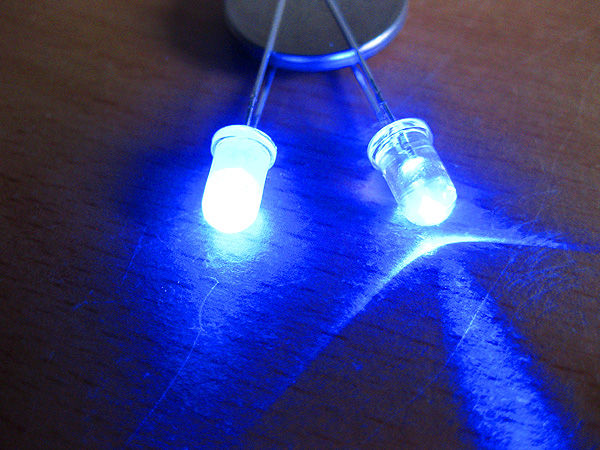

I don't know what effect MrDEB is going for, but JLC's "basic" LEDs are water clear as opposed to diffused. Water clear LEDs emit a cone of light, while diffused LEDs have a frosted lens that lights up the body more.
<< diffused water clear >>
want a subdued light but will settle for what ever they mount on board.

JLC probably has diffused LEDs in the extended list. For an extra $6 total, you should be able to find diffused. I don't think the water clear will look bad....more like stars in the sky.
There's really no reason to have the LEDs at weird angles. They'll appear as a point of light.
