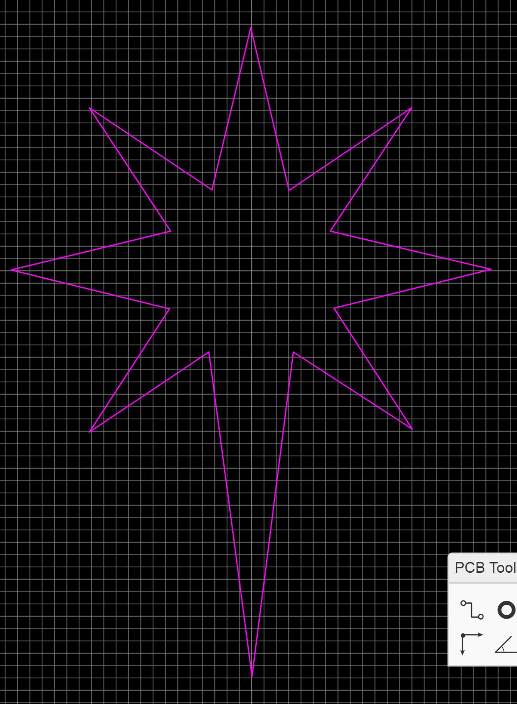

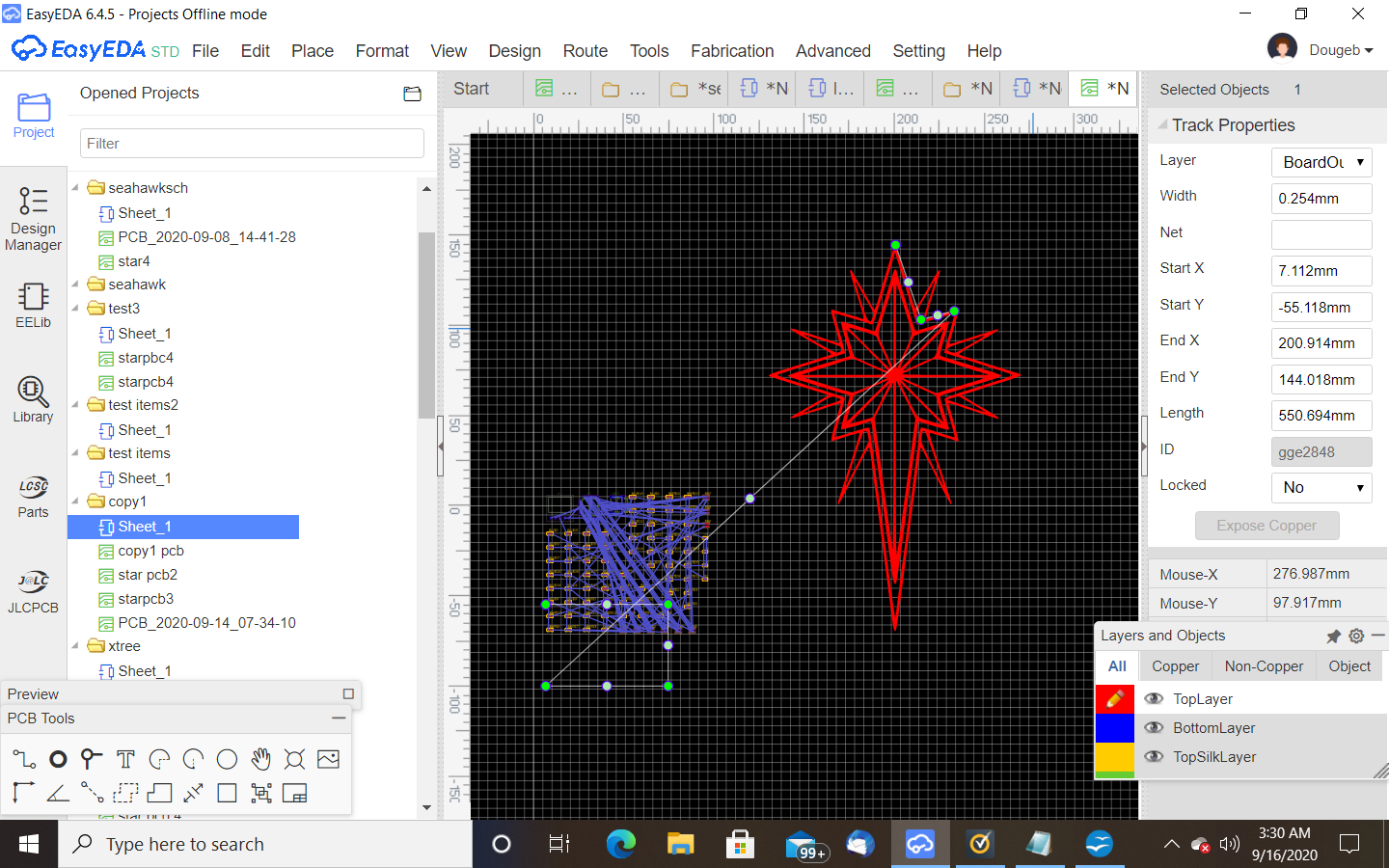

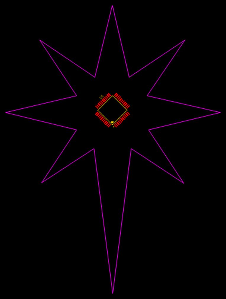

I discovered why my board turned out so BIG
using infa view (excellent prg) and making the star 4 x 6 inches, it comes out as 17 x 11 inches in the gerber viewer.
So back to the drawing board with a much smaller silk screen pic/board outline.
The position of the cursor is always shown at the bottom of the panel on the right. Didn't positions in the hundreds of mm range give you a clue?
You can change the scale to inches if that's an easier scale to think in.

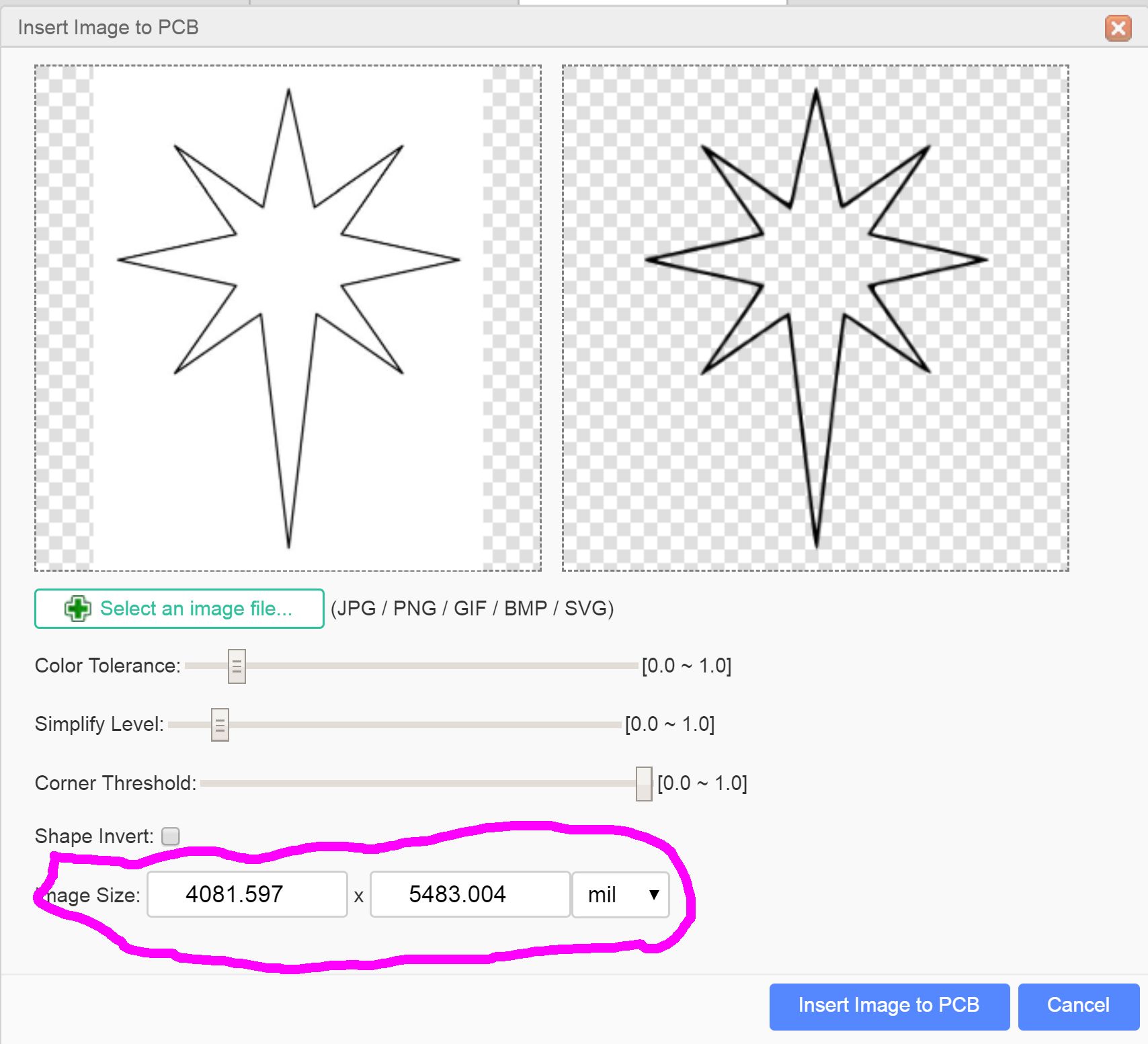

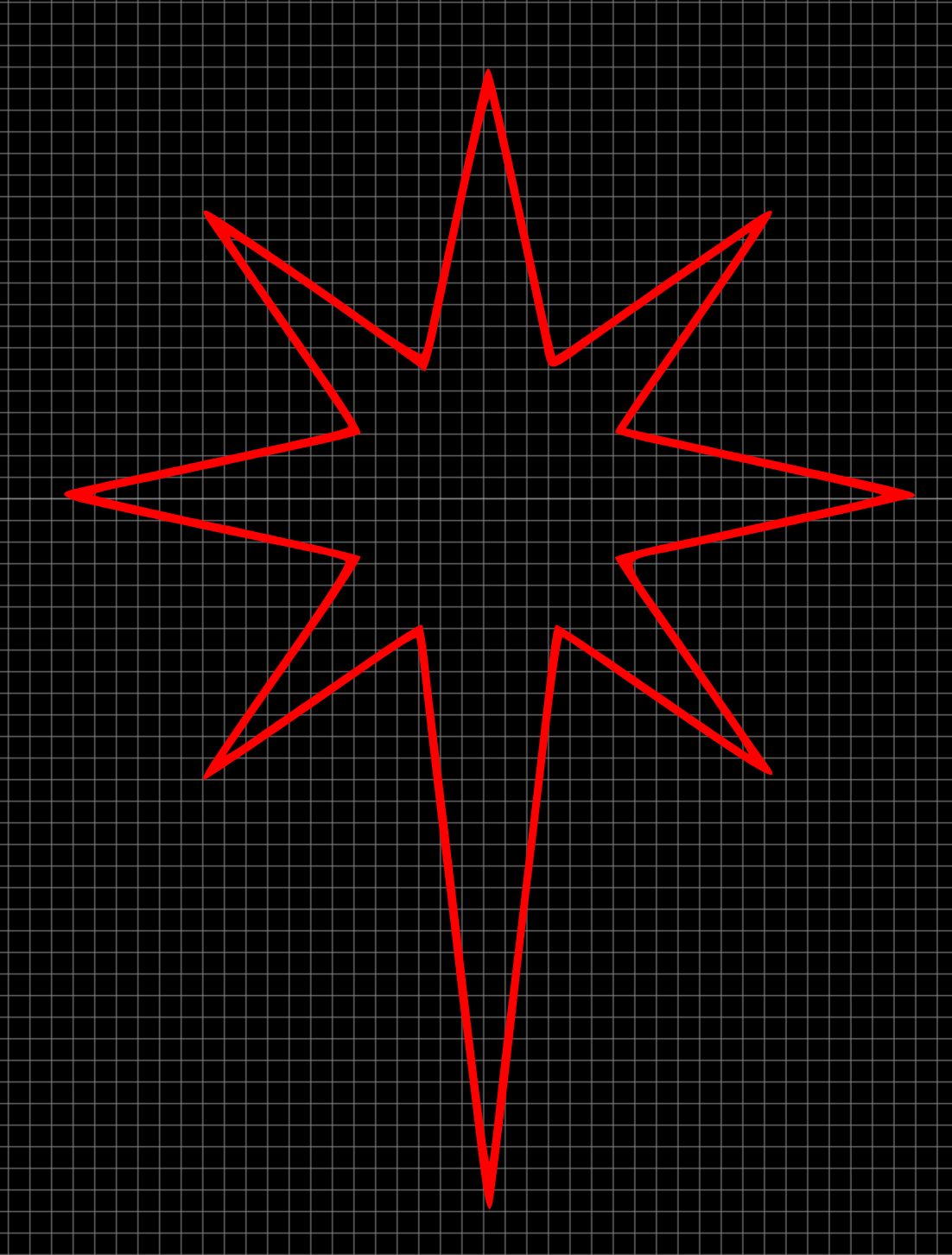

Creating A Board Outline From A Graphic

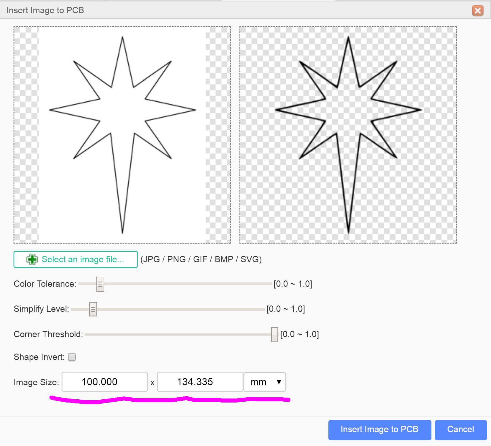

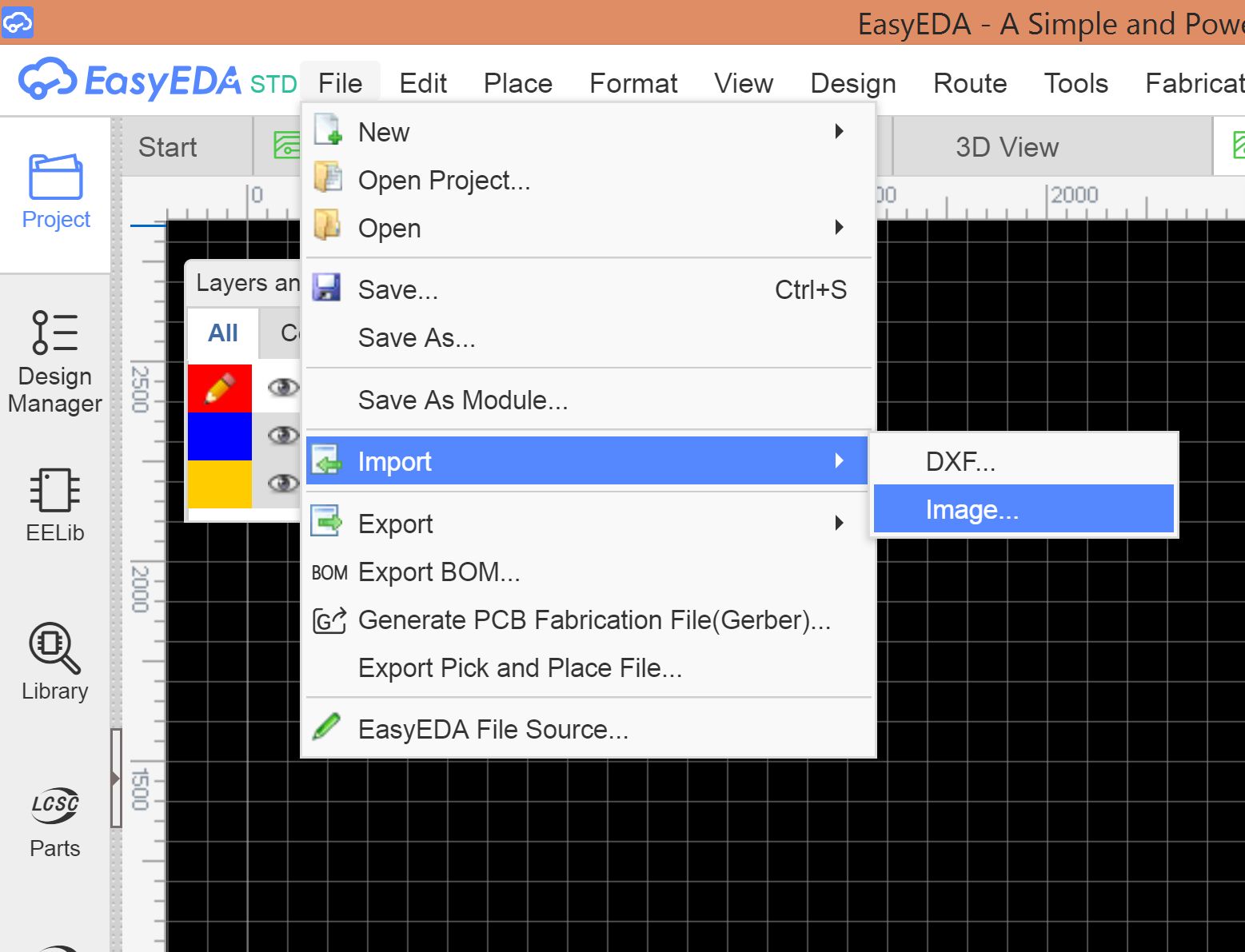

Since I've never tried this, I gave it a try. You can import an image or a dxf file into EasyEDA. This was done with an image file and I suspect it's easier with a dxf.
Step 1: Import the desired image and adjust scaling to get the desired final size.
Make sure the units are as desired, and set the maximum X or Y dimension. The other will be set automatically. In this case, I set x = 100mm, knowing the Y dimension would be somewhat greater than 100mm.

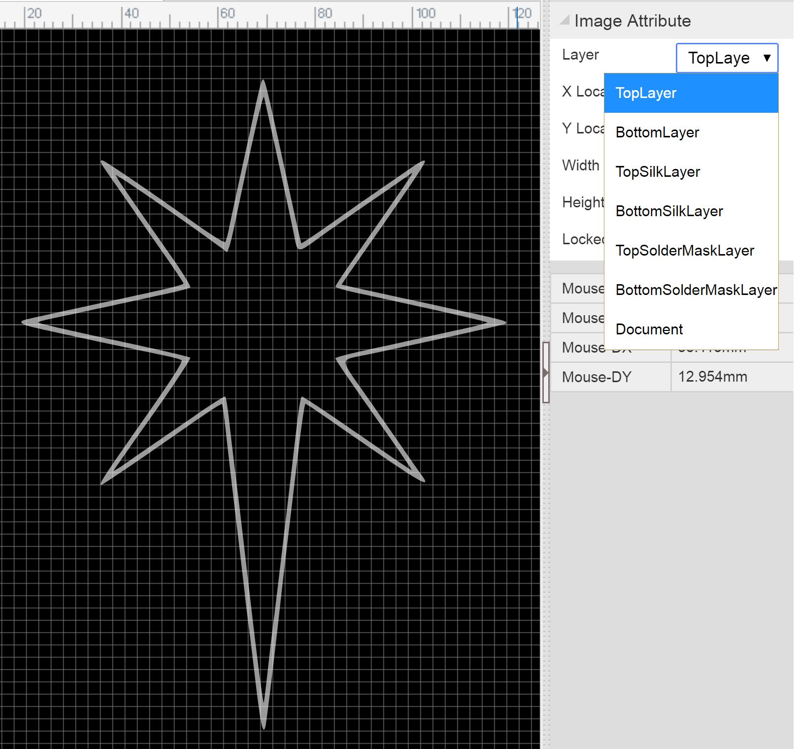

Step 2: Some housekeeping.
The imported image ends up on the top layer, and can't be switched to the board outline layer.
Switch it to the document layer, which is white, to make the following steps easier.

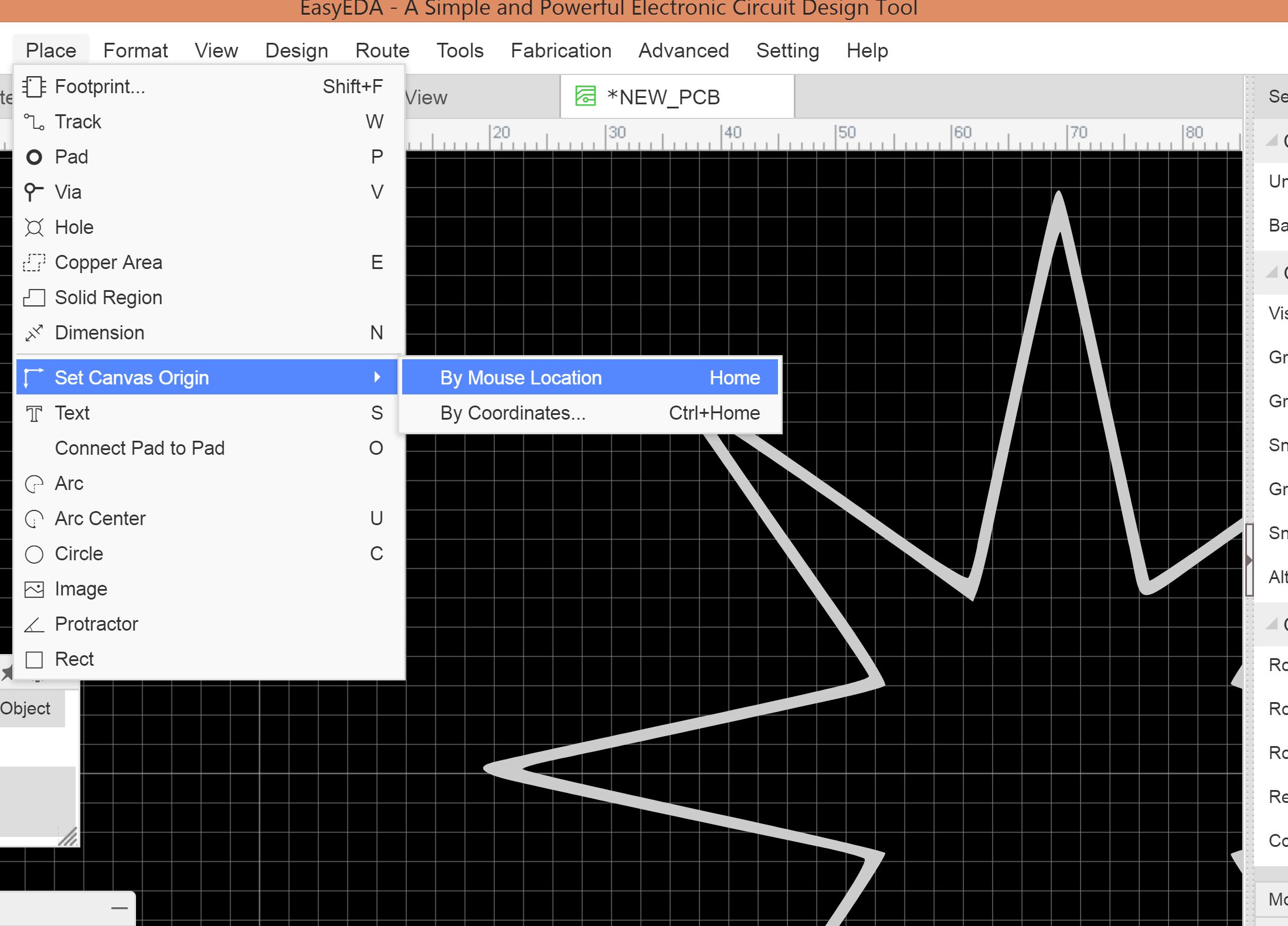

To make laying out the board easier, set the origin to the center of the board. Zoom to include the x-axis and y-axis centerline points, and using the "set origin by mouse coordinates", align as closely as possible.

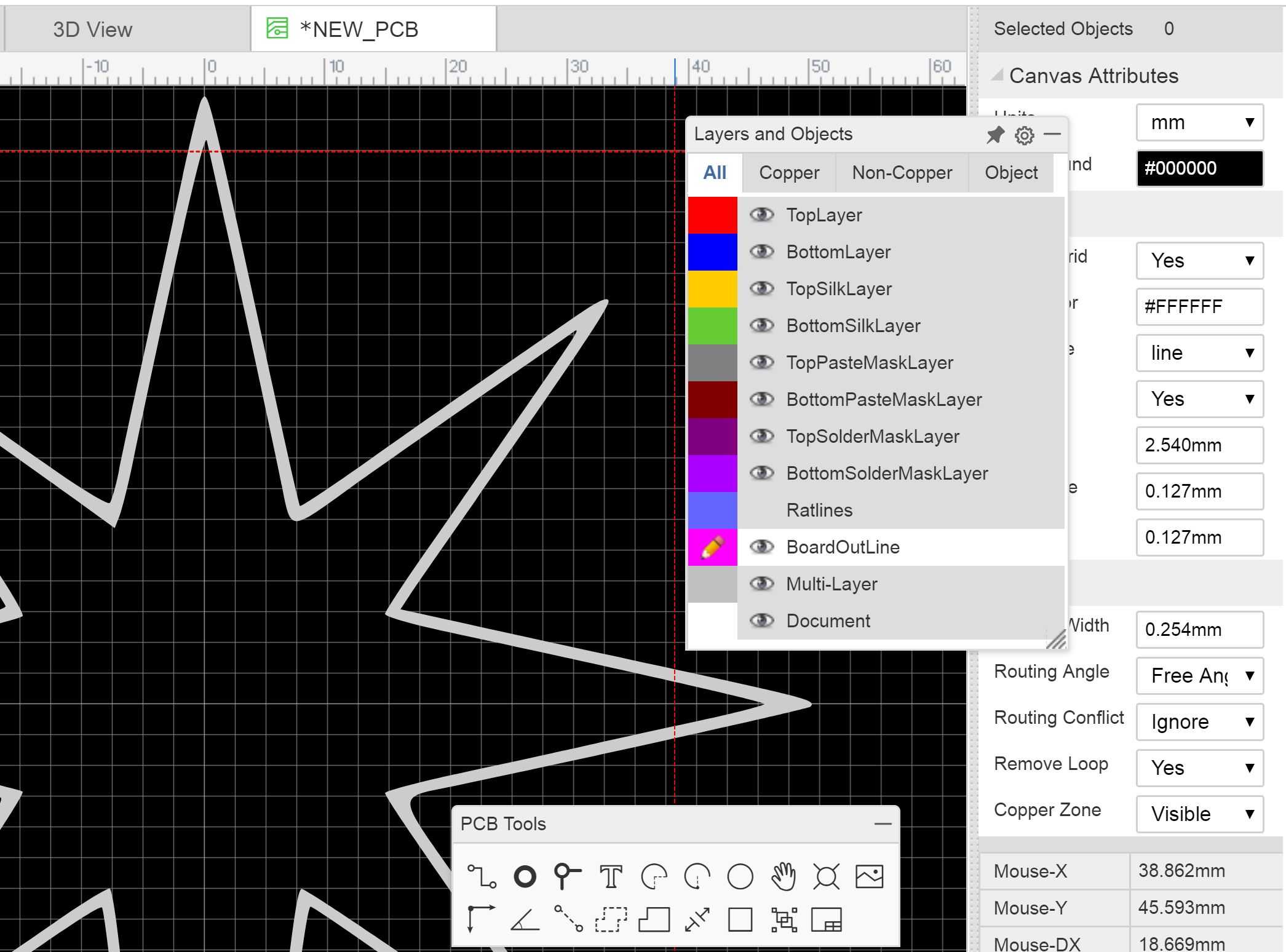

Step 3: Draw the board outline.
Select the board outline layer, set the routing angle to "free", and select the wire tool. Start at the top, and click your way around the corners (inflection points). Make sure the lines meet at the final point and press ESC to finish.

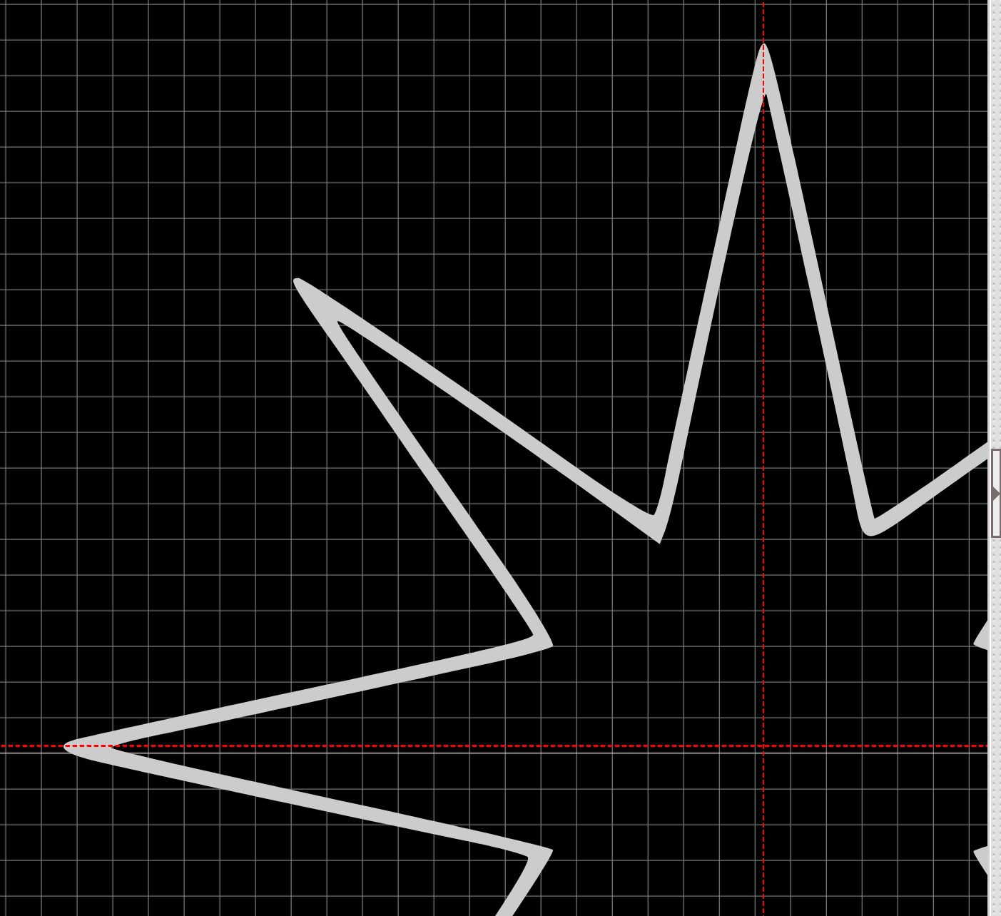

Delete the original image and the finished board outline is left.

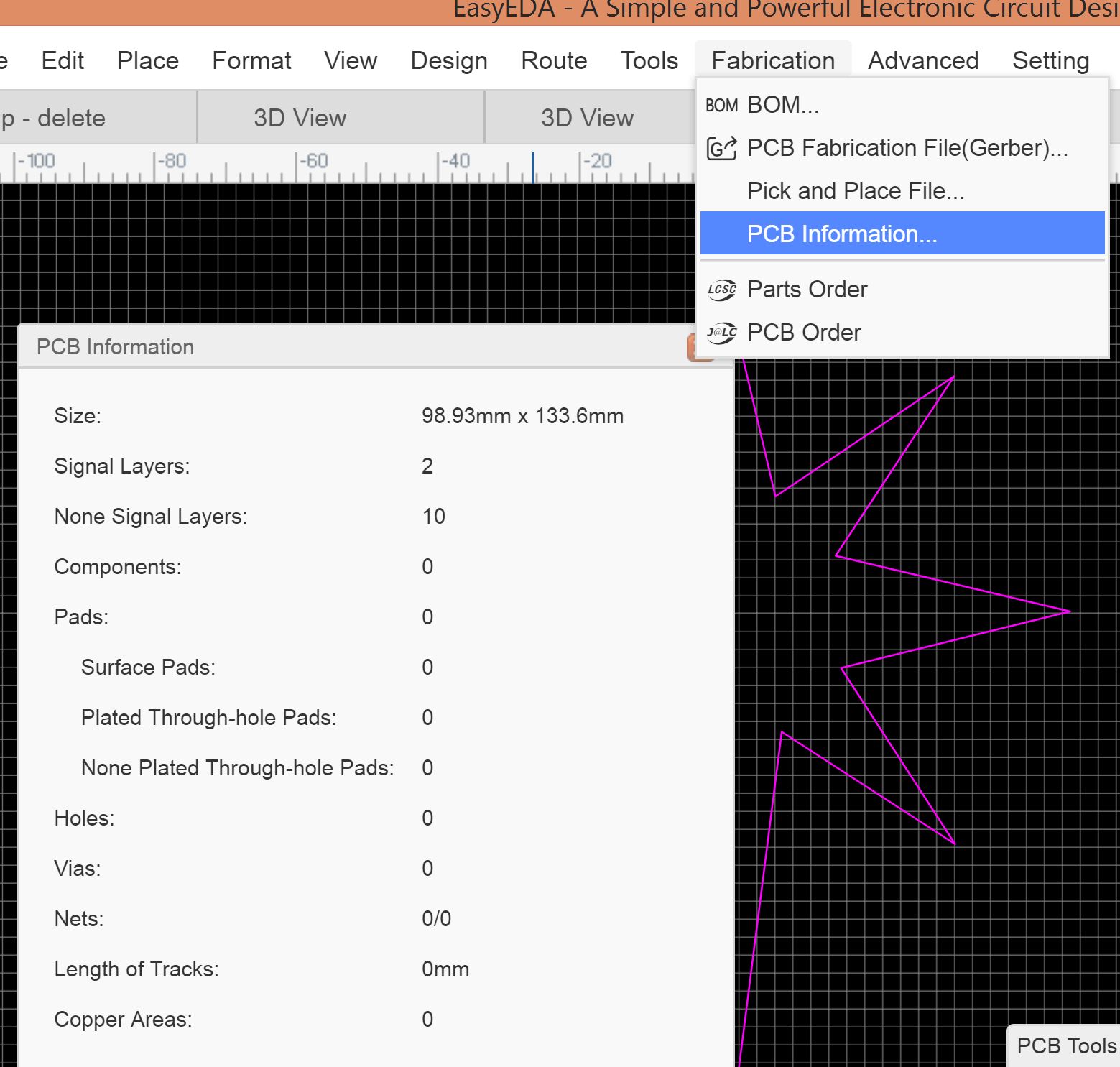

You can check the dimensions under FABRICATION/PCB PROPERTIES. If you colored outside the lines and the board ended up slightly too large, you can adjust points as needed. If everything is as desired, I suggest selecting the entire outline and locking it.

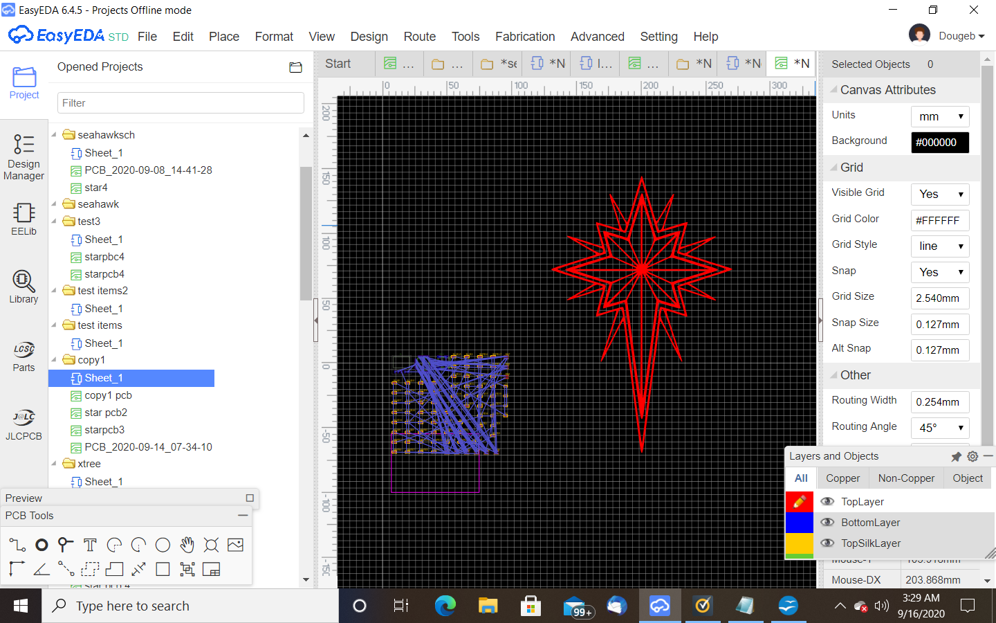

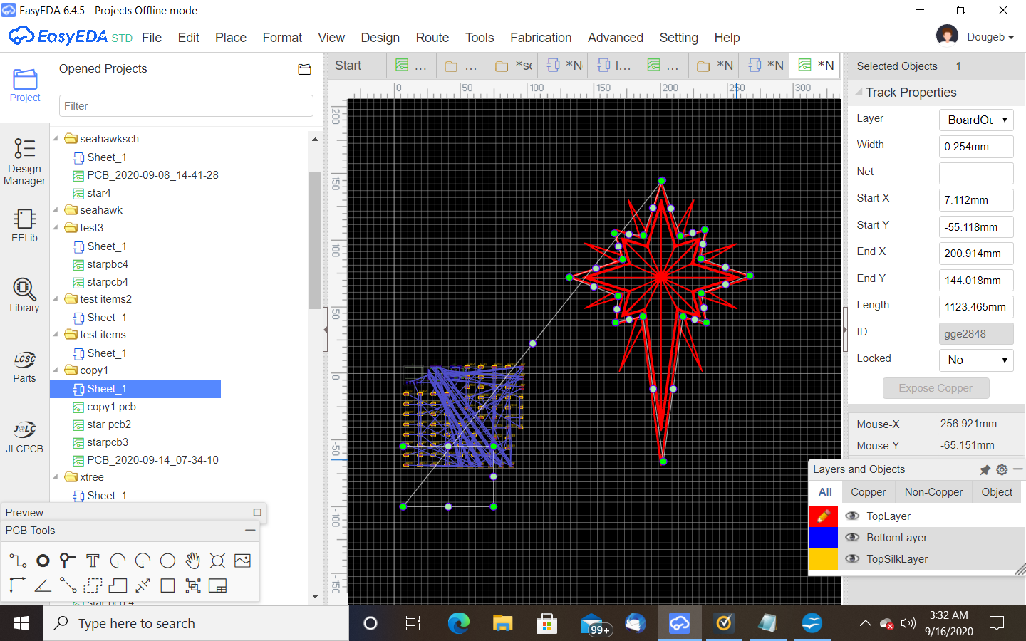

Presently laying out a smaller board but can't figure out how to associate a schematic AFTER I have the board outlined but using same schematic as original BUT the BOM is going to need the schematic associated with the board?
I tried saving the original schematic as a module but got lost real quick.
Tried copy and paste but didn't seem to work either.
My next attempt is to remove the blank schematic associated with the smaller board and try to input the schematic module.
The easiest thing to do is to create a new board from the schematic and when it suggests a board outline, just hit cancel. This will put all the parts on the screen without any board outline.
Then copy and paste the board outline from wherever it is now.

No need to do that.
As I explained above, just click "create pcb" from the existing schematic, and paste the star outline on the board created.

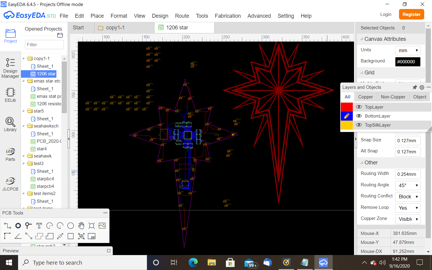

lots of ways to do things but here is my method and seems to work well
Top layer & components LOCK the top layer
start outlining the board outline LOCK AFTER DONE
board outline locked, unlock top layer and save for positing of LEDs to be on top layer
bottom layer using 1206 components.

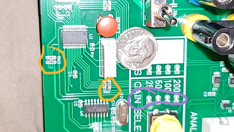

So you're putting parts on both sides of the board? Still planning to have it assembled? Which side of the board will you have assembled?
You do understand the scale of these parts? The yellow circles are 603 × 4 resistor networks. The purple circle has 0603 LEDs.
