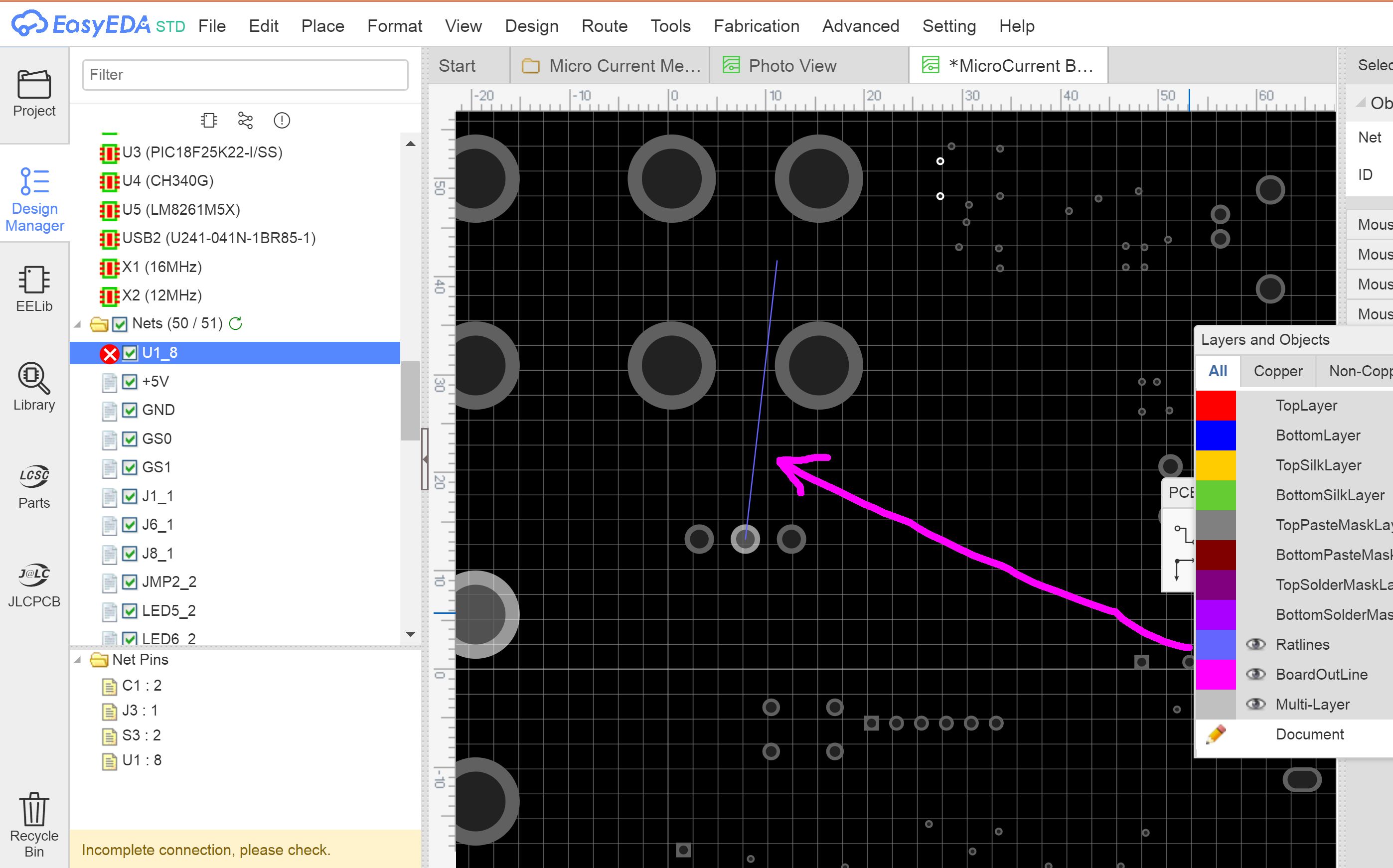

Well I finally have NETS and DRC all correct/
from now on going to lock each connection so stuff will not move.
Had numerous unconnected grounds
now to check LEDs to outline as needed.
I wish when an error comes up it defines the location beter.
Have you moved the ‘PCB tools’ box to a different location on the workspace yet?
If you had, you would probably not be making that statement....

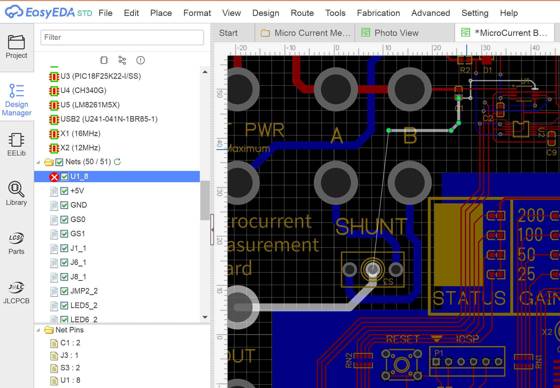

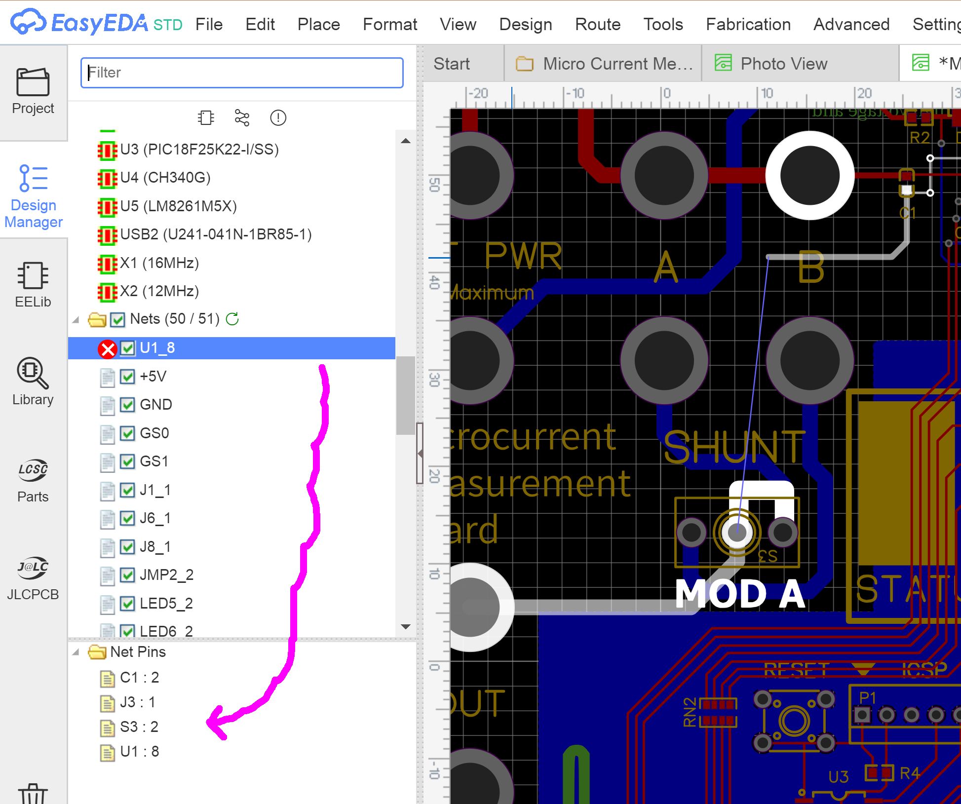

If you're talking about the location of a broken net, highlight the broken net, and in the bottom pane it shows you what should be connected together.
Look for ratlines between those pins to show what's not connected. If you click on some part of the net and press H, it will highlight the net, showing all the points that should be connected together.
If you still can't spot the missing connection, make layers invisible, until only the ratline layer is visible, then look across the entire board to find the missing connection.
that's exactly what Idid to locate all the missed connections.

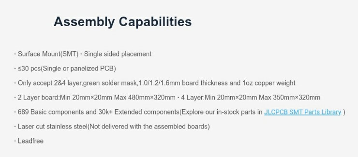

Similarly with JLC's assembly service. Anyone who has had boards assembled will recognize the incredible value of the service and will recognize the importance of the BOM and parts selection. People with experience will also understand where the responsibility lies when the results aren't what was expected.
I saw my suggestion headed towards disaster, so I've tried to amplify key points I made that didn't seem to take the first time, like selecting parts that are in stock and putting all the components on the same side of the board to take advantage of the assembly service.

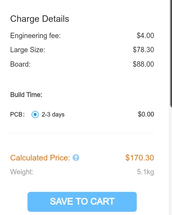

back to the drawing board but I see that JLCPBC are upgrading their stencil and larger plant. Maybe wait?
my board now measures 559x410. the 300 was wrong.
Maybe you want to check:
¤ What size board is possible
¤ What the cost is
before you start a design? You're worried about literally 5 cents worth of resistors per board on boards that will cost $17 each just for the pcb?
I don't know if a board at the max size incurs extra charges for assembly.
