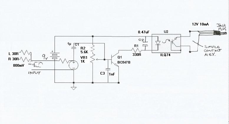

For some reason, I'm having a lot of difficulty with this circuit, 3 popped optos and 3 popped transistors later.
I've attached a diagram. I've tried the transistor between 12v and opto too. I don't seem to be able to set the base at 0.5v. If R1 and R2 can be substituted by a pot, what value.
The input to the circuit is directly from the earphone socket.
The opto output does the keying ok.
The photo diode in the opto-isolator is a LED; it needs to have a current limiting resistor in series with it. That will make the NPN happier, too!
Could you guess the value? I use a 9V Battery.
Yes, I think so, but you may still have trouble if you audio signal is only 200 mv peak to peak. You can try something like this circuit. It may be kind of touchey. If so we can probably use a comparator since you have added a voltage now.
Re your hand-drawn schematic; I would use the pot for R2, at the bottom, as you only need voltage adjustment under 1v. Then you can use a fixed resistor for R1. This will save the transistor in case of turning the pot too far and also give much better adjustability. Or just add a top resistor between 9v and the top of the pot in Ronv nice schematic. R1 should be about 5 ot 6 times larger ohms than the pot value.
R2 resistor on the opto collector in Ron's schematic might be a bit low, I would try 10k-47k range.
Also if you put a 0.47uF cap across the LED it will reduce the LED pulsing from the input frequency so the LED is "on" all the time although it's brightness will still ripple a bit. I don't think you have stated whether your radio needs DC input signal or can tolerate some pulsing?
Thanks Ronv, I'm having problems with opening your attachments. I'll do a few more changes to the circuit before changing though.
As mentioned before I can't open the attachments anymore, which makes things a bit difficult.
I'm not sure we are all talking about the same circuit, so I hope I have all of the modifications on the attached jpg.
If there are any replies, can you stick to this circuit for a while please, till either it works or doesn't, then, if not I'll try another.
Thanks for being patient, sorry this is dragging on a bit!!.
Cheers, Camerart.
