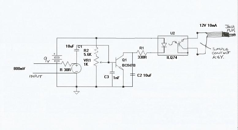

1- If you have addwd any resistors in series with the input signal remove them. I put one in the drawing to represent the protection that may be in the computer.
2- Change the input capacitor to 10 Ufd. This is needed because the input frequency is kind of low.
3- Change C2 to 10Ufd. and move it to the collector of the transistor to ground.

Ronv, I have changed the circuit, is this what you suggest? (see attachment)
MR RB, I am trying with only 1 channel, so no connecting resistors.
Also you suggested a capacitor across the opto LED. Was this to smooth the tone frequency? You said the LED will stay on, but I would have thought it should switch on and off, can you explain please?

... MR RB, I am trying with only 1 channel, so no connecting resistors.
That's fine, there is no need to use two stereo channels now as you are not trying to get enough power to run a LED direct from the sound card. Just running from the left or right stereo channel is simpler and safer, but MAKE SURE to still use a stereo jack plug so you don;t short out the unused channel!!
Yeah that was a minimal parts kludge to try to reduce the flickering of the LED but would not really have removed all the flickering. Ronv's suggestion of moving the cap to the transistor collector is better to reduce LED ripple for sure, although you might need a bigger cap. You can 'scope for the collector voltage when running, and if the voltage ripple is more than a volt or so the cap should be increased.
Putting the cap across the collector like that can be unsafe in some situations as it acts as a short circuit to the transistor when it first turns on, however it is probably safe in your circuit as the trasistor is turned on gently by a low current sine wave, both things the reduce the turn on collector current. If you want a bit more safety then a 100 ohm resistor directly in series on the collector wire will reduce peak currents and also give a benefit of further reducing the LED current ripple. Note if adding that resistor you might need to increase the cap to 47 or 100uF.
SUCCESS!!!
I'll need to make a new circuit to replace the Christmas tree, and will add those extra suggestions. Then I'll have to try it in transmission mode.
Thanks to al concernled. MERRY CHRISTMAS.
