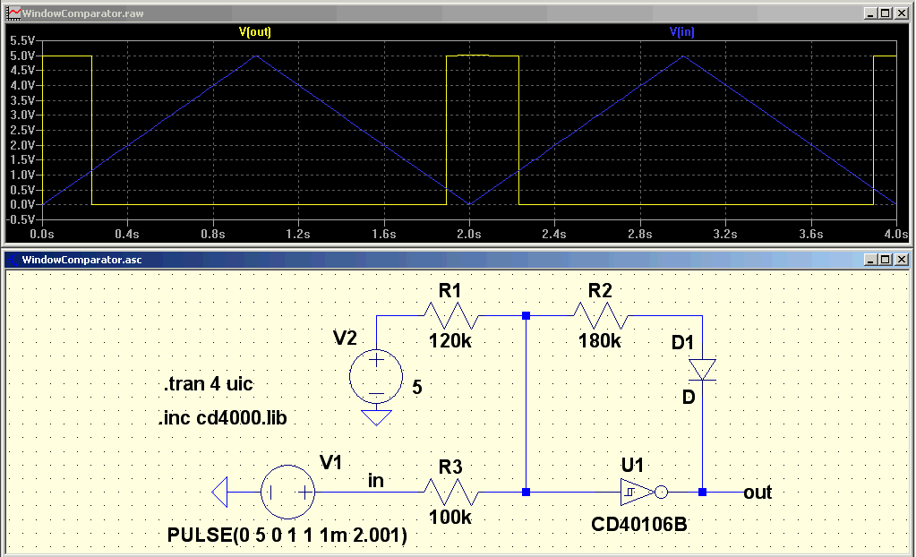

I'm guessing that the 10% and 20% values aren't too critical? If they aren't, then I think you could set those levels simply with a Schmitt trigger gate (e.g. CD4093 or CD40106) plus a few resistors etc (I'll run a simulation to check). The gate could then drive (possibly via a buffer stage) a power FET for switching the relay or pumps.

Looking at it more, I'm not sure how to implement it. Perhaps I didn't read your response closely enough. The 10% and @20% have to be controlled fairly closely. Is the hystoresis on the Schmitt trigger adjustable per requirements? It seems not, but perhaps I haven't read far enough.
Can I implement this chip in such a way that I can choose my 10% and 20% at will?

Here you go....
Although the Schmitt threshold voltages are fixed R1 and R2 can be adjusted (they could be trimmers) to control (within reason) respectively the overall upper and lower threshold points of the circuit.
These thresholds will vary very slightly with temperature. They will also vary with supply voltage, so a regulated supply should be used.

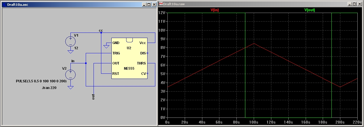

If you want to homebrew something, here is a germ of an idea:
Start with the ubiquitous 555 timer chip. Forget that it is a timer. Think of it as a Schmitt trigger circuit that has precise trip points of 1/3 of Vcc and 2/3 of Vcc.
If pin 2 and pin 6 are tied together and it is supplied with a well-regulated 12.00V power supply, it turns on (output goes high) when the input level is below 4.00V, and it turns off (output goes high) when the input level is above 8.00V.
Pity your tank level outputs are not 4V and 8V..., but we'll get to that...

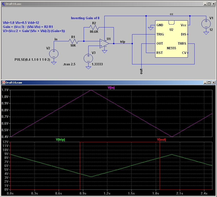

Well, if you insist on making the tank trip points 0.5V and 1.0V, then here is how...
Add an opamp which amplifies and level shifts the tank signal to match the trip points of the 555 I showed in the previous post. The Δ from 0.5V to 1.0V is 0.5V. The Δ from 4V to 8V is 4V, so the gain of the opamp must be 4/0.5 = 8. A gain of -8 will work but it will reverse the sense of the 555 output.
To get a gain of -8, R2 must be 8*R1. We also need to shift the input range so that the center of its input (0.5+1.0)/2 = 0.75V gets shifted to 6V (half way between the 555's trip points.
There is some magic offset voltage which if applied to the non-inverting input of the opamp would do that. I did some math to figure out that it had to be 1.333V. I put the formula for figuring it out into the schematic that follows.
To get the magic offset voltage of 1.333V, just put a 10K to 100K pot between Vcc (12V) and Gnd. Set the wiper to get 1.333V at the non-inverting input. It is just that easy.
The formula I derived is general enough to let you have different trip point (which changes the gain and the offset voltage).
PS: It occurs to me that the choice of 0.5 and 1.0V for the trip points was arbitrary. Can you choose resistors to make them 4V and 8V, respectively?

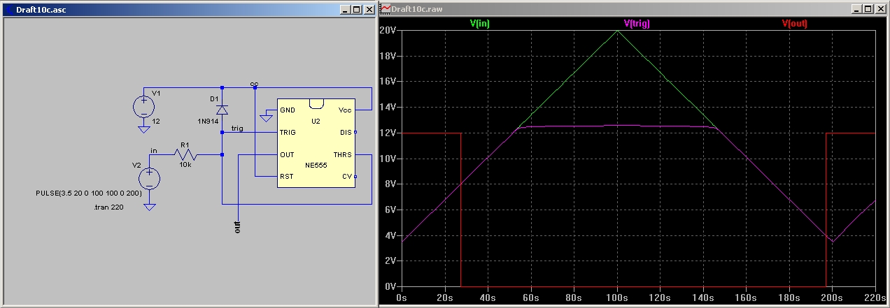

It seems like the perfect solution. The only thing I need to do is limit my voltage at the input so that when the tank reads > 30%, I don't damage the input (if that's possible?). If I need to I'm certain there is an easy means of of lmiting my input voltage.
BTW the same voltage I'm reading will need to be read by another PLC which is controlling the additon of liquid to the tank at he high levels. I'm assuming that using a high impedance at the input will prevent any problems "downstream" with the signal.
You can use a series resistor and diode to clamp the input if the input goes higher than 12V as shown:

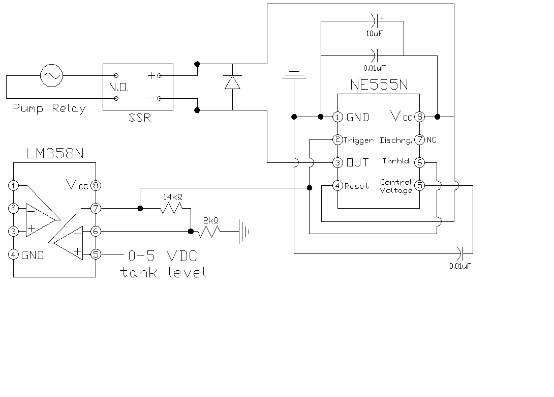

Is the attached drawing correct?

You can eliminate the diode across the SSR's input. SSR's do not need inductive flyback protection.

OK, so now I have some other question regarding how to integrate my circuit with my other electronics. As I mentioned I have a 24VDC available in the box. This 24VDC will be used to energize a number of sensors which are on other parts of the system. Here are a couple questions I have:
1. Since the current draw required for the chips and the SSR is minimal, can I assume that my circuitry won't adversely affect the readings from my other sensors which are being powered by the same supply? (SSR = Crydom D2410 (typical input current 3.4-20mA), 24VDC power supply = IDEC PS5R-SD24, rated 2.5A)
2. What is the most efficient way to step down the voltage of the 24VDC power supply, as the 555 would prefer not more than 16VDC. I was thinking a simple voltage divider, but maybe you guys know a preferred way.

The capacitors in your diagram look good.
Disc ceramics have low inductance, and do a good job of holding the Vcc to Vss voltage constant by locally supplying the current to rapidly switch the output pin of the 555 high or low. The ceramic capacitor takes care of the things that happen in ns to us.
The 10uF electrolytic stores much more charge and locally supplies current to hold the voltage constant until the upstream regulator takes over. It takes care of the things that happen in ms. Due to their construction, electrolytics are inductive, so do not work to bypass ns to us edges.
The diode on the SSR was pointed out earlier.
To get from 24V to 12V at a few tens of mA, I would use a LM7812 linear series regulator, or a TL431 shunt regulator. Even a Zener diode shunt regulator would be better than using a resistive voltage divider. Using the 555 as a Schmitt trigger with stable trip points is predicated on running it on a stable supply voltage, so you will need a regulator. Look at the recommended bypass caps to be used with the regulator(s), too.
