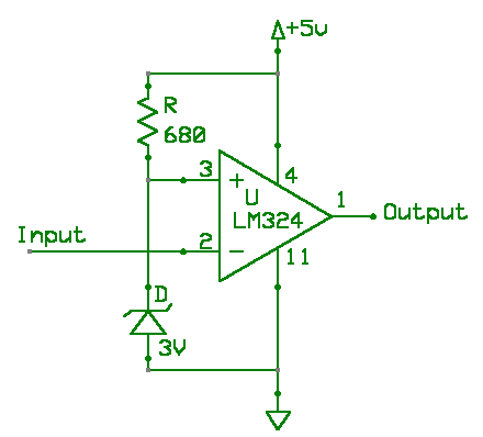

Hi I'm sort of new to electronics and would like help on something..
How would i use a comparator, so that if the input voltage is lower than say 3v for example, then it outputs high. If the input is higher than 3v then it outputs low.
Any help/websites/schematics is welcome and thankyou in advanced
